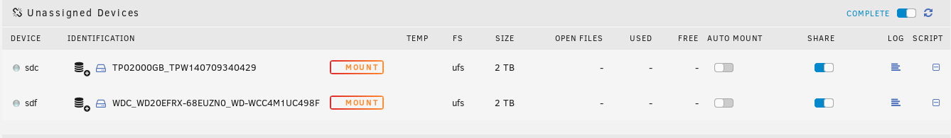

hi there,
i tried to mount a ufs device with this plugin, to copy my data into the array.
unfortunately it seems that my drives are unmountable?
Nothing happens after pressing the mount button
Is there any step which i may need to take before?
regards Tobias.

14 hours ago, Toobie said:
hi there,
regards Tobias.
grafik.thumb.png.c75121d6919893a4d571ba118363b2ad.pngimageproxy.php?img=&key=00b562fcac28e727
UD doesn't mount a ufs file system.
Damn.. ok.
I need to copy 2*2TB before linking into my array.

9 hours ago, Toobie said:
Damn.. ok.
Sent from my MI 6 using Tapatalk
You could mount it manually.

mount.ntf 28329                       root    4u      BLK              8,194 0x747013ffc00       8895 /dev/sdm2
EDIT#2: One more piece of info that may help narrow down the cause/solution. I had only tried deleting dupes from the Plex interface on the Movies-A drive. That drive is an 8TB that was shucked long ago and is attached via a SATA port in UnRAID, but still mounted via UD. I have 5 other drives (10TB) that are all still in their USB enclosures and to my surprise, they are read/write and the dupes located on them can be deleted. So it's only the one NTFS drive that is direct-SATA attached that isn't allowing the deletions through Plex or via SSH.
Movies-A has an unclean file system and is being mounted read only because of that.
Jun  1 15:49:46 AnimNAS ntfs-3g[28329]: Mounted /dev/sdm2 (Read-Only, label "Movies-A", NTFS 3.1)
Jun  1 15:49:46 AnimNAS ntfs-3g[28329]: Cmdline options: rw,noatime,nodiratime,nodev,nosuid,umask=000
Jun  1 15:49:46 AnimNAS ntfs-3g[28329]: Mount options: rw,nodiratime,nodev,nosuid,allow_other,nonempty,noatime,ro,default_permissions,fsname=/dev/sdm2,blkdev,blksize=4096
Jun  1 15:49:46 AnimNAS ntfs-3g[28329]: Global ownership and permissions enforced, configuration type 1
Jun  1 15:49:46 AnimNAS unassigned.devices: Mount error: The disk contains an unclean file system (0, 0). Metadata kept in Windows cache, refused to mount. Falling back to read-only mount because the NTFS partition is in an unsafe state. Please resume and shutdown Windows fully (no hibernation or fast restarting.)
You need to fix that before the file system will be mounted r/w.
