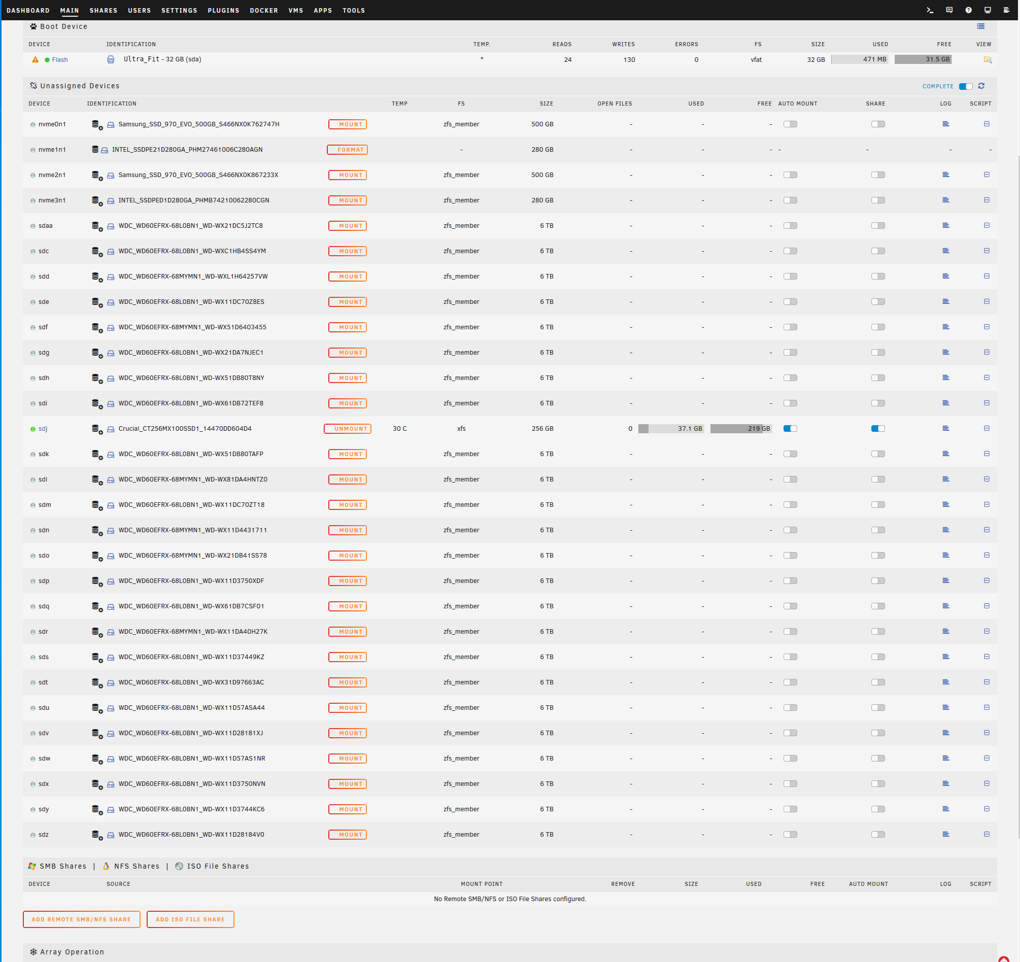

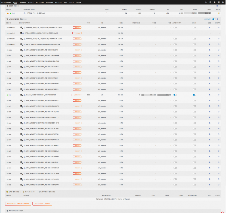

Is there a way to hide unassigend device(s) entries ?
right now it is confusing together with the ZFS Plugin ...
Not sure what you are asking.  You want all UD devices to not show?  Show a screen shot of what you are talking about.
Nope my Q. is if i cant hide some ... (witch are for example used for ZFS)
Edited by Dtrain
xorrection
6 minutes ago, Dtrain said:
This is what UD does.  There is no way to not show those devices.
