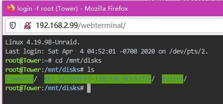

Yes, I did, but it doesn't seem to make any difference. I even reinstalled Unraid before, and it's the same. So I wonder if I need to config somewhere.
I also mounted a NFS foler, they were all mounted to paths like this:
/mnt/disks/192.168.x.x_{directory name}
/mnt/disks/{disk name}
Those are the correct mount points.  So what is the problem you are having?

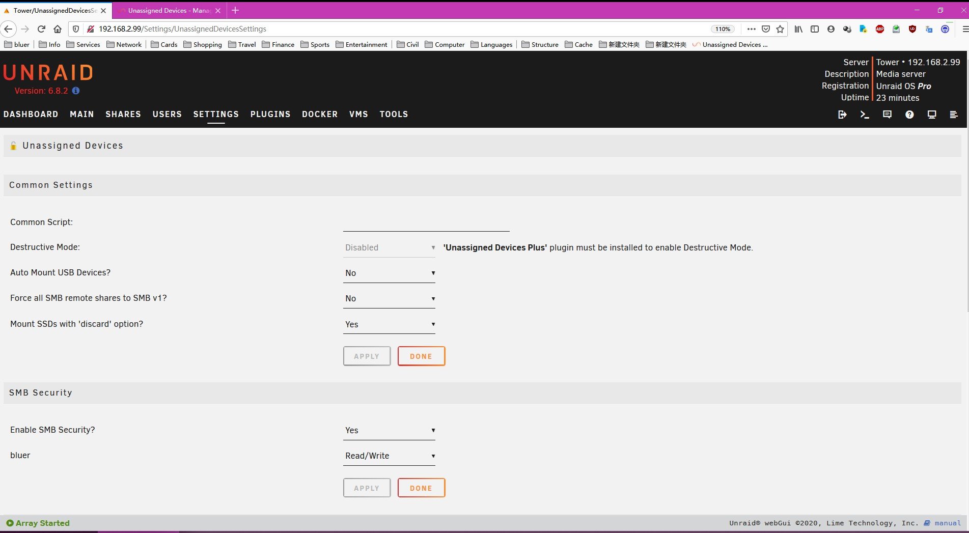

Go to the UD settings and enable SMB security and set the permissions you want for the users.  Turn on the 'Share' switch in UD for the device you want to share.  It might take two or three minutes to show at \\Tower\ because of the SMB refresh time of Unraid.

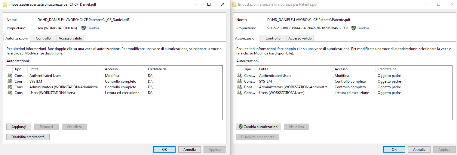

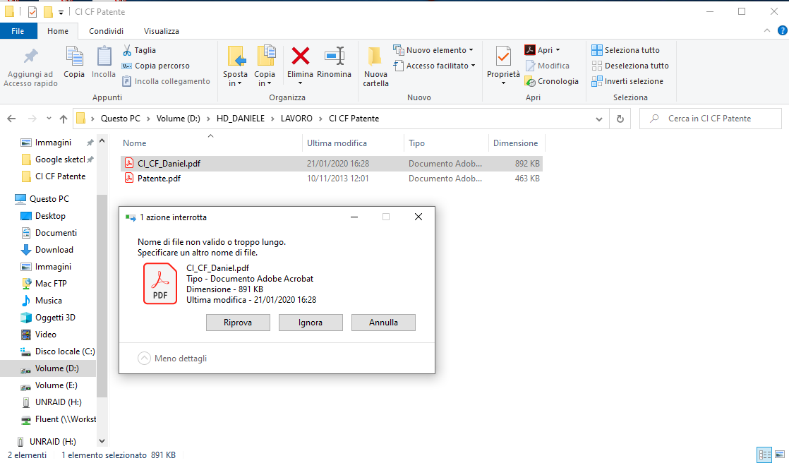

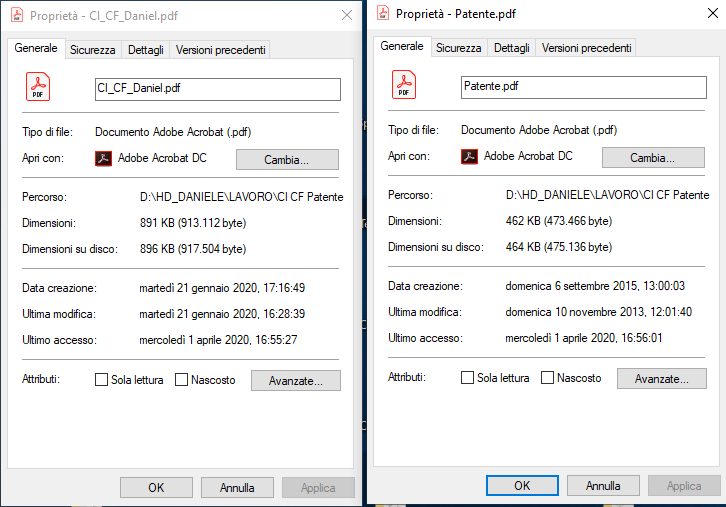

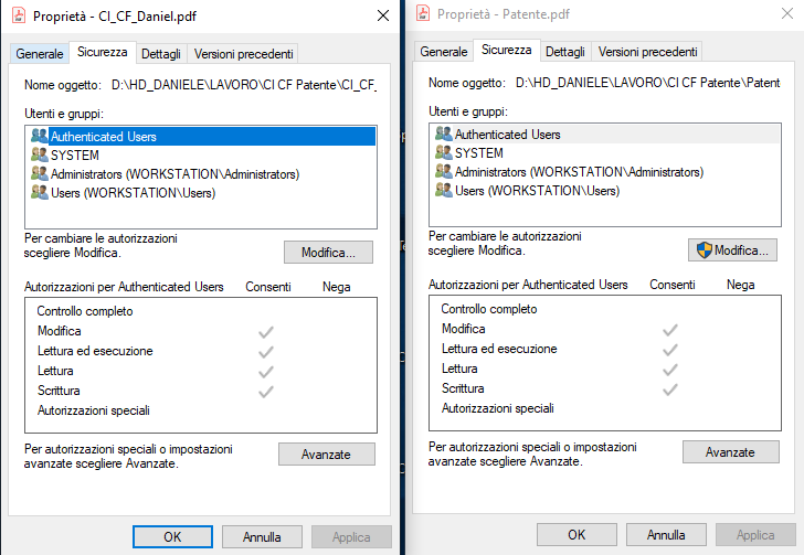

Hello all!
I have a strange issue I cannot solve by myself, after trying all that came into my mind..
Here is the setup:
Unraid 6.8.3
Unassigned device: latest version as of today (not related to the latest version, as you can see in the last attached picture the issue is also with a file dated January 2020)
The PC can boot Unraid or Windows 10 (latest version, latest patches as of today)
Unraid has a VM, Mac OS Catalina 10.15.4 (updated as of today)

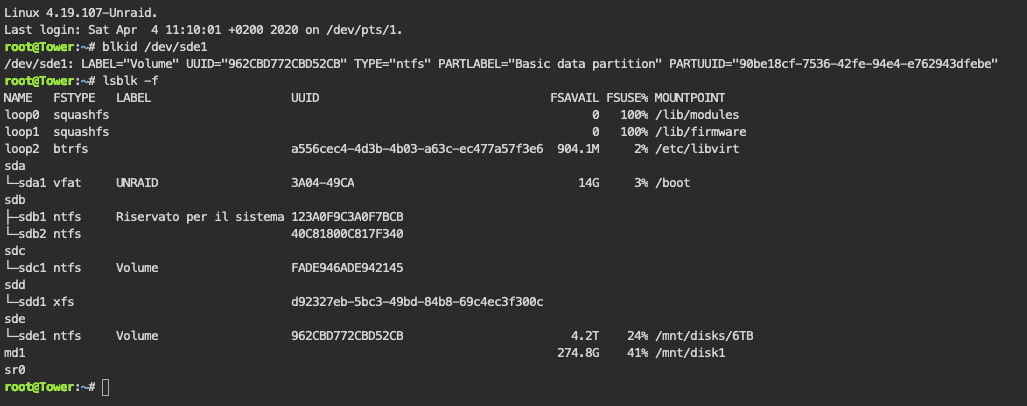

I use Unassigned devices to mount a disk (SATA connected) to be usuable inside the virtual machine (smb transfers).
The disk is sde, with the sde1 ntfs partition:
The issue:
From the virtual machine all is working good: I can transfer files to the disk, from the disk, rename, delete, etc
The problem is when I boot into Windows 10:
1- I cannot copy/cut files transferred with unassigned devices from that harddrive to main C:\ (including via cmd with elevated privileges), by drag and drop, copy/cut menus
2- I cannot copy/cut files transferred with unassigned devices from that harddrive to main C:\ by accessing the external harddrive over network (the drive is shared)
3- I can rename files
4- I can delete files
5- I can zip (archive) files
6- I can open files
So it seems I'm not able to "only" copy/cut files.
Here is an example:
The problematic HD is a western digital green.

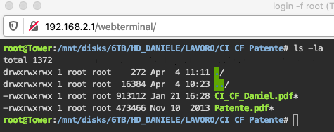

In this example I have a folder D:\HD_DANIELE\LAVORO\CI CF Patente\
Inside this folder there are 2 files: Patente.pdf and CI_CF_Daniel.pdf
Patente.pdf can be copied to main C:\, CI_CF_Daniel.pdf not.
When I try to copy CI_CF_Daniel.pdf I get this error:
Translated: filename not valid or too long, specify another filename.
What I tried:
1- run scandisk (chkdsk /r) to check for damaged sectors: all is ok, smart status is also ok
2- rename into windows 10 the file CI_CF_Daniel.pdf to Patente.pdf: however I can't copy/move
It seems a problem of permissions, but as far as I can see CI_CF_Daniel.pdf has proper permissions:
I'm really lost now, and I cannot understand what is causing the issue.
Any tip will be much much much appreciated ;)
Thanks

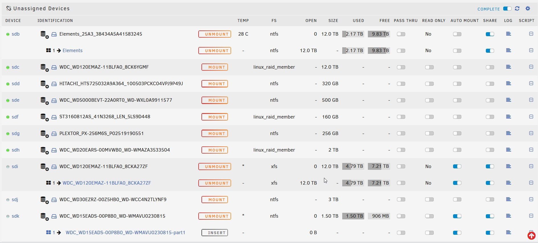

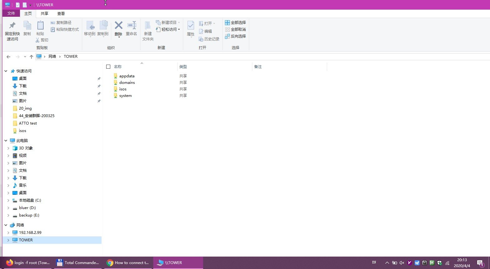

I did what you told me, and visit \\Tower use the username "bluer", but I still cannot see those mounted disks. Below are my setting:

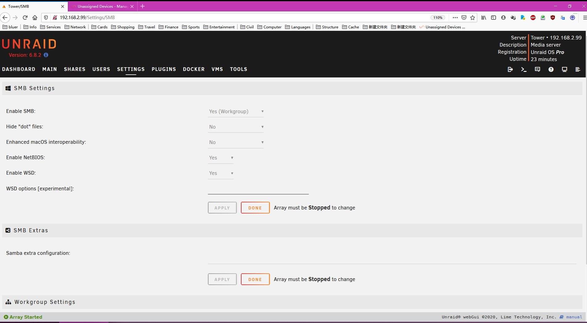

System Samba setting:
UD setting:
UD disks:
mounted disks:
samba share in Windows 10 (log in with username "bluer")
Thank you very much.

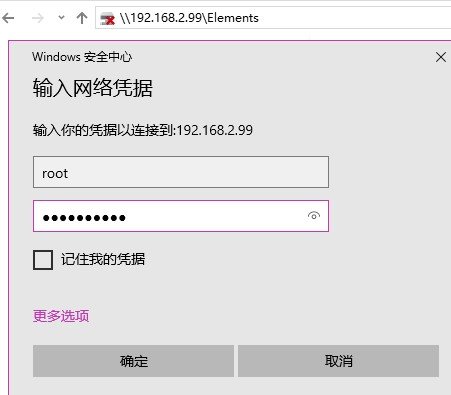

Try to access the share directly to see if it is a SMB share issue or a browsing issue:
\\Tower\ShareName
\\Tower\ShareName

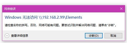

I visit the path \\Tower\ShareName, and a pop-up window prompts for username and passwords.
after that it reminds me that Windows cannot visit \\Tower\ShareName.
It's hard for me to follow when the screens are not in English.  Is the problem from invalid credentials or something else?  Translate the error dialog.
You might also try Windows troubleshooting and see if something comes out of that.
I suspect a Windows issue.  I don't have any problems with SMB sharing.

Please update to the latest version of UD.  Then do the following.
Your smb-extra.conf file is this:
#unassigned_devices_start
#unassigned_devices_end
include = /etc/samba/unassigned-shares/HEADLESS_media.conf
#vfs_recycle_start
#Recycle bin configuration
[global]
   syslog only = Yes
   log level = 0 vfs:0
#vfs_recycle_end
Please change to this:
#vfs_recycle_start
[global]
   syslog only = No
   log level = 0 vfs:0
#vfs_recycle_end
#Unassigned devices share includes
   include = /tmp/unassigned.devices/smb-settings.conf
#vfs_recycle_start
[global]
   syslog only = Yes
   log level = 0 vfs:0
#vfs_recycle_end
#vfs_recycle_start
[global]
   syslog only = No
   log level = 0 vfs:0
#vfs_recycle_end
That worked fine, thanks.
In fact, all of the SMB shares (from other systems) being utilized on the system with the eSATA share that needed rectified
now also appear in Windows - due to all inclusions (in smb-settings.conf) now being referenced.
Is there anything that I need to be aware of as to why the smb-extra.conf file didn't get updated?
