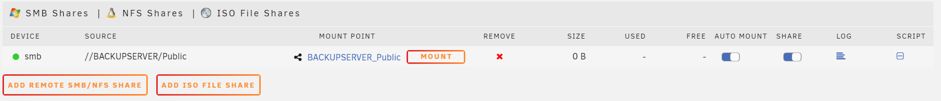

Hi guys. Getting this error in the logs
#root: error: /plugins/unassigned.devices/UnassignedDevices.php: wrong csrf_token
According to this post, the fix is to close out any browser on another network machine that may be connected, etc. I've only got one other machine that access the (headless) server on the network, and i have no open browser pages to it at all. multiple restarts, still no luck.
I ran netstat -vatn and the only addresses shown connecting to the server are the previously mentioned machine with no open browsers, and my VM. Logs attached, would appreciate any thoughts. Thanks
clements-tower-diagnostics-20200721-1234.zip
Any mobile devices connected?  Other browser tabs open?
definitely confirmed none. this server is only accessed from 2 machines, my imac on the local lan, and my imac at home (via vpn). both of which i've triple checked, no browser pages / tabs / access open at all.
Edit: I have another unraid tower at home connected with a 24/7 wireguard connection, that i use for remote backups with remote smb shares mounted. but it certainly doesn't have any browser pages open for this
Edited by Cpt. Chaz
cont'd troubleshooting
Update UD to the latest version.  It no longer uses the csrf token and you should no longer see the messages.

UD does a status poll about every second and that's where the log message comes from.  Somewhere you have a browser or phone app that has the UD page open.  That's the only way the log message can occur.  From the UD status polling.
14 minutes ago, Cpt. Chaz said:
Thanks for the input though, i'll look forward to the update!
I may have mis-spoken.  The update won't make the log message go away.  The csrf token check is built into Unraid and is behind the scenes.  It's just that I will remove the explicit reference to the csrf token in UD that is unused.
May have made a little progress. I unmounted all unassigned devices, still got the error. I tried disabling docker, still got the error. Disabled VMs, still got the error. I even unplugged the ethernet, still got the error. I use UD to mount remote shares via wireguard connection. So in a last ditch effort, it occurred to me to disable wireguard. Voila, the error went away. The second I turn wireguard back on and get a successfull handshake, the error comes back (even without any remote shares mounted). Now what? haha
Jul 22 12:37:27 Clements-Tower root: error: /plugins/unassigned.devices/UnassignedDevices.php: wrong csrf_token
Jul 22 12:37:29 Clements-Tower root: error: /plugins/unassigned.devices/UnassignedDevices.php: wrong csrf_token

There is a device on the other end of the wireguard with the ud page open.  It has nothing to do with mounts.  What is the remote device?
the remote device is just the headless backup unraid server (and my home nas). I have a Syncthing container running between the two (and this does not rely on wireguard) and i have a weekly backup script for VM's and appdata. Again, no open browser pages. i restarted the backup server, and it cleared that error. but now the main server is showing a new error to chase down.
Clements-Tower kernel: CIFS VFS: Close unmatched open
Unmount and re-mount your remote mounts.  Re-booting the remote server probably caused these issues.
