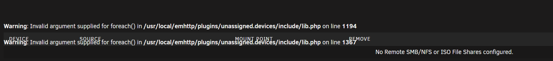

I just updated to the latest version and I am getting an error about an invalid argument passed to foreach loop
Full uninstall and reinstall fixed it
This error is back now. Worked fine after reinstalling but noticed today the same error is back.
Any ideas?
Edited by StuDaBaiker
Added both posts

Fatal error: Uncaught Error: Call to undefined function _() in /usr/local/emhttp/plugins/dynamix/include/Helpers.php:35 Stack trace: #0 /usr/local/emhttp/plugins/unassigned.devices/UnassignedDevices.php(85): my_scale(870.35904, NULL) #1 /usr/local/emhttp/plugins/unassigned.devices/UnassignedDevices.php(177): render_used_and_free_disk(Array, true) #2 /usr/local/emhttp/plugins/unassigned.devices/UnassignedDevices.php(262): render_partition(Array, Array, true) #3 {main} thrown in /usr/local/emhttp/plugins/dynamix/include/Helpers.php on line 35
DEVICEIDENTIFICATION
Post diagnostics.
