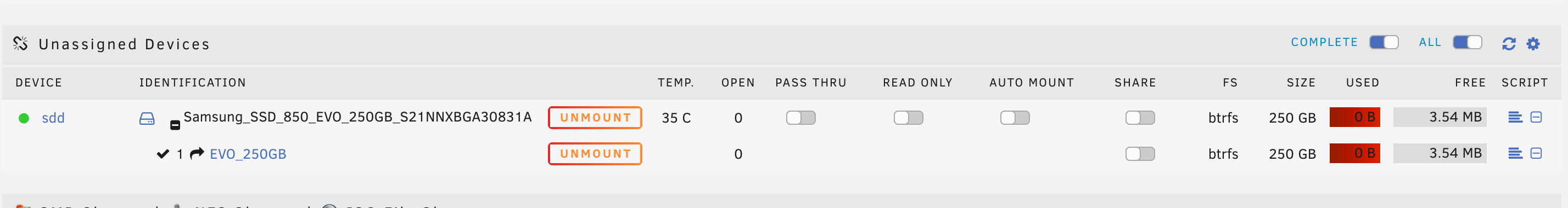

Could somebody help me figure out why my SSD keeps showing 0 B used and 3.54 MB Free when I format the drive with BTRFS or XFS?
diagnostics-20201003-2141.zip
This is remarkably similar to my issue, but with exFAT or FAT32.
@Danno93093 supplied me with the diagnostics I needed to find and resolve the issue.  This is why I ask for the diagnostics.  I found an extra space character from some disks information in the df command that was causing a parsing problem.
Problem fixed in the latest release.
Good to hear.

1 minute ago, boomam said:
Good to hear.
Can't verify my end, update fails right now, so I assume git issues.
Try again in a few minutes.  I had a file name issue.
Update now complete.
Issue persists for me still however.
Meh. Not a show stopper.

There is a delay in the update of the used and free.  Wait a few minutes and then refresh UD.
No effect. Just retested as i got in, about 2-3 hours after your post - same issue.
As said, i'm not worried, its not a show stopper.
However it doesn't look like the other poster has confirmed the fix either, so probably still an ongoing issue i'm guessing.
I was able to reproduce the other poster's issue and confirm a fix, so there is another issue that might be related to your setup.  You also said in your case it applied to all UD devices.  What I fixed was related to one device and the output from the df command.
A screen shot of your UD page would go a long way to helping find the issue, since you are relctant to post diagnostics.
