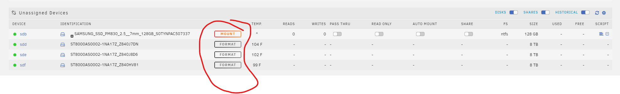

13 hours ago, dlandon said:
The log is the best place to start.  If you can't figure it out, post your diagnostics.
I didn't see anything in the logs that looked out of place, but I'm very new to this software.  My logs are attached :)server-diagnostics-20201213-1714.zip
I see one drive with errors over and over:

A disk called My Passport.  It's sdi and there is no sdi in your system.  I do not see the disk in the list of disks in your system.  It's acting like the disk was removed before it was unmounted, but I don't see anywhere that the disk was mounted.  That disk or the USB port has a problem.  You probably will need to reboot the server to clear this up.
Did you have this disk in some sort of a drive bay?

Yea that drive is unrelated to the issue I'm having though.  That was a spare 1TB USB drive that I briefly had attached to try to move some data, but the drive was faulty.  The drives I'm trying to mount for this issue are "sdd, sde, sdf" and they are each 8TB drives.

Normally I see a "Mount" button, but for these 3 drives, I only see a "Format" button.  I want to mount them in order to get the data off of them just like I have done with previous drives.

There doesn't appear to be a file system on those disks that Linux recognizes.

Yea nothing shows up in unraid for some reason, but when I boot into windows, those drives are just NTFS.

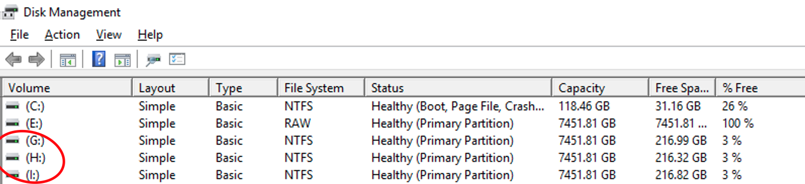

What type of NTFS? Simple basic? One partition per drive that covers the entire space?
Look in windows disk management and see, also try doing a disk check in windows, if the NTFS isn't perfectly healthy it probably won't mount in linux.
Here's a screenshot of the drives when I'm booted into windows.  It's the G, H, and I drives.  Each has one partition that covers the entire drive.

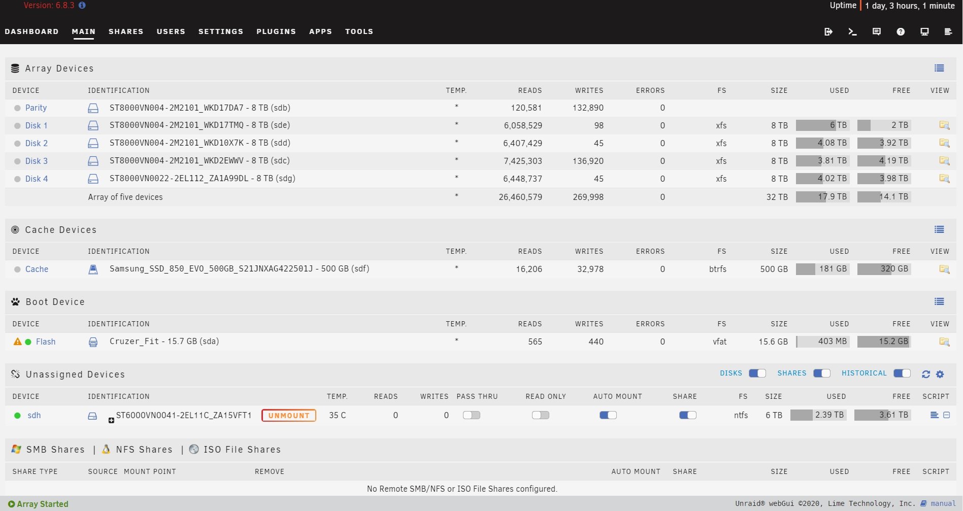

My "unassigned devices" hdd does not spin down automatically while the array devices spin down nicely (see attached image).
  • Cache Dir Plugin uses "include" folders as recommended.
  • Updated all plugins to the latest version.
  • All drives connected to the same HBA
you can spin down/up the array devices by clicking on the dot left to the disk#, could that functionality be added to the unassigned devices plugin where clicking on the icon does nothing. :)
This feature will be available in 6.9RC2.
This feature is available in 6.9RC1.

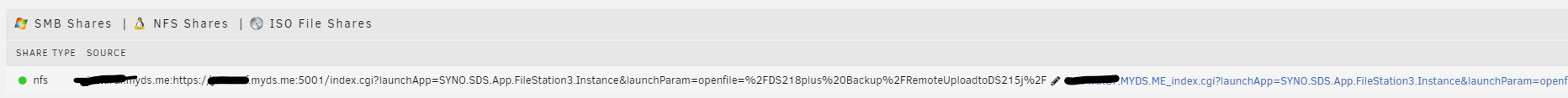

I tried to mount an remote Synology NAS through nfs or smb and totally messed up wrong slashes and so on.... 😒
After that failed try my plan was to delete the share and do it better once again.
The deletion of the smb went fine but I am unable to delete the nfs share.
I tried to delete it with the red X, disable Auto Mount and delete it again, nothing worked. The Success Popup showed up every time but nothing changed.
Is it possible to delete this share with the command prompt?
The screenshot shows the current undeletable status
Thanks

I don't know where that inappropriate name came from, but UD can't handle that.  I'd like to try to understand how this happened.  It looks like your remote server gave some html code.
Please post diagnostics first, then delete the /flash/config/plugins/unassigned.devices/samba_mount.cfg file and reboot.
This will remove all of your remote mounts.
