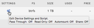

On 12/27/2020 at 11:38 PM, dlandon said:
"Where are the switches?"  The "Pass Through", "Read Only", "Automount", and "Share" switches have been moved to a new Edit Settings dialog.  This is also where the script is modified.  This saves some real estate on the UD page and keeps the page refresh smooth.
I dislike this, because in 1 of 100 cases the title tag of the settings icon does not appear:
This is not related to your code. Instead its a general issue for all title tags on all websites and valid for all browsers. Example ("Quote" is not displayed):
And as I used the buttons often, I now need to open settings on every entry. To fasten this process I open the settings links in multiple tabs, but finally its annoying.

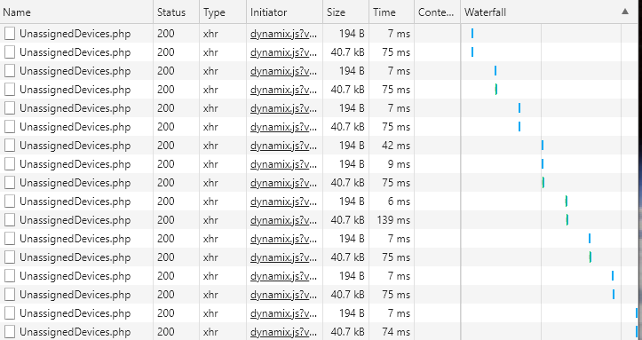

Maybe you even think about a "live update disable" or "live intervall in seconds" option. Its ok for me refreshing the page manually instead of loading the complete 40 kB HTML table every 3 seconds:
I mean this is 50 MByte/s per hour. Not funny while using a VPN through my mobile data plan.
Maybe its possible to load the complete table only on first request and update the cells like it is done for the rest of the page.
What is it you don't like?
Maybe you shouldn't be doing this on a mobile device, or get a better data plan.
Not worth the effort for very little gain.  The UD page refreshes the same way as the array disk pages.
The refresh is to keep the remote shares online status up to date, to refresh the GUI so it reflects the proper server online status for remote shares, and the disk status like preclearing and scripts running for physical disks.
I worked very hard to get the refresh working so the GUI would show the correct status of UD devices, and now it appears you are wanting to go back.  I'm really not too keen on doing that, even as an option.
The tool-tips all work fine with my browser/OS combination (macOS/Firefox). Move the mouse pointer over an icon and it changes to a hand with a pointing finger. After one second the tool-tip appears and stays there until I move the pointer away from the icon. This avoids the need to click the icon just to check the position of the switches.
Look at my screenshots. It's a random behaviour of each browser. And waiting is not intuitive and does not work for touch-only devices.
I don't expect different browsers to behave identically, so I was surprised to find that Firefox, Chrome, Brave and Safari (the four browsers I have installed) actually do behave identically in this respect. I think the slight delay before the tool-tip appears is to avoid the mess of flashing pop-ups that would otherwise appear while moving the mouse pointer around. I find it very easy: just hover the pointer over the gears icon for a second and the state of the switches is revealed. I can't speak for other operating systems (I'd be surprised if Windows was very different in this respect) or tablets/phones, which have a different user interface due to the lack of an on-screen pointer. Tool-tips work for me on this site, too. Here's an example to compare with yours:
You asked for it (as I said, random behaviour and not supported by touch):
