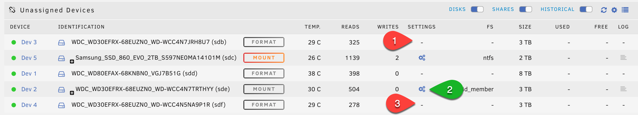

Hi, I'm just setting up my first array and VM's planning to migrate data from my old pre-Unraid disks. In this thread in another topic, I was advised to passthrough all three 3 TB drives in an Intel RST RAID 5 set, but as shown below, only one of the there (marked in green) has the gears while the other two drives in the set (marked in red) do not:
How do I pass them through?

Those drives without the icon aren't being intercepted by UD, so those can be passed through normally without changing any settings.
I was under the impression that "normally" as of the 6.9 UI is via the gears? The passthrough switches have gone away, including for the lines without gears, as you can see in the screenshot.
I wonder what's the difference between Dev 2 (with the gears) and Devs 3/4 (without), anyway?
Disks without a file system will not show the settings icon (three gears) as the settings there do not apply.
How do you pass those through to a VM, then?
(Would I have been unable to do the same thing to /dev/sde, if I hadn't clicked the settings and switched on passthrough on the disk that did have settings?)
I'm not sure why it thinks this disk and only this disk has a filesystem whose type is "isw_raid_member", when it's actually an NTFS filesystem striped across two other disks as well:
The UD pass through setting is more of a convenience than a requirement.  You can pass through a disk any time without the 'Pass Through' switch being on.  With it on though, UD will not allow mounting of the disk.  If UD mounts a passed through disk, the file system will be corrupted.
