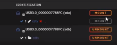

Hi there, I could not find the answer, sorry if duplicate.
I am using Orico 5-Bay external disk enclosure and all disks in this extender are meant to be UD devices (not pooled devices). This is a USB3 device.
It works fine as long as only a single bay is used with disk mounted. When I add the second drive, I cannot have a separate mount point and when I change partition name of any drive, all partitions on all drives within the enclosure receive the new partition name.
It appeared that this was due to duplicate UUID, so I tried to change it via UD settings but I received
Jul 13 06:10:37 pumbaa kernel: XFS (sdai1): Filesystem has duplicate UUID d97712e4-9e51-46b8-a133-f6ea96642d18 - can't mount
Jul 13 06:10:37 pumbaa unassigned.devices: Mount of '/dev/sdai1' failed: 'mount: /mnt/disks/cctv: wrong fs type, bad option, bad superblock on /dev/sdai1, missing codepage or helper program, or other error. '
Jul 13 06:10:37 pumbaa unassigned.devices: Partition 'cctv' cannot be mounted.
Jul 13 06:09:33 pumbaa unassigned.devices: Error: shell_exec(/usr/sbin/xfs_admin -U generate /dev/sdb1) took longer than 10s!
Jul 13 06:09:33 pumbaa unassigned.devices: Changing disk '/dev/sdb' UUID. Result: command timed out
I uninstalled and reinstalled UD. With any single drive, everything works ok but with a second drive everything gets goofy.
Thoughts?

It sounds as if that enclosure is not passing the drive Serial type information through to UnRaid.   Some USB enclosures do not play well with Unraid :(
How can I confirm? I can see the serial number and model numbers when I click on the disk link.
lsblk also shows them as different devs and diff partitions and even when both are mounted the partitions are mounted at /dev/sbd1 and the other is /dev/sdx1.
UD tracks individual disks by the disk serial number.  Each disk has to have a unique serial number.  Your drive enclosure is probably presenting the complete enclosure with one serial number for all the drives.  It doesn't matter that the drives have different sdX designations.  UD doesn't track devices by the sdX designation, because they can change at each reboot.
Thanks, I recorded a little 2m video so you could see what's happening.  I click on the dev to see the disk details and I am seeing the correct serial numbers. See images attached. Just trying to be 100% sure that the enclosure won't work before I go and exchange it because I had another version of this exact same brand and it's been working for years.
One last note, I did have one of the disks shared in the previous enclosure and I do have a docker that references the cctv mount point...wondering if there's something cached somewhere that is messing up UD.
The serial numbers for both drives are the same.  UD has to have unique serial numbers:
It doesn't matter that the sdX designations are different.
I see that the device is appearing multiple times but why is UD not capable of grabbing the disk metadata. When I click on the dev, you can see from my screenshots that the disk metadata is available. Not trying to be complicated just curious as to why if Unraid is able to see the Serial Numbers, UD cannot? Is there a way to fix this?
Thanks
Thanks
UD uses the /dev/disk/by-id/ folder to find disks.
Gotcha, thanks for that. I took a look and did notice a subtle difference between the two disks showing up. Perhaps some logic can be added to UD to enable more devices?
This is what shows up for the USB enclosure
root@pumbaa:/dev/disk/by-id# ls | grep USB
usb-External_USB3.0_0000007788FC-0:0@
usb-External_USB3.0_0000007788FC-0:0-part1@
usb-External_USB3.0_0000007788FC-0:1@
usb-External_USB3.0_0000007788FC-0:1-part1@
I'm not sure if there's any other way to identify the disks other than by-id but just thought I'd share what I found in case there's an opportunity here. For now, I suppose I will return this enclosure and try another one.
Thanks again for the assistance.

I have confirmed that the enclosure is unable to capture the device ID. The ORICO enclosures are not compatible with UD, they send through a single deviceID to UD
I replaced the enclosure with a Sabrent USB 3.2 4-Bay 3.5 and it works great. It's keeping the drives down at 85F degrees whereas the other enclosure wasn't compatible with UD and the drive temperature were around 110F consistently. So I'd highly recommend this little Sabrent enclosure if you need one for UD.
