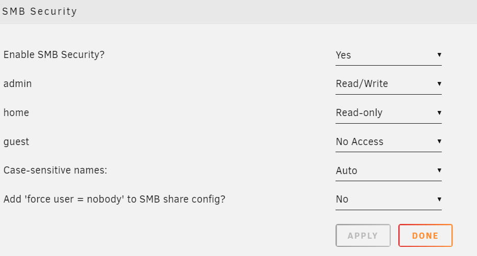

Guest Access for SMB Shares
I'm trying to access a smb shared with guest access, but it seems like this is not possible? If i try to leave empty the username and password field it still tries to use the credential file. This is the log:
Nov 22 13:43:58 HomeServer unassigned.devices: Mounting Remote SMB/NFS Share '//192.168.8.122/Public'...
Nov 22 13:43:58 HomeServer unassigned.devices: Mount SMB share '//192.168.8.122/Public' using SMB default protocol.
Nov 22 13:43:58 HomeServer unassigned.devices: Mount SMB command: /sbin/mount -t 'cifs' -o rw,noserverino,nounix,iocharset=utf8,file_mode=0777,dir_mode=0777,uid=99,gid=100,credentials='/tmp/unassigned.devices/credentials_Public' '//192.168.8.122/Public' '/mnt/remotes/192.168.8.122_Public'
Nov 22 13:43:58 HomeServer kernel: CIFS: Attempting to mount //192.168.8.122/Public
Nov 22 13:43:58 HomeServer kernel: CIFS: VFS: \\192.168.8.122 failed to connect to IPC (rc=-13)
Nov 22 13:43:58 HomeServer kernel: CIFS: VFS: cifs_mount failed w/return code = -13
with cifs normally i use the _guest_ parameter, for example:
guest,rw,noserverino,nounix,iocharset=utf8,file_mode=0777,dir_mode=0777,uid=99,gid=100
It's possible to add this feature? Or am i missing something?
The way it works is you set the permissions in the UD Settings:
for the access you want to grant to users.  Set guest to r/w, r/o, or no access.  This will then apply to all UD devices.
You still have to set the credentials when setting up the remote share so it will mount.  Then UD puts the appropriate entries in the SMB share config file for the access you have designated.
The SMB config file looks like this:
[XXXXXXXX_Work]
        path = /mnt/remotes/XXXXXXXX_Work
        browseable = yes
        valid users = admin, home, guest
        write list = admin, guest
        read list = home
        case sensitive = auto
        preserve case = yes
        short preserve case = yes
You'll see that the valid users are specified and the read and write users specified.  I set guest to r/w before I captured this file.
[XXXXXXXX_Work]
        browseable = yes
        read list = home
        preserve case = yes
The problem that i have is that i cannot add the remote samba share to unraid because i cannot specify guest access during the setup of the share, so the login fail (see the log i posted). The solution you posted is if i couldn't access the network share on unraid with guest access, but that is not my problem.
The Unraid mount requires credentials for the remote share in order to mount it.  The share access is then controlled with the UD SMB Settings.  UD does not mount devices with guest access on the cifs mount.  The reason this is done is to use Unraids user system to control access.
So i cannot mount the remote share through UD if it only accept guest access and no credential?
I think the problem is this line here: https://github.com/dlandon/unassigned.devices/blob/master/source/include/lib.php#L992, it should be added the "guest" parameter and remove che credential parameter if the user specify guest access.
Correct, you have to specify the credentials to mount the remote share.
It's not a problem or a bug.  UD was designed this way.  Access is controlled using the Unraid users.  It's not a change I will make.
