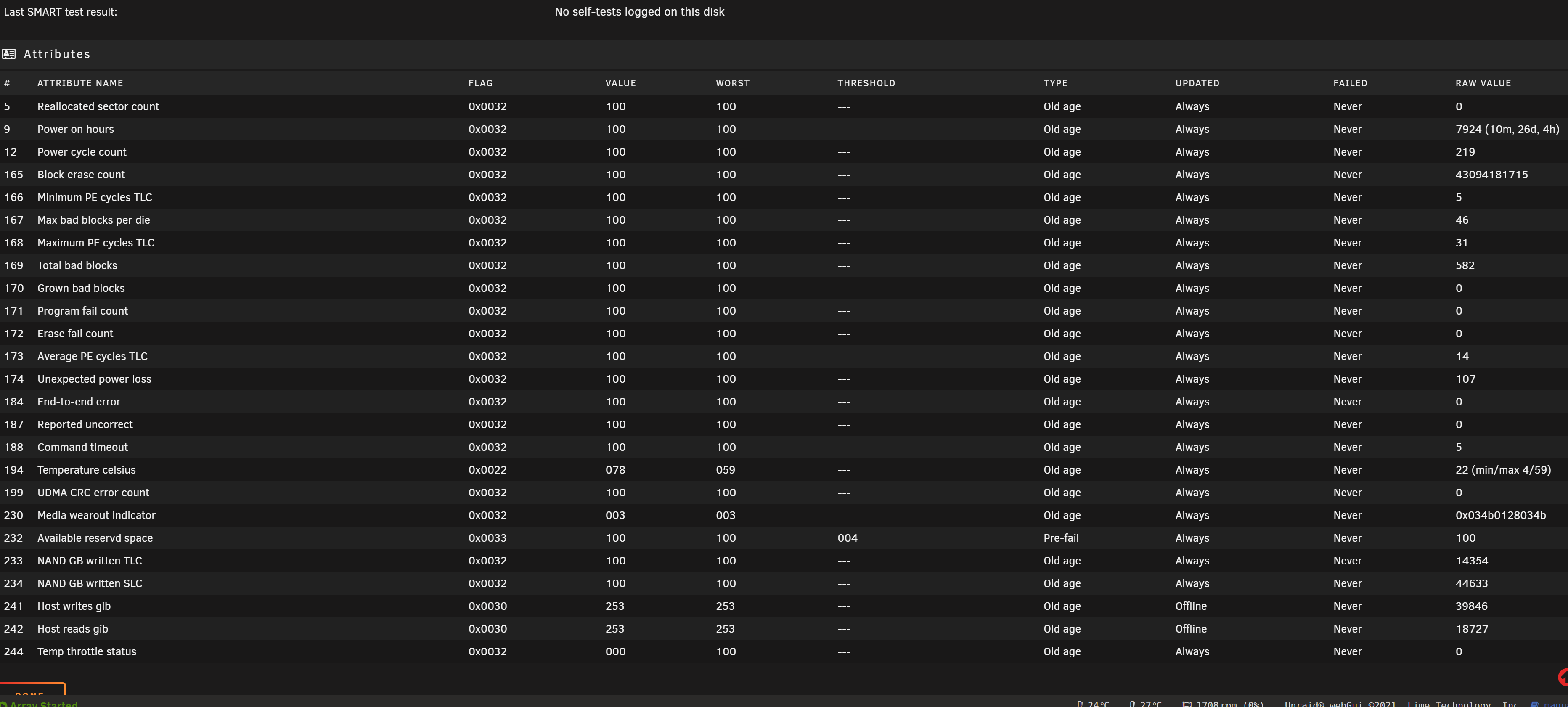

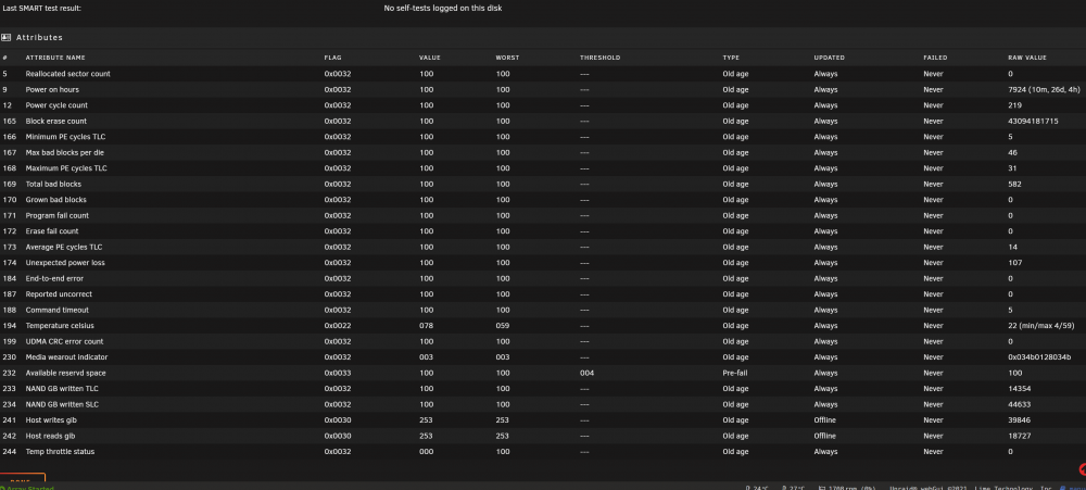

havent tried to your steps yet.. i did do a reboot of the server.... and  i dont have phyiscal access i access for my sister  so its a remote location...
but i did a reboot  no issues with the drive   smart shows no errors... and it mounted and syncing her data to the drive she gives me
can u see the smart info?  and so you shouldnt reboot a computer with the usb hard drive plugged in?
and ya its a usb ssd 1tb and a 500tb  she hot swaps to exchange in a external 2.5 extneral hd bay

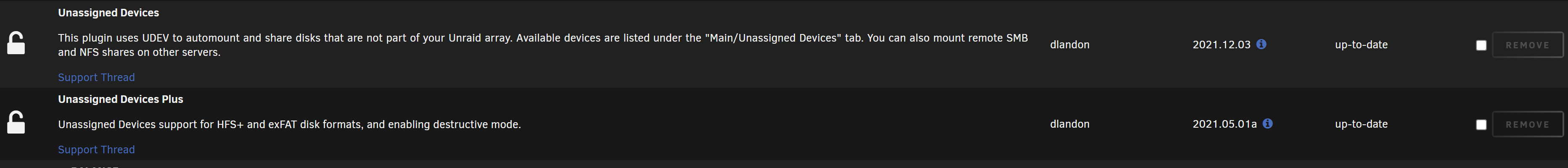

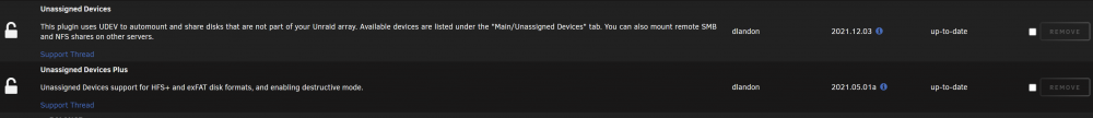

and i running 2021.05.01a version
mitchflix-diagnostics-20211204-1343.zip
Edited by comet424
Why?
why what  dlandon said run the latest  so i am
sorry for my disliexa  i read the wrong one
but i running latest

No,  I don't see it in the diagnostics.

@dlandon here is the smart info for the ssd

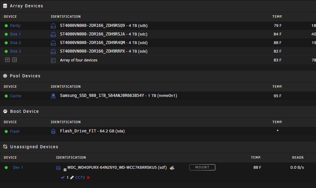

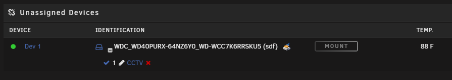

Hello! I'm having trouble mounting a disk in the UD plugin. It's a WD Purple 4TB hard drive, pulled from an NVR.
I have it connected via SATA on the ASROCK MB, and unraid sees it
I ran preclear on it twice, with no problems.
There is a partition (CCTV) that I am unable to remove. (trying results in a "FAIL" error message.
There is a MOUNT button present, but it is grayed out
Destructive mode IS ENABLED
I want to use this disk as a stand-alone, not attached to the array, but I can't format or mount it.
Any ideas what I can try? Thanks!

@dlandon I haven't tested with UD 2021.12.03, but with previous versions the disk is no longer visual under Unassigned Devices on the main page as soon as I start my VM. So not very easy to double mount the disk. This behaviour has been great so far! 🙂
How did that partition get created?  UD can't deal with the partition layout.  There are some manual ways to remove all partitions from the disk.  UD can't do that because it can only remove partitions, and not clear the complete disk because of the risk of removing partitions it shouldn't.  Maybe @JorgeB can offer some help.
That's not the normal behavior, so I don't know how that's happening for you.  The reason for the "Passed Through" setting on a UD disk is so UD will leave it alone and not offer the option to mount the disk, nor auto mount the disk.
@dlandon Ok, I have had it set up like this for quite a few years without any issues. I did follow a tutorial made by Spaceinvader One at the time of setting up that VM. I have tested with UD 2021.12.03 and it has the same lovely behaviour as it always have had; whilst the VM is up and running the disk is not visual under Unassigned Devices on the main page. as soon as the VM is no longer running then the disk is available under Unassigned Devices on the main page and one can operate on the disk using UD plugin as any other disk that is unassigned.
Prior to 2021.12.03 all was working very smooth and I did not experience any warning message like I do now. I know and I understand that a rollback is not an option. Would diffing the two versions give any guidance where  the current 2021.12.03 do things differently than its presessor narrowing it down to find the problematic part of the code responsible for the warning message?
