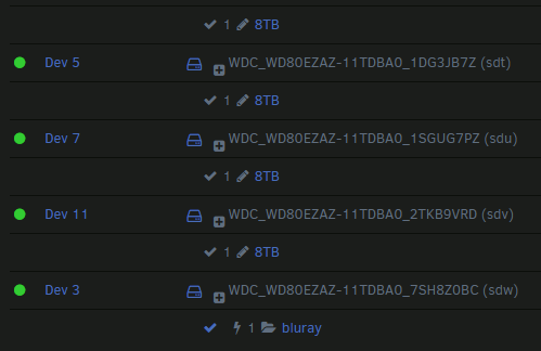

Work on multiple btrfs device volume can't mount ? ( due to mountpoint_name same as label, as result same mountpoint_name in multiple devices )
BTW, I got this problem and can't mount multiple device btrfs volume. I need manual change the mountpoint_name in "/boot/config/plugins/unassigned.devices/unassigned.devices.cfg" so that I can mount the volume.
I don't understand how the pool thing works.  I know there is a scheme to trick UD into doing this.  Can you give e a link to how pool the disks?
Both devices in the pool have the same mount point?  What mount point are you changing?  Why can't you change the mount point with the GUI?

It's been a while since I did that but no trick was needed, after a pool is created you just mount one of the devices with UD and the others would mount together, in the pool, not UD, with UD you just saw one device mounted, a btrfs pool can be mounted with any of the member devices.
Pool disks would have the same mount point?
As JorgeB say, just click "mount" on one of disk in that pool to mount multiple device btrfs pool.
When we change the mount point under UD, all member in that pool will change the mountpoint too.
So new version UD won't mount it as duplicate mount point in different disk. So I need change the mount-point in UD config file, then it can mount again.
For create multiple device pool, I use Unraid GUI, create the pool then un-assign it and let UD to handle. Thanks.
