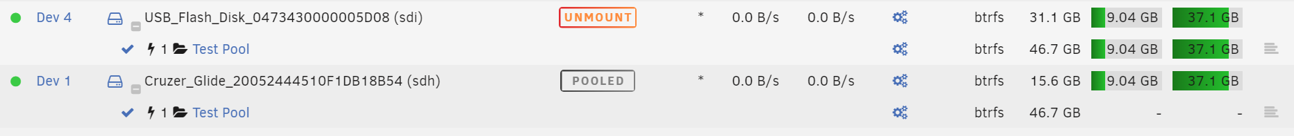

I put together a simple test of a UD Pool and made changes to the UI to handle disk pools a little better.  It also fixes the issue with checking for duplicate share names on pool disks without the setting to override the check.  Mounting two different disks that are not in a pool to the same mount point can cause loss of data and the duplicate check offers some protection against that.
I wanted to do this so UD at least handled disk pools better.  This allows those that have legacy pools to mount them with UD and work with them.  You should also be able to unassign a pool from the array and work with it in UD.
The array pool offers a lot of advantages over UD and you should really use that instead of UD for pools.
