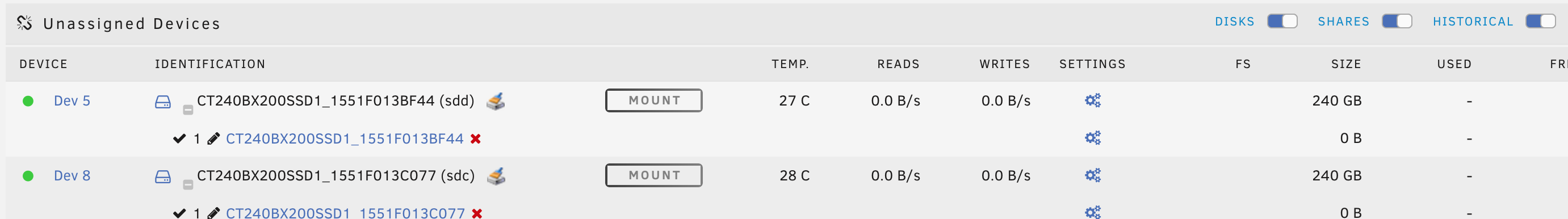

I have 2 18TB Seagate SAS3 HDDs installed in my LSI 9300-16i but they do not show up in unassigned devices while they do show up in Preclear and /dev in terminal as SCSI devices so I don't know how to format and mount them outside the array.
tower-diagnostics-20211219-1408.zip
Which disks?  Can you post a screen shot of UD?
That's the problem. They don't show up in the Unassigned Devices section of the Main page. I have 2 ST18000 18TB HDDs that do not show up.884063733_ScreenShot2021-12-20at6_51_29AM.thumb.png.0a59d88291f197533525039362af07f2.png

I cannot delete any partitions from disks in Unassigned devices. When I attempt to do so, the dialog box says "FAILED". I have toggled Destructive mode off/on with no change.
Post diagnostics.
It seems that I cannot delete partitions created by Preclear. If I use Preclear to erase all data and stop it I can then delete the partition and format the disk.
tower-diagnostics-20211221-1444.zip
UD tried to delete the partition, but it doesn't exist.

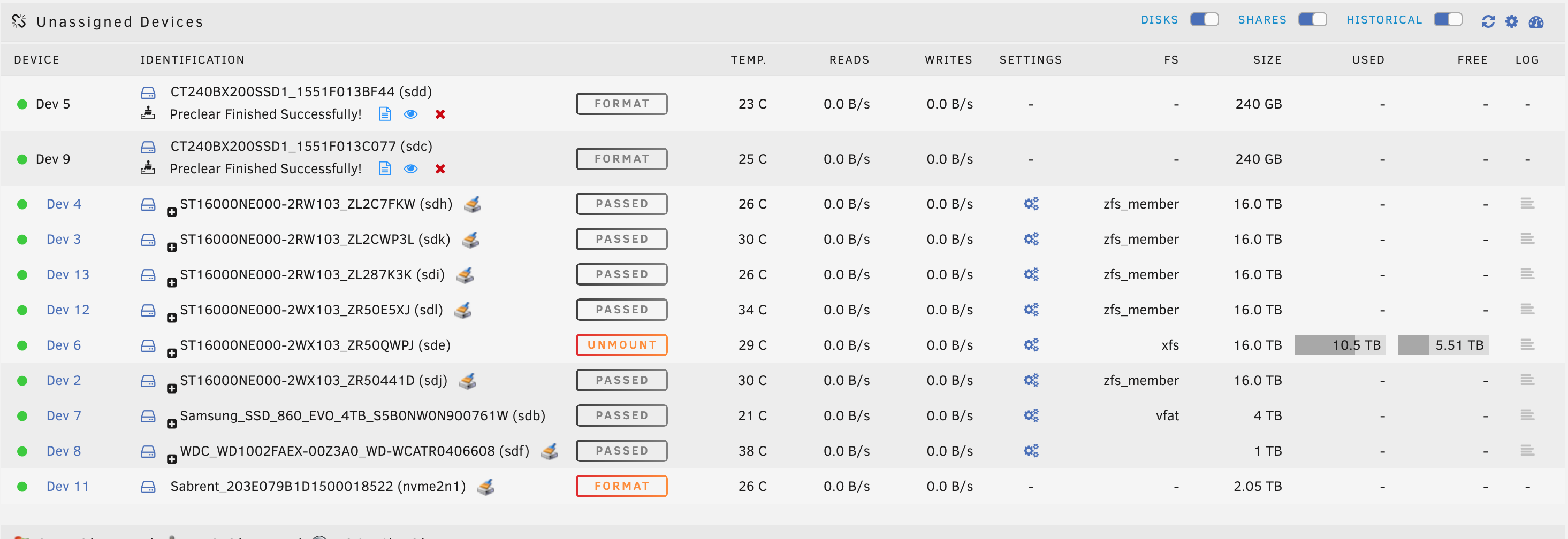

I added a red 'X' next to the serial number in release 12.13.2021 that does a wipefs on the whole disk and overcomes these kinds of issues.  It's pretty brute force and takes all the partition information off the disk.  Give that a try.
Where does this red X exist?  Is it on the Main page?  The only red x there is next to the partition that Preclear made. I have the 12/13/2021 version already.
It looks like this:
There may be an issue with preclear being installed.  I'll have a look.

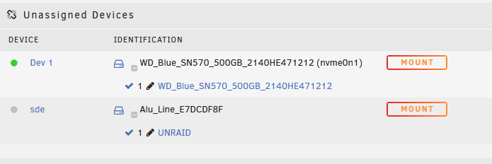

Hi all,
i've the following problem.
I would like to use a NVMe m2 SSD with UD.
During the array is offline, all is fine. I was able to format the SSD and my array settings looks good.
If i start my array unraid says "flash device error" and unraid couldn't find my license file.
UD show this:
The second one is my USB Stick with UNRAID.
Bringing the array offline takes very long, UNRAID says "Retry unmounting disk share(s)...".
Whats wrong here?
Thank you!

Your flash drive is disconnecting and then reconnecting.  When it reconnects, Linux assigns a new device designation thinking it is a new hot plugged drive.  The server then loses access to sda.
Do this:
  • Shut down your system.
  • Remove the flash drive and take it to a computer and try to repair the file system.
  • Put the flash back into the server in a different USB slot.  Try to use a USB2 slot.
