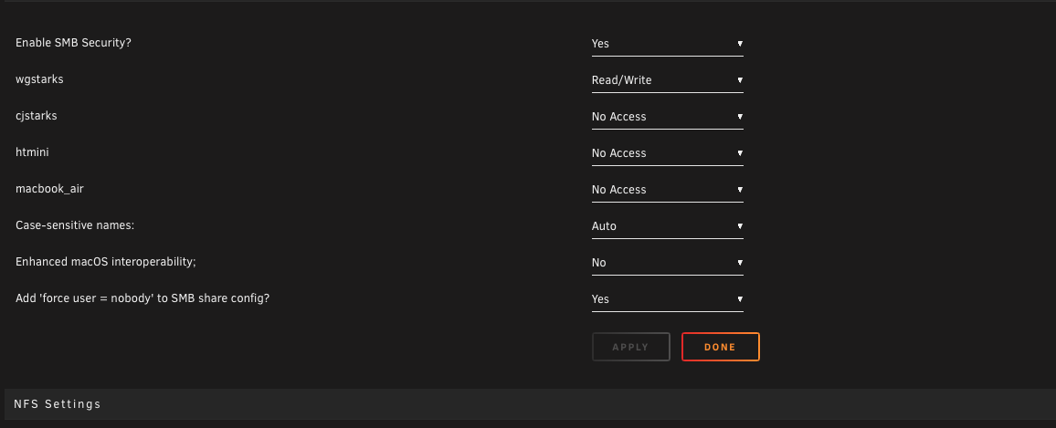

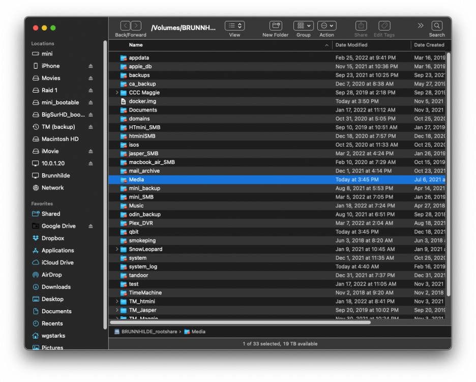

Seem to be permission errors with root share. Can't access any of the shares.

Already set-
1320529990_ScreenShot2022-03-12at3_57_26PM.thumb.png.d8c4a2b9db383a42777c382045d64e39.png
I'm not seeing it.  What is happening/not happening.  I don't understand the screen shot.
If I connect to the root share from my mac via smb I can't open ant of the unraid shares. I just get a message that I don't have access permissions.

Look at Mac OS Interoperability in UD and the Settings->SMB.

That fixed it. Pretty sure I had it turned on in UD settings prior to updating to RC3. I noticed a few of my settings were lost with the update. Guess I'll need to go through and check them all.
