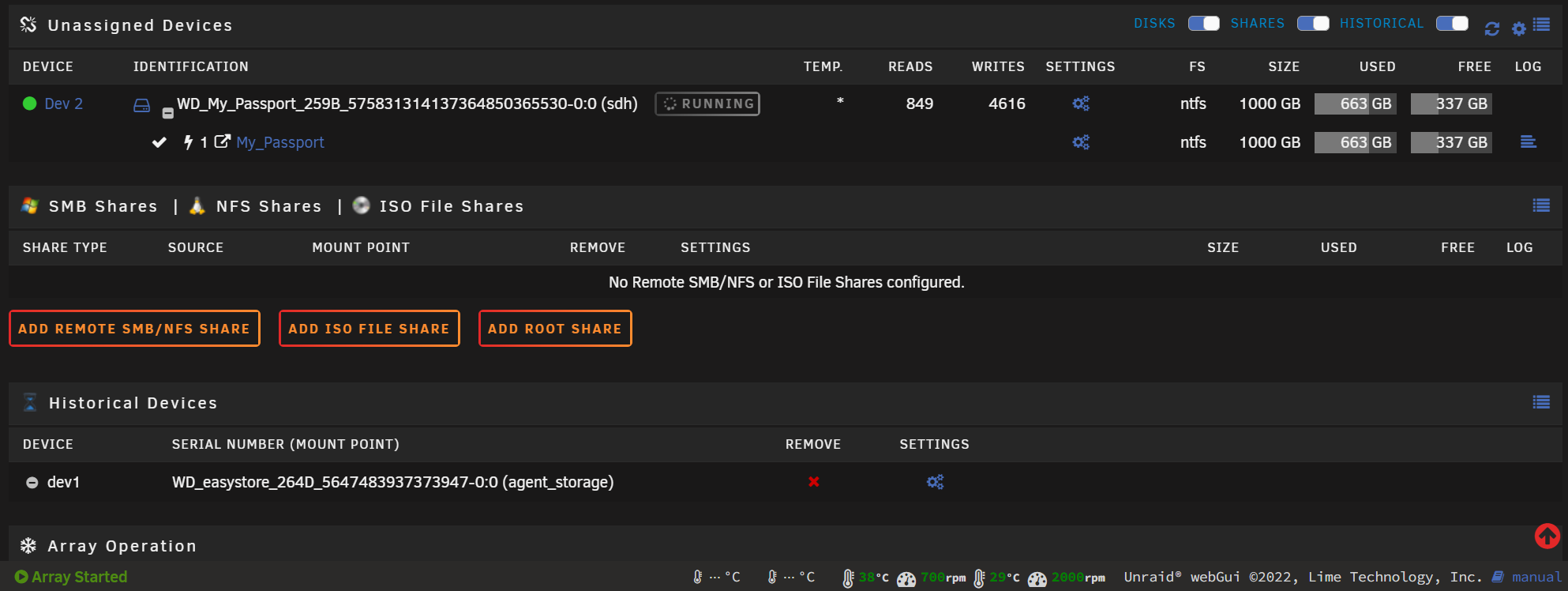

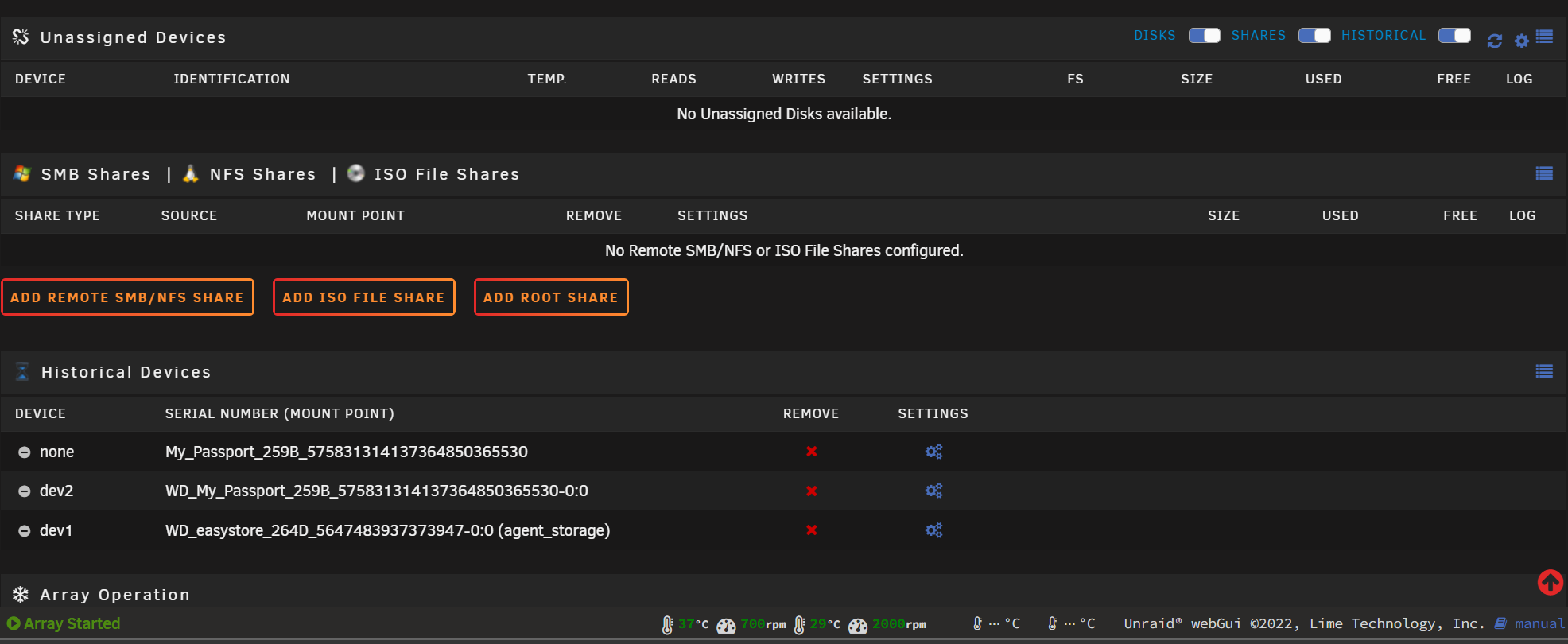

Hello, one of my Unassigned Drives shows up twice under Historical Devices when it's not mounted. When mounted it does not show up at all under Historical Devices. Should I click the red X next to one of these devices under HD? If so which one? Any idea why this happened?  This is a USB external drive that runs a script that backs up my Backup share. The script shows up under the settings for both of these devices.
Passport drive while mounted:
Passport drive when not mounted (showing in Historical Devices twice. 'Dev2' and 'none'.
Delete the one marked 'none' in Historical Devices.
