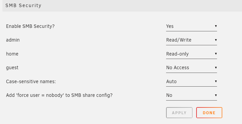

17 minutes ago, a12vman said:
Same issue here.
Visible internally to Sab/Sonarr/Krusader but no longer visible from Windows 10 clients on my network.
This happened within the last few days.
It looks like your UD Settings are not correct.  Go to UD Settings and re-apply the SMB Security settings:

3 minutes ago, a12vman said:
This how I have it setup, am I missing something?
It's these settings:

SMB Security, where is that located?
I don't think I have ever seen that option screen.
Edited by a12vman
Settings - Unassigned Devices
