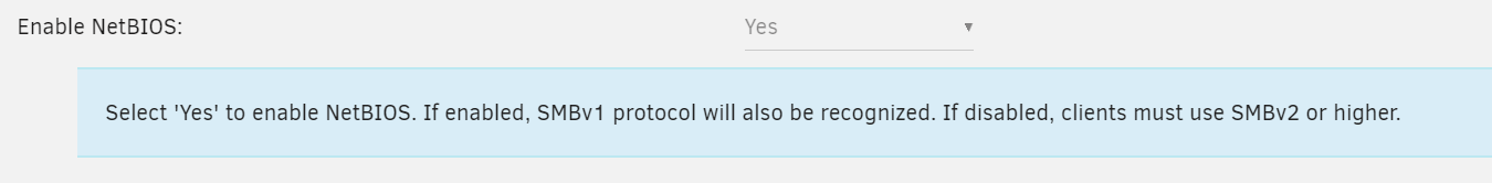

I have a share I need to mount using SMB v1.0.
I can see under Settings->Unassigned Devices that I can set the option to specify the SMB version to Yes, but I cannot see where I set the actual version.   Is this just me being blind :(  I have tested with a manual mount from the Command line to check that the mount works if I specify v1.0.
UD will mount the remote share with the highest protocol the remote server will support.  It does a sequence of mounts starting at 3.X, then 2.X, then 1.X until the remote share mounts.  Just try to mount the remote share with UD,  It should mount it.  You have to have NetBIOS enabled to mount with SMB v1.0.
The "Specify SMB Version when Mounting Remote Shares?" setting when set to "No" will tell UD to mount the device on the first try without specifying a version.  Newer servers will mount the share with the hghest protocol it can support.  Legacy servers do not mount this way and the version needs to be speficied.  The "Yes" setting tellls UD to specify the version when it sequences through mount attempts on the remote share.
Ok - I need to set NetBios support at the Unraid level?   This is not at all obvious from the UD message in the syslog, and it is still not obvious why I need to enable netBios locally (which I would rather not do) when it is only the remote system that is demanding SMB v1.0.    I was expecting to see it as something I could specify for a particular remote mount.
I just reviewed the UD code and see that I only mount a SMB v1.0 remote share when NetBIOS is enabled.  NetBIOS does not have to be enabled to mount a remote share with SMB v1.0.  It does have to be enabled for a remote server to mount a share with SMB v1.0.  The next release of UD will fix this.
It sounds like that will give the behaviour I was expecting.    Thanks.

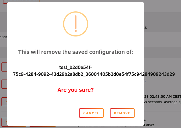

Having an issue with a couple of historical devices not removing. I made several changes to my server and had roughly 6 historical devices. 4 of which removed without issue. but 2 are acting as though they are removed successfully but they dont. Is there a command I can run to force remove them?
I am seeing the same issue after updating to the latest UD plugin.  I successfully removed a few historical devices yesterday, but today I am seeing the behavior described above.  After installing the 2023.03.30 update, UD reports the device has been successfully removed but it remains in the historical devices list.
