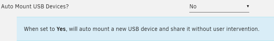

After I updated to UD 2023.04.15 I found it behaved differently in the following aspect:
I did not enable "share" for any of the unassigned devices or mounted SMB or NFS shares. So as expected, before the update, none of these were shared. After the update, the mounted SMB and NFS shares are all shared via SMB (haven't checked NFS).
Is this intentional? To me this is unexpected and I don't know how to turn this off, as "share" is already for all the mounted SMB and NFS shares.
I found that if I enable "share" and straight away disable "share", this will make the sharing go away again. So, fixable, but at least unexpected and I suspect - also unintended.
Edited by murkus
UD does not change any settings for sharing.  Verify that the "Auto Mount USB Devices?" is set to "No".
yes is is set to No. Remember, the Share setting got changed for the shares that were mounted from remote servers, not for USB devices. Hence, I do not see the connection of the question to the issue.
UD does not change that setting.
If you say so. You have been informed. Thats all I can do.
So I am able to reproduce the issue.  UD is not making any changes,  but now the default seems to be to share, which it is not supposed to do.  The default happens when a device is set up and the 'Share' switch is never changed.  None of the recent changes should have altered this, but apparently something changed.  I'll issue an update sometime today or tomorrow since this is a security issue.  It's a security issue because remote shares will be shared without user intervention, as you found out.
correct. the share switches were "off", still the sharing did happen. so this is consistent with what you found.
