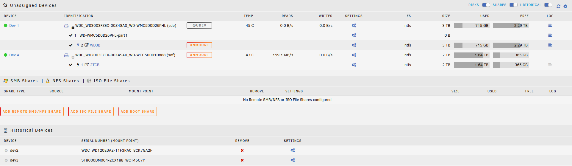

Post a screen shot of UD showing the disk with the issue.
Here's the screenshot
so I just noticed one of the partitions says its mounted, I think that changed when I plugged it in via usb but I can't see any files in it

Post the output of this comand:
lsblk -f
and
mount
Yes, the disk shows as being mounted, but the partition doesn't show a file system or the disk stats.

root@HTPC:~# lsblk -f
NAME        FSTYPE   FSVER LABEL  UUID                                 FSAVAIL FSUSE% MOUNTPOINTS
loop0       squashfs 4.0                                                 15.4G     1% /lib
loop1       squashfs 4.0                                                 15.4G     1% /usr
loop2       btrfs                 1172f222-4c0e-425f-ad4c-6412c5bc28ac   11.3G    41% /var/lib/docker/btrfs
                                                                                      /var/lib/docker
loop3       btrfs                 81e47654-4006-401c-a090-a5841a9c6fbd  904.4M     0% /etc/libvirt
sda
└─sda1      vfat     FAT32 UNRAID 272C-EBE2                              14.5G     3% /boot
sdb
└─sdb1      xfs                   f8881584-2766-4cc2-9523-bbc3d13ab694
sdc
└─sdc1      xfs                   69f07e3c-b74a-4897-8127-c197e8121a3f
sde
├─sde1
└─sde2      ntfs           WD3B   0A1800EF1800DB97
sdf
└─sdf1      ntfs           2TCB   6EC0BC9AC0BC6A4B                      437.9G    76% /mnt/disks/2TCB
md1p1                                                                     3.5T    62% /mnt/disk1
md2p1                                                                     1.8T     1% /mnt/disk2
nvme0n1
└─nvme0n1p1 btrfs                 58cc5c6e-f26a-47cb-ba53-4d69d3e76ee1    1.8T     1% /mnt/cache
root@HTPC:~# mount

/dev/sdf1 on /mnt/disks/2TCB type fuseblk (rw,nosuid,nodev,relatime,user_id=0,group_id=0,default_permissions,allow_other,blksize=4096)

Yes, a Root Share.

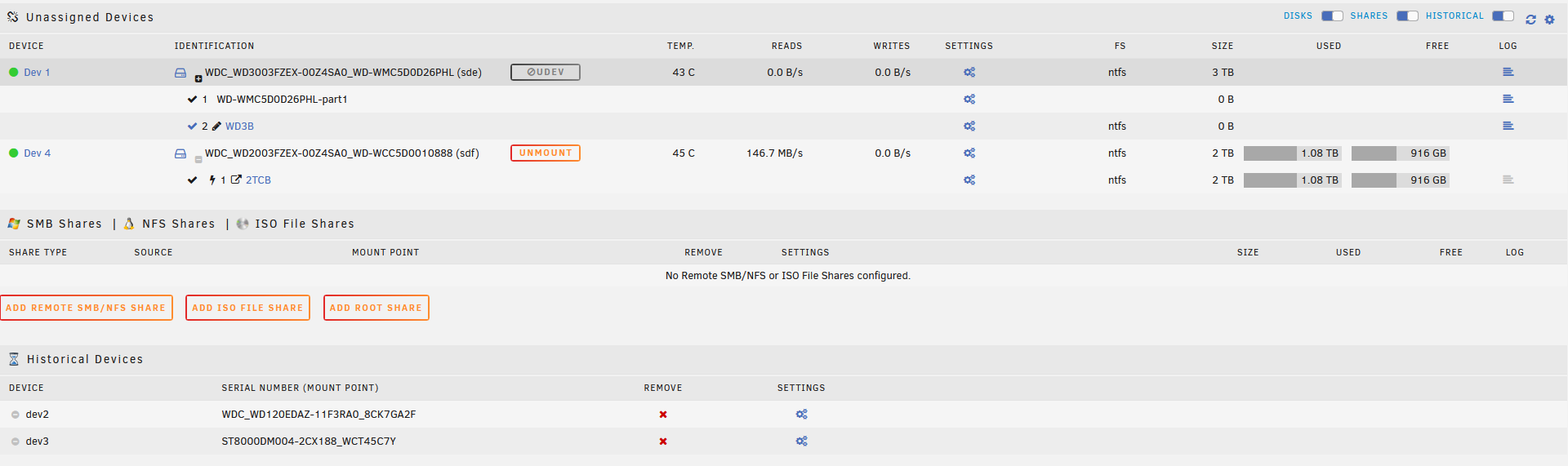

For now, use the 'Unmount' button on the second partition to unmount the disk.
OK I clicked the unmount button and it disappeared, this is how it now looks:
Yes, that's expected.  You can mount it again by setting the 'Automount' switch on, detach the disk, then reattach the disk.  It will auto mount.  The 'Udev' marker is only on the mount button and doesn't affect auto mount.  I'll have it fixed in the next release of UD.  Because of some users whinning about too many updates, I'll hold off until it becomes a necessity to update.  Right now you have a work around.
Awesome, that worked. Thanks for the help.
