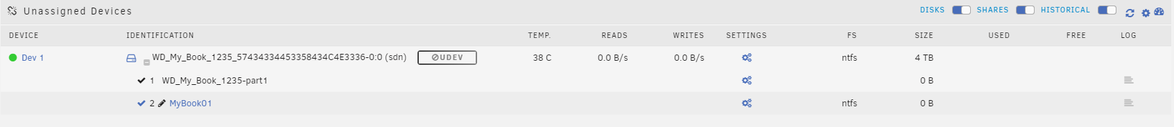

Hello. I hope this is the right place to ask for some help. I have all three unassigned devices plugins installed and here are the versions:
I am trying to copy data from an 4TB external HDD which is connected via USB to the motherboard. It appears like this in unRAID:
The guides I watch seem to have a mount button for the devices they want to access in the disks folder. I'm not sure why that is not the case for this, it is formatted NTFS.
Thanks!
Update - I was able to get this drive to show up in a Windows 11 VM. This is not ideal but works as a workaround. The drive moved to historical devices when that happened. I will need to look up what that means:
Update 2 - The drive has mounted itself now that the VM is shut down. This is odd but desirable.

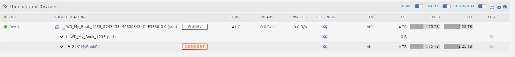

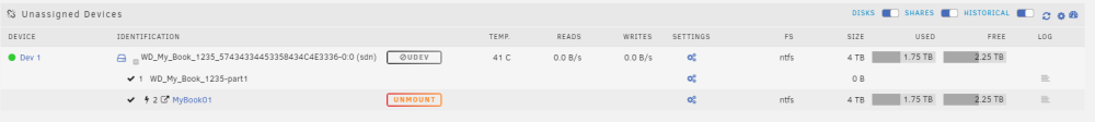

There is a bug in UD that shows the 'Udev' indicator when there is a partition with no file system.  It will be fixed in the next release of UD.
You probably have the "auto Mount' switch set so the disk will auto mount.
A work around for this situation is to set the "Auto Mount" switch on, detach the disk, then re-attach the disk.  The disk will be mounted.  Unmount it by clicking on the second partition 'Unmount' button.
Thanks for the workaround! When you say detach do you mean unplug the USB and plug it back in or is there a way to detach from the UI? My other disks shouldn't have empty partitions as I formatted them myself before using them for Media but I have one more WD external to migrate. I guess I could always detach it by connecting it to my Window's VM and then re-attach so auto mount works by shutting the VM down (like what happened with this first drive).
Click on the device settings for the disk (three gears icon) when the device is not mounted and you'll see a 'Detach' button.  Click on the same icon for that device in the historical devices and you'll see an 'Attach' button.
