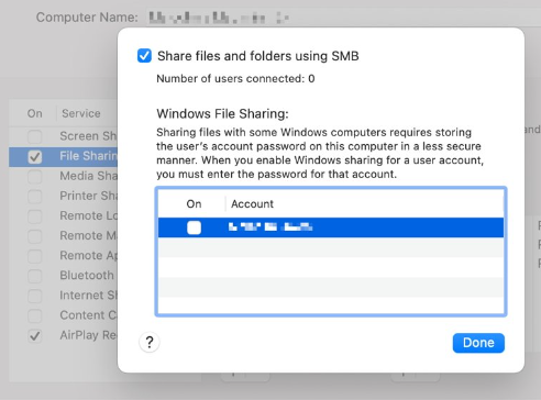

17 hours ago, kowe said:
I think is a permission setting or something like that, I was using the same credentials and configuration on the Mac, the only difference is a clean install of Sonoma.
You have that checked for the user(s), right?
Yes, I activare the sharing file and activate this feature, until Sonoma or the new unraid update all works well.
Thank you for help me.

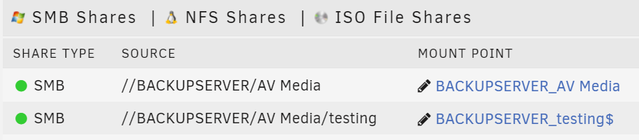

Hi All,
is there a way to mount a SMB share via console ?
My NAS is off while backup is not running but turns on via WOL before backup runs.
The SMB share is mounted via unassigned devices.
I want to mount the share via a user script when it comes online again.
/usr/local/sbin/rc.unassigned mount name=NAS
is not working

You are using the wrong command parameters.  For the 'AV Media' share shown here:
The command would be:
/usr/local/sbin/rc.unassigned mount '//BACKUPSERVER/AV Media'
Be sure to quote a share with spaces in the share name.
The 'name=' is used when mounting a disk by alias name.

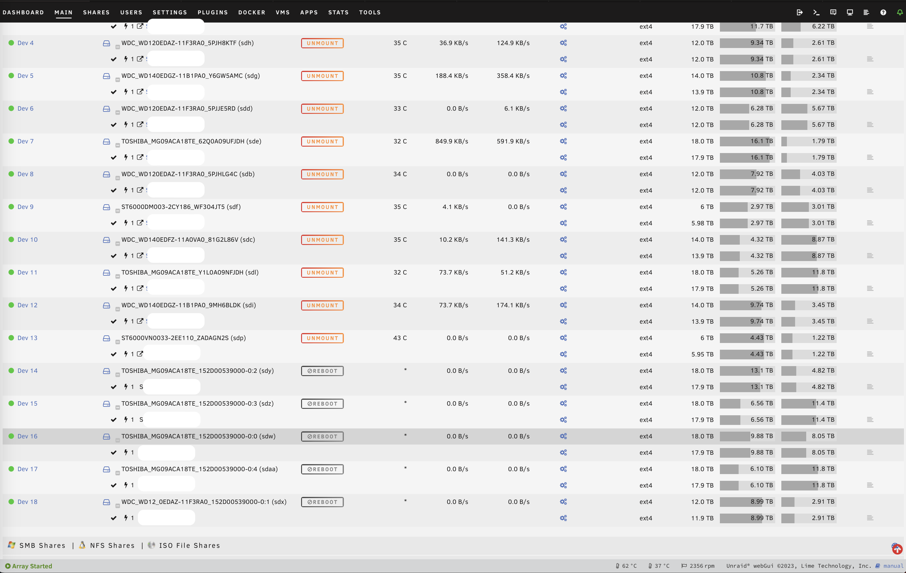

Hi, since yesterday I have issues with my drives that are connected via USB. Every few hours they become unavailable suddenly and only a reboot brings them back. After the reboot, everything is normal and works fine for a few hours. Does anyone have the same issue or an idea what could cause this?
All SATA-connected drives are working fine, it's only the 5 drives that are based in a FANTEC USB enclosure. After the issue appeared for 3 times in a row, I switched the USB enclosure to another one from ICYBOX because I thought the Enclosure causes the issue, but after a few hours I had the same "Reboot" button in Unraid and the drives were inaccessible.
I updated to plugin version 2023.10.08 before this started.
Edited by median-symposium6528
added description details
The 'Reboot' on the mount button shows up when the drive is mounted and then goes offline before it is unmounted.  As you found out, the soluton is to reboot the server to sort it out - hence the 'Reboot' on the mount button.
It appears all the drives with the 'Reboot' issue are in the same drive bay, so it's probably a common issue.  Check the log and see if there is any indication of what is going on.
Check the following:
  • Power supply for the drive bay.
  • USB cable.
  • USB port - change ports.
