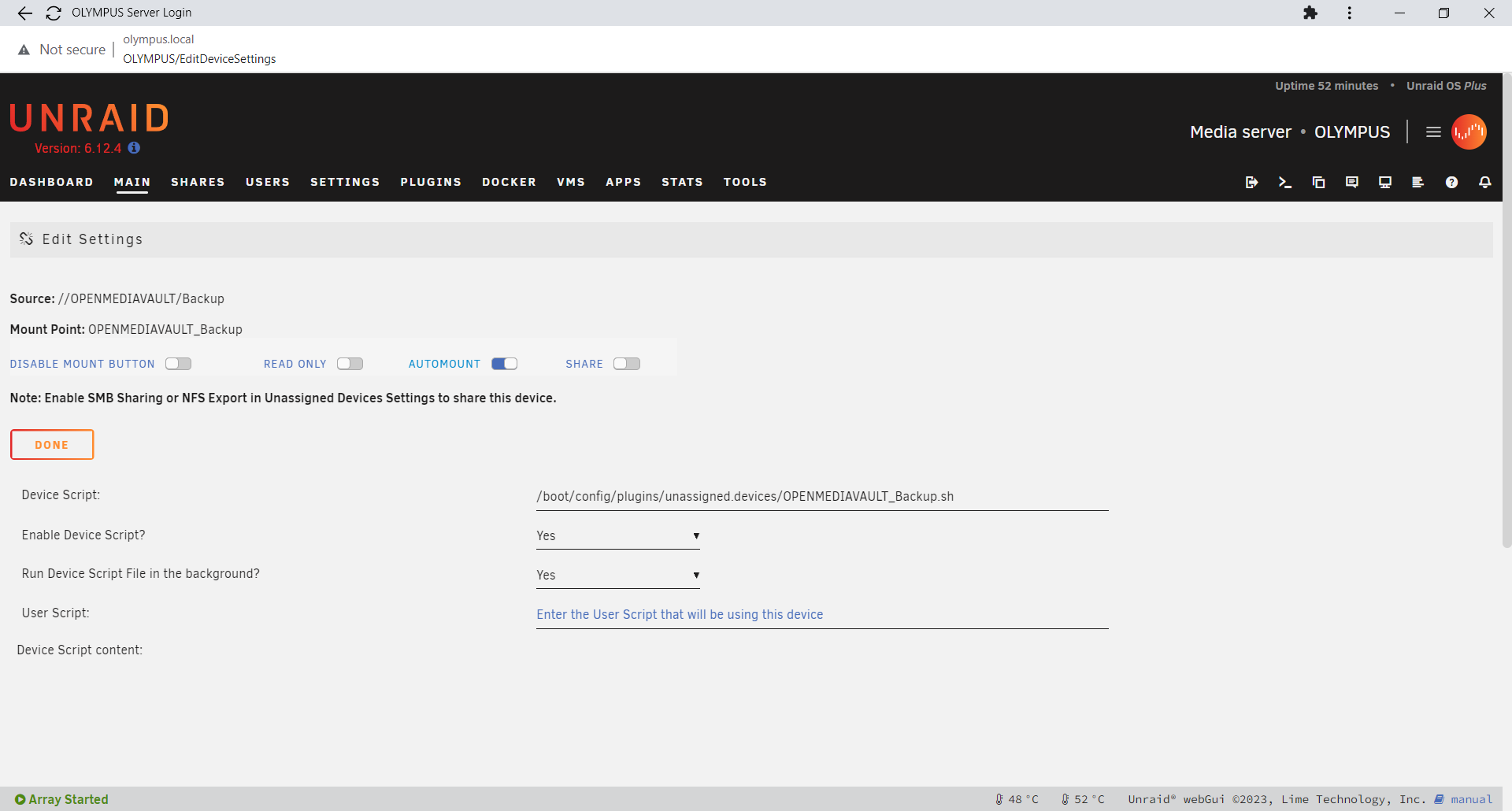

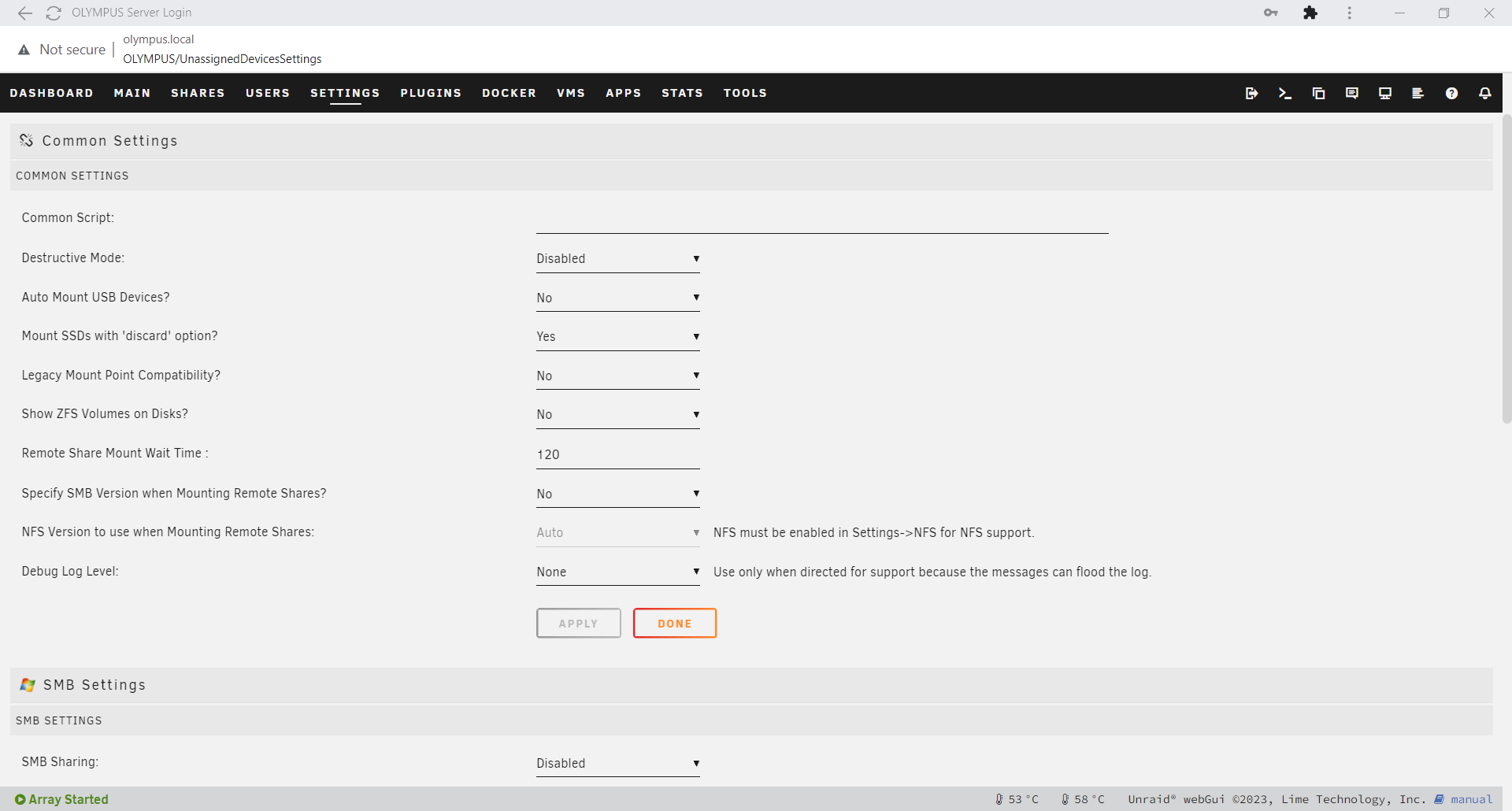

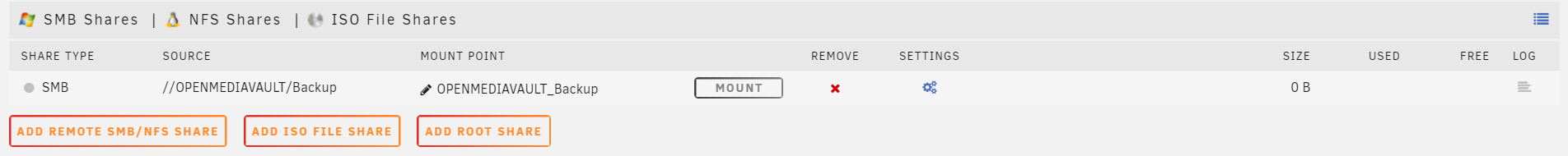

I am having an issue with remote sharing.
I have a share setup to auto mount to my backup shared folder on another server. But everytime I reboot my unRaid server, it won't auto connect and says that remote server is unavailable. Even though it says that, the remote server is always on and you can always access the shared folder from other computers. Also the mount button is greyed out.
I have changed the remote share timer delay to 2 minutes thinking it was a slow connect thing, but it is still happening.
I have attached a screenshot of what it shows on the main tab, the settings for the specific mounting, and also settings for the plugin.
I hope someone can help me out with this. It happens to all shares I setup, even when I try to connect to shares on other servers/computers.
UD thinks the remote server is offline - that's why the 'Mount' button is grayed out.  Post diagnostics so I can try to find out why.

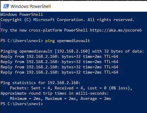

When I ping OPENMEDIAVAULT (Server's hostname), it says Name or Service not known.
However, I can ping the server by host name on all my other computers.
