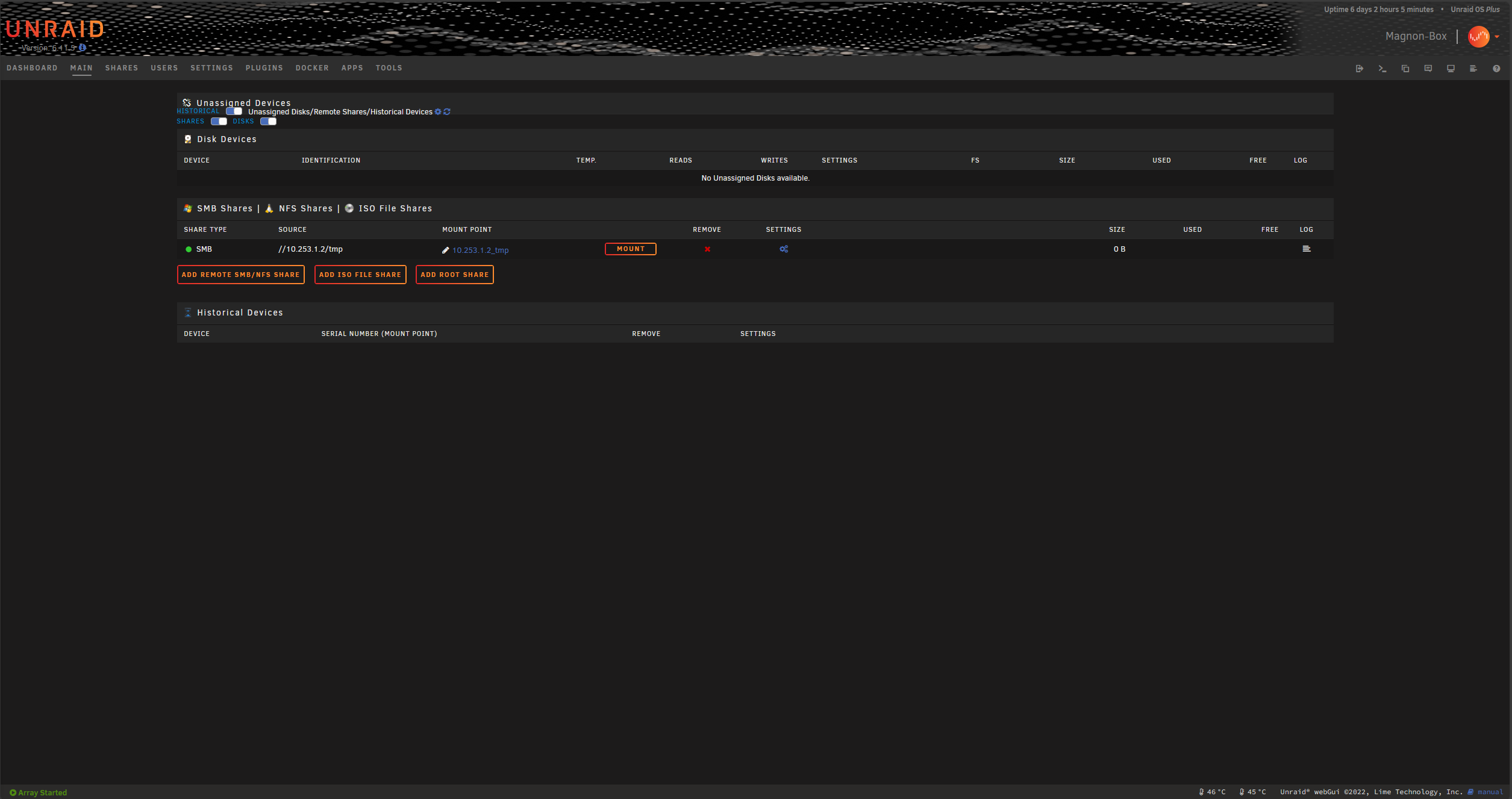

I have a minor issue with the newest version after i updated UD on 6.11.5. The bar on the mainpage is a tat out of whack. Given that i have high hopes that some of the incompatibility issues will be resolved with the next unraid update, its nothing tragic but i did wanted to mention it.

What theme are you using?  Tabbed or untabbed mode?  What is the width of your monitor in pixels?  Show a screenshot of more of the UD page.

Default Black, Page view is non-tabbed, 1440p
I see it.  There were some GUI changes made in 6.12 that are not compatible with 6.11.  I'm looking into it.

i figured that much after reading the notes for 2023.11.10. I had 2023.10.08 until now and was fine. Nothing big but as long as there are issues with nginx and the AX88179 driver im holding off upgrading the main machine^^
i did see how its supposed to look in 6.12 1036792160_ud6_12.4.thumb.PNG.d40199b7d75516b897f1669d0b53ff19.PNG

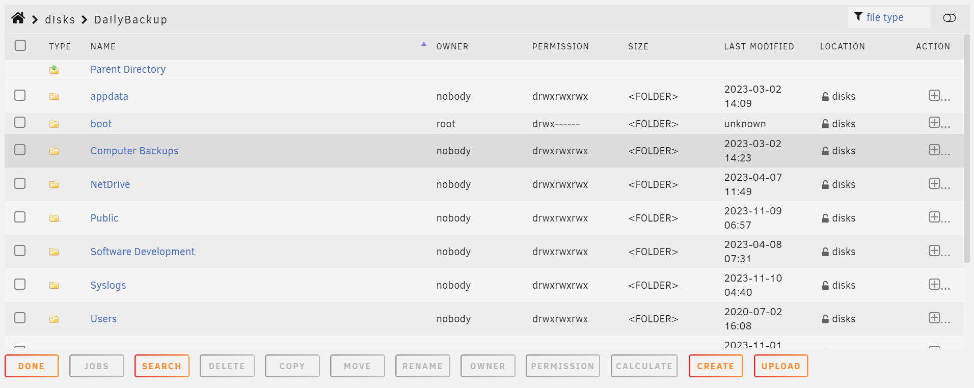

Install the file manger app from CA and then click on the mount point of the device and change permissions.  The file manager looks like this:
If you don't see this, install the file manager from CA.

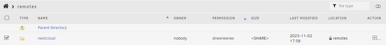

Alright, I tried this and the mount point remains at 0777.
I assume this was just using chmod under the hood anyway. Like I said, as far as I know, a CIFS mount that was mounted with dir_mode and file_mode specified cannot have permissions changed after mounting. chmod will just run and complete with no error, but no permissions are actually changed.
Change permissions on the remote server share and not on Unraid.

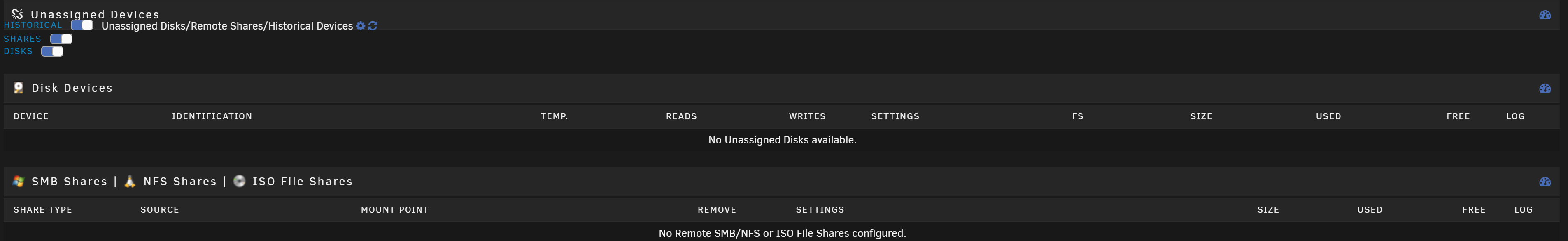

Today's update broke the Toggle switches UI for me... Anyone else?
Unraid Version: 6.11.5
Unassigned Devices Version: 2023.11.10
Unassigned Devices Plus Version: 2023.11.08
Unassigned Devices Preclear Version: 2023.11.08
Cheers!
Cheers!
Same for me on 6.10.3!
Known issue.

I'll have a fix for this in the next release.

Known issue.
Thanks for the quick fix, awesome work as always!

Cheers!
22 hours ago, dlandon said:
Known issue.
Thanks for the quick turnaround on this. Fixed as of version: 2023.11.10a
