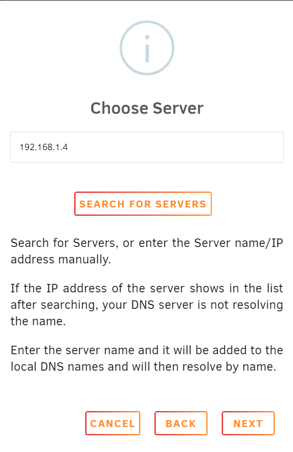

You can't because the dialog for adding a host is removing / not passing periods from the entered IP.

3 minutes ago, DiscoverIt said:
becomes the earlier screenshot
This is what happens when I do that:
becomes
Post your diagnostics.  There may be an issue with your local host setting confusing UD.
Call me curious, I don't follow what you mean with local host confusing UD?
If I enter in 10.253.0.2 and it outputs into samba_mount.cfg without periods what portion of my system would cause the lack of periods in an IP?
Edited by DiscoverIt
Settings->Management Access:
Understood, but I can't reproduce it yet.  It's something unique to your system confusing UD.  I'm working on trying to find how that happens.  You can help me get there by supplying your diagnostics.
Using your IP address this is what I get:
I thought maybe the IP address check was stumbling on your IP address, but I don't see that happening.  I'll look through the diagnostics now.
I found it.  Working on a fix.
Probably related to (new MiscUD)->is_ip($server)) determining what is an IP and what is a hostname?
No.  You have a blank Local_TLD which is valid, but UD did not handle it properly.  A blank Local_TLP should default to 'local'.  Releasing an update now.
Release 2023.11.30a has the fix.

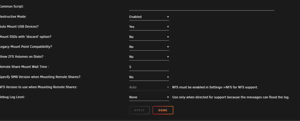

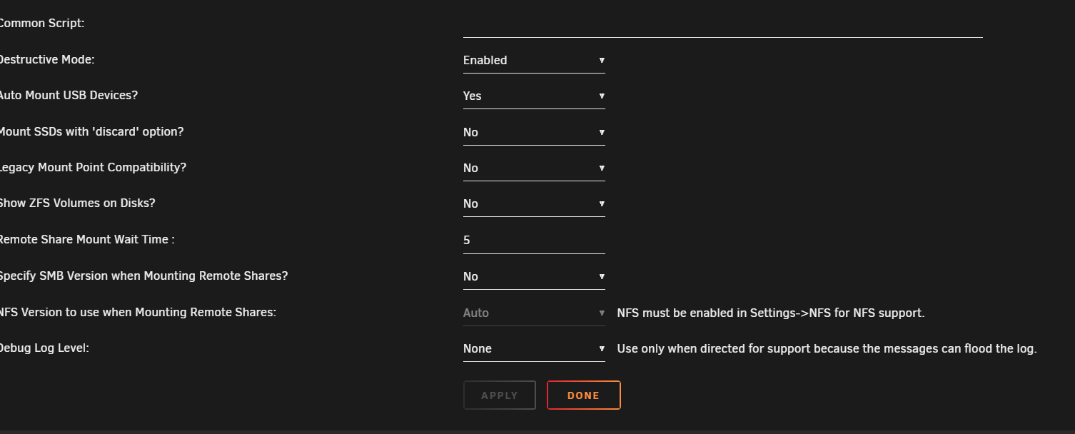

Unassigned device not showing up in network SMB (windows 11)
It's not the new update, first off.  Because I was having this problem and saw the new update and decided to install it, and it did not change anything.
I have an external drive in the array, and I can see it just fine in Krusader, but it will not show up in my shares.  I have tried accessing it via NETOWORK, and via the mapped hard drive and the root share I have setup (which shows everything.
Originaly I had it setup to require a username/password like all my other shares, but I had it set to PUBLIC right now, because I just want it to show up.
This feature used to work. I used it all the time (its for backup purposes)
I've tied YES and NO for "specify the SMB version, thinking that may be the problem.
Anyone had any ideas?  I've been at it for an hour now so I figured I should break down and ask.
Many thanks.
Many thanks.

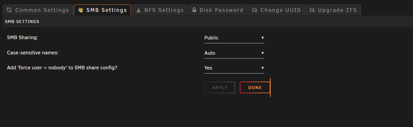

Go to Settings->Unassigned Devices->SMB Settings and set the SMB Sharing you want for your UD devices.  It used to default 'Public' but because of security it now defaults 'Disabled'.
Thank you for the reply, but these are the settings I have already.  :(
Is sharing turned on in the device settings (three gears icon)?
Post diagnostics.
