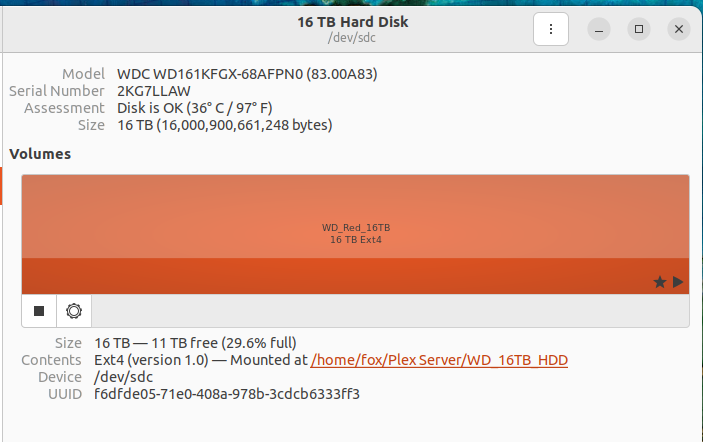

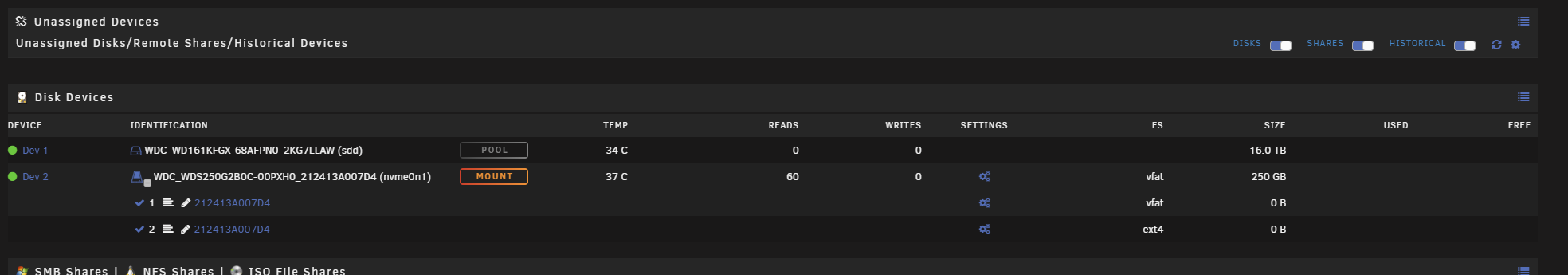

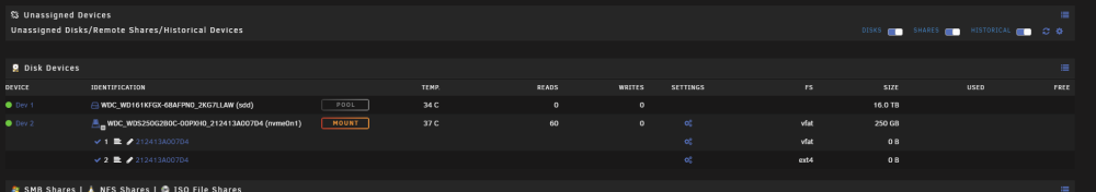

Good Evening,
I'm trying to mount and migrate existing data on a drive (Lets call it 16TB Western Digital) to my newly created Unraid tower and Array, and I'm looking for advice. I hope this is the correct place to post because I believe my issue is with Unassigned Devices not able to mount the drive.
The Dev 1 in this screenshot is the drive in question. I expect it to give the option to Mount, but you can see that option isn't available.
It is using ext4 file system because I was previously using it in Ubuntu. I still have the boot drive for Ubuntu (it is actually the Dev2 shown) and when i boot back into that OS (which is the same computer, I just change the boot order in mobo bios) the drive mounts fine in ubuntu. Here is the screenshot of Gnome Disks in ubuntu showing it's Ext41822598180_Screenshotfrom2023-12-1618-45-37.png.eb48e7da726e51922fbf403951f44321.png

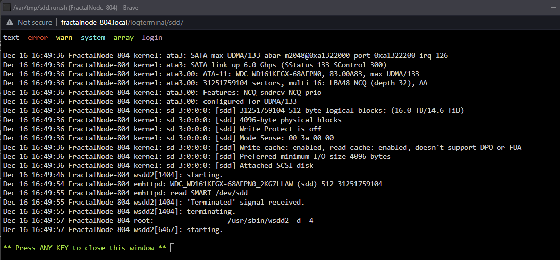

Which I click on "Disk Log Information" these are the logs.
I would guess it's something to do with that "'Terminated' Signal received."
Attached is Unraid Diagnostic logs, and i've tried to review them myself but I can't seem to figure out why it won't mount.
That disk has an 'ext4' file system, but is not partitioned.  UD marks the 'Mount' button as 'Pool' becaue UD thinks the disk was part of a pool in another system.  UD can't mount a disk without a partition.
Your best bet is to install it in the original computer (or another computer) that can mount the disk and then mount it with UD as a remote share.  Then you can copy the files and folders using the File Manager.
Just make a folder in /mnt/addons and mount it there manually.
