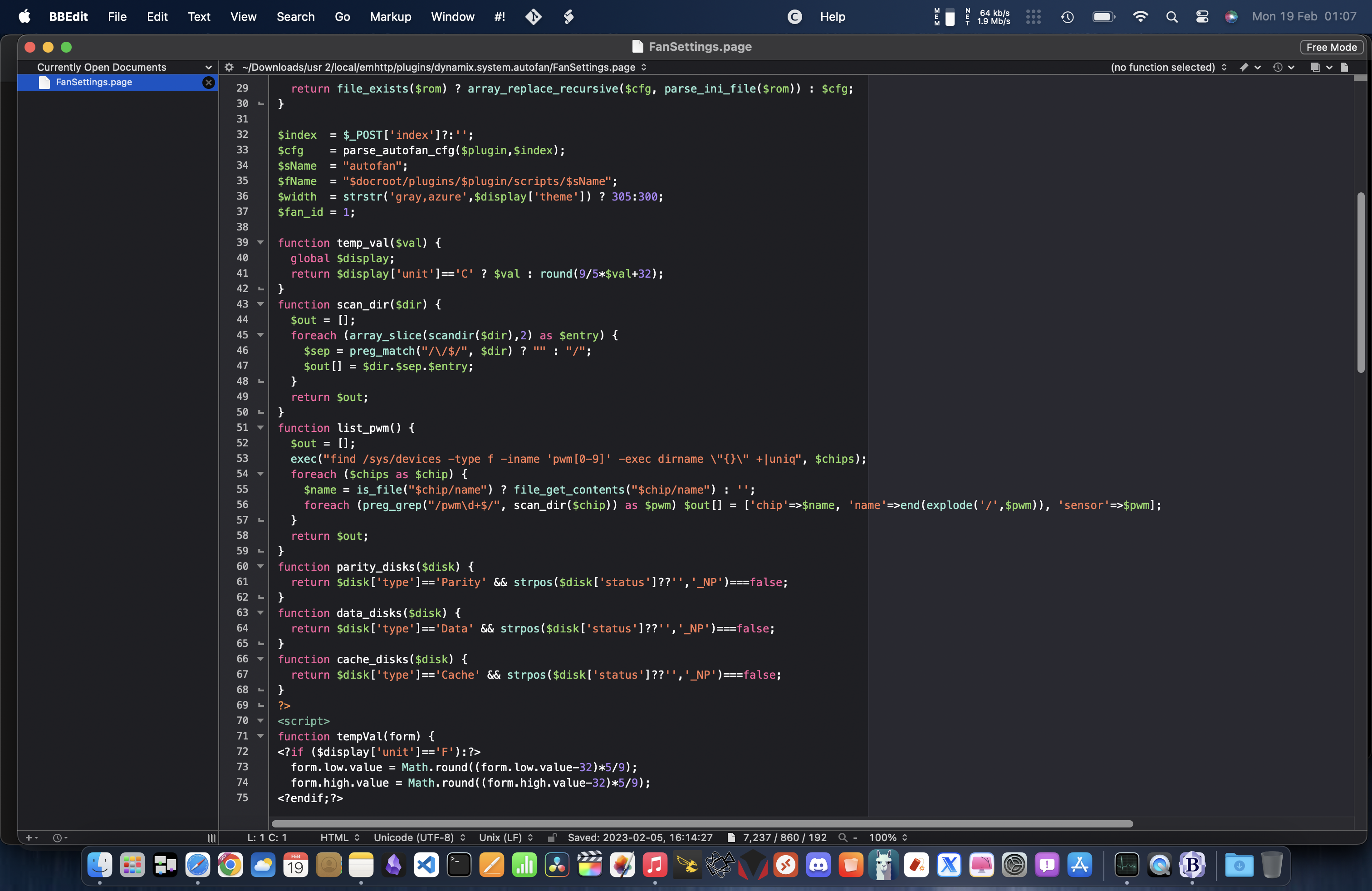

Looking at updating the dynamix auto fan plugin.
Is there a way to call drives from the unassigned plugin? or a way I can say ignore them?
Currently they are being included under data disk and this then affects fan speed & noise while I sleep. Think others would enjoy a fix too.
function data_disks($disk) {
  return $disk['type']=='Data' && strpos($disk['status']??'','_NP')===false;
Edited by dopeytree
I think you might be asking in the wrong place.  Try the support for the auto fan plugin.

Does the Unassigned Drives plugin set a flag named unassigned_drive to true for its drives?
No.  If you are looking for a way to find UD devices, there are several ways.  What is it you are looking for?
