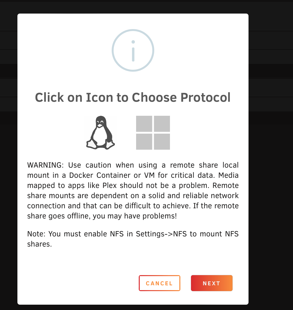

After updating to 6.12.10 I can no longer add remote SMB shares. When I click the button to add a share I get a warning popup window but clicking "Next" doesn't do anything.
UD version- 2024.3.31
443169541_Screenshot2024-04-05at6_29_07AM.thumb.png.daa333783b4aac677ff51c3b385622d1.png
brunnhilde-diagnostics-20240405-0625.zip
Edited by wgstarks
Please disregard. I'm an idiot. 😀
Didn't actually read the popup and never selected a protocol.
Can't tell you how many times I've done things like that.  No worries.

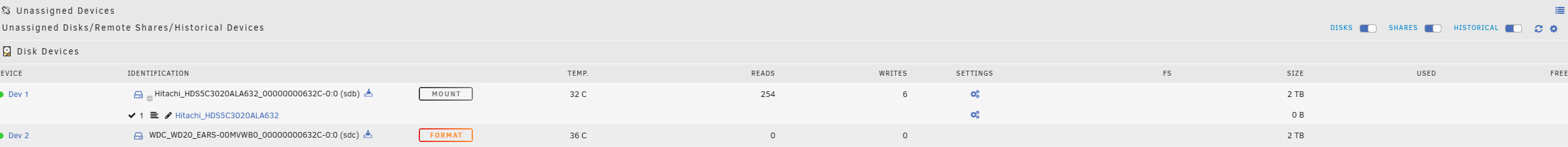

I just moved a 4 disk USB HDD dock (uses jmicron 758 controller) over from Windows (deleted all volumes on the disks in windows diskmanager first) and in unassigned devices only 2 of them show up. When I go to "Tools, System Devices" I do see all 4 disks but only 2 appear in unassigned devices. Any ideas?
From system devices:
[0:0:0:0]disk Kingston DataTraveler 3.0 PMAP /dev/sda 124GB
[1:0:0:0]disk Hitachi HDS5C3020ALA632 0409 /dev/sdb 2.00TB
[2:0:0:0]disk WDC WD20 EARS-00MVWB0 0409 /dev/sdc 2.00TB
[3:0:0:0]disk Hitachi HDS5C3020ALA632 0409 /dev/sdd 2.00TB
[4:0:0:0]disk Hitachi HDS5C3020ALA632 0409 /dev/sde 2.00TB
[6:0:0:0]disk ATA N900-512 5A0 /dev/sdf 512GB
When I check SMARTCTL all the drives have unique serial numbers.
If I plug the HDD Dock into my Synology all disks and devices are found correctly and can be used as external devices. Likewise if I plug into a Windows 11 PC all disks are found and ready to use...
From unassigned devices:
tower-diagnostics-20240406-1634.zip
