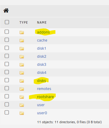

After install and config. i have this dirs new and i cant delete this. remotes is ok, there are my remote dirs on the other server. but "addons" + "disks" + "rootshare" empty
Edited by dibux
They are always meant to be there.
UD creates those mount points:
  • disks - used for mounted UD disk devices.
  • remotes - used for mounted UD remote shares.
  • addons - used to mount user mounted devices so FCP will not flag the mount as eroneous.
  • rootshare - used for rootshare mounts.
Why are these there if I don't use them you might ask?  Those mountpoints are mounted themselves with a max size limit so misconfigured Docker Containers and VMs don't crash Unraid by writing lots of data to that mount point (tmp file system) instead of the actual device.  /mnt/ is in the tmp file system and doesn't have a lot of room for eroneous data.

When using Unassigned Devices, not all unassigned devices show up, this seems to be with both .9 and .10
I was already preparing to totally redo my system due to VM issues (VM's not wanting to restart, they just hang and use up CPU even from fresh install with only viostor driver), so thought it may have something to do with but alas, on a totally fresh install, the issue remains
2 pictures attached, one with the default unassigned devices listing, showing all my drives properly, the second, with unassigned devices add-on installed.

58 minutes ago, Hammerfest said:
If someone has already reported this issue, then my use of search terms with the forum's search feature has failed me.
Post diagnostics when all show and when only some show.
Sure, all I am doing is removing and adding the add-on.
Will do it when im able this evening.
