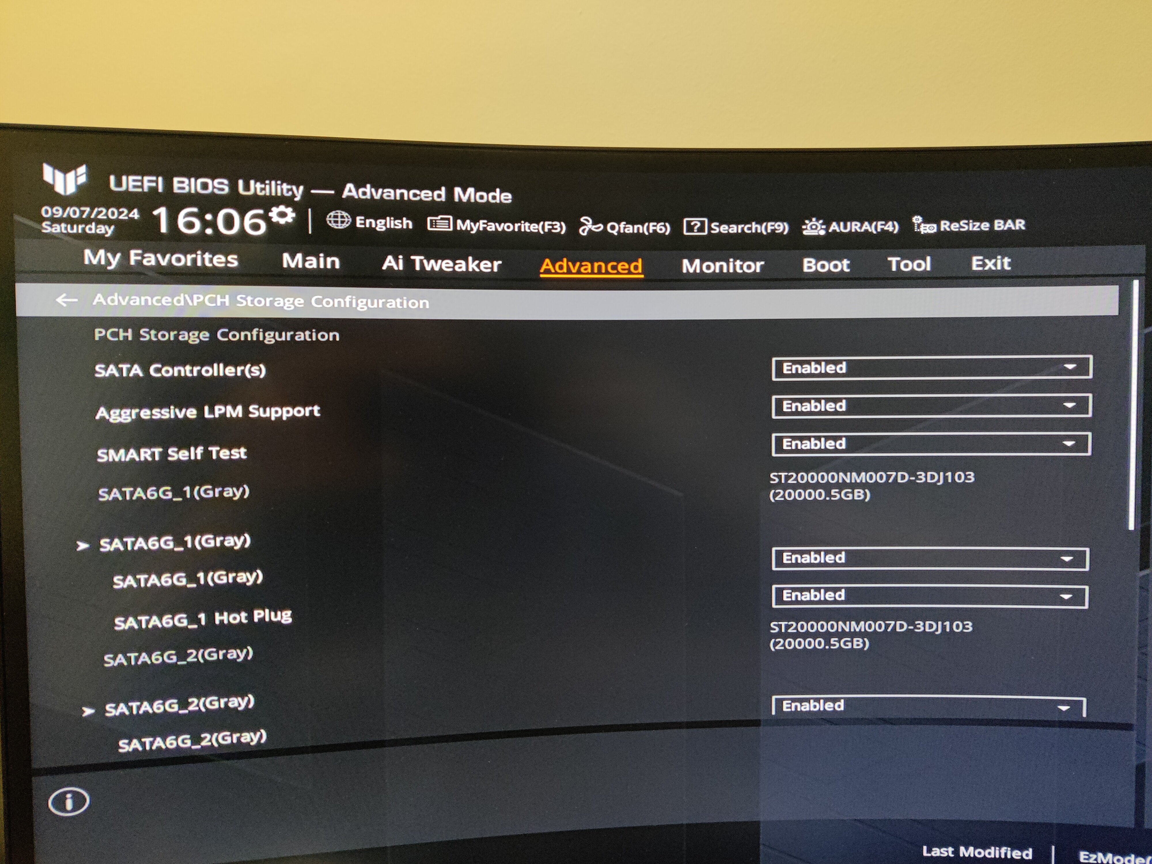

26 minutes ago, swiss01 said:
Unfortunately, this does not work, even if I wait several hours. The HDD does not appear in UD
Are you sure hot plug is enabled in the BIOS?
yes
33 minutes ago, swiss01 said:
yes
Is AHCI enabled on the sata controller(s)?
This?
