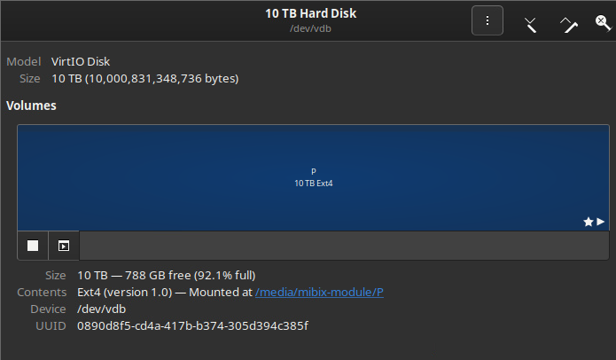

I had all my storage drives but one unpartitioned and formatted to ext4 that I used in Ubuntu.
Is there a way to get these mountable for faster copying into my array?  They weren't encrypted.
Here is what it looks like in Ubuntu:
UD can only mount devices that are formatted with a partition.  If you can mount the device in another computer, you can then set up a remote share with UD.  Another option is to set up a n Ubuntu VM and mount it with the VM.
