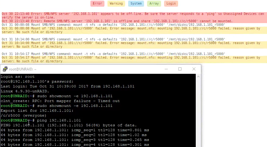

On 10/28/2017 at 7:14 AM, dlandon said:
Oct 26 17:25:36 Error: SMB share '192.168.1.138:/mnt/user/r5000://mnt/user/r5000' appears to be off-line.
Oct 26 17:25:36 Error: Remote SMB/NFS server '192.168.1.138:/mnt/user/r5000' is offline and share '192.168.1.138:/mnt/user/r5000://mnt/user/r5000' cannot be mounted.
The 'No such file or directory' message is because the server is off-line and the rc5000 file cannot be found.  Here is a part of the UD log:
UD pings the server at 192.168.1.138 to see if it responds to check if the server is on-line before mounting the share.  You need to see why the 192.168.1.138 IP address does not respond to a ping.
There are several issues I see here with UD.  I made some changes to try to help with shares that go off-line by logging those events.  The log entry is showing the wrong information though.  The other issue is UD should not even try to mount a share that is not on-line.
I'm going to work on cleaning up this situation.

After looking at your log a little closer, you have several things going on here.  The ping issue is probably from starting unRAID and the VM not running.  When UD starts it cannot ping the VM.  I suspect your share is set to auto mount.  After the VM is running, the ping is successful because a mount is attempted.
After some time I suspect you are then trying to mount the share and get the file not found error.
The issue you need to concentrate on is the 'No such file or directory' error on the server.  I don't know how you have the VM set for NFS sharing, but that's the heart of your problem.

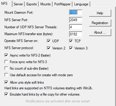

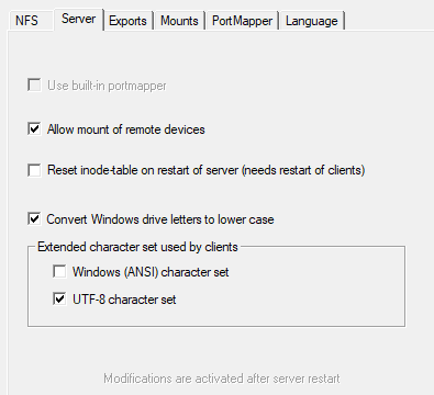

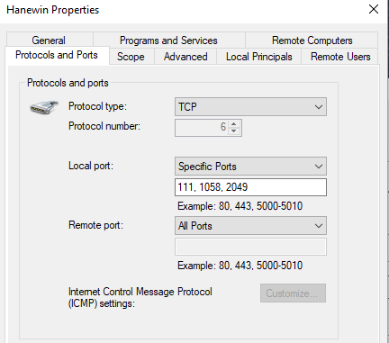

Some of these were posted earlier, but here are all the settings of the Hanewin NFS Server that is installed on the VM.  Also below is a screenshot of the firewall rule i setup to deal with the ports (although the firewall has been off completely while I'm working on this)
image.png.9e120d0b93c722609d62c663fdc43f14.pngimage.png.8ff84451a7cea10e933a992236f68110.pngimage.png.6c6a7dded06f62db2e1ce383f592a92c.pngimage.png.9f20c822faa547ca6ea021852453234d.png
I've helped you all I can with this.  Your issue is probably not with UD and I don't know enough about NFS to help any further.  I would suggest you start a new thread and ask for some help from someone more knowledgeable about NFS.
