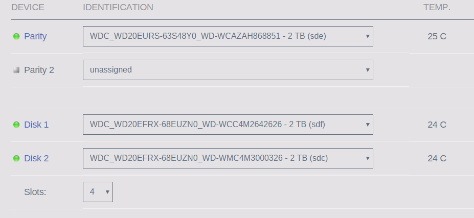

I see the problem.  UD thinks you have 12 disks assigned to the array because you have set the number of slots to 12.  Don't leave any array slots as 'unassigned'.  Set the number of array slots to the number of disks actually in the array.
UD thinks all your disks are in the array and won't show them as unassigned devices.

I got what I needed.  It looks like you assigned your array disks as the first four disks, then seven unassigned, and then parity to the last slot.  Let me know if this is what you did.
Never mind.  You can't do that.
