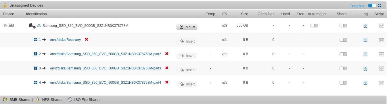

Hello
I don't know if anyone can help with this but I suspect it might be a bug in the plugin.
I just installed the latest version of Unnassigned Devices - dated 2018.04.09 onto Unraid v 6.5.1
I did a conversion of a VM disk directly to a new SSD drive, unassigned to the array, and it created the expected partitions. But each of the partitions are listed as 0 bytes. I updated the VM to use the disk and it did work, although slower than I had expected, but the sizes of the partitions are still showing zero.
Below is a screenshot of what I see. Any ideas?
2 hours ago, awpullen said:
Any ideas?
What happens when you click the Mount button?
5 hours ago, awpullen said:
Hello
Mount the disk and the sizes of the partitions will show.
Thank you both. I guess the simplest solutions are the best, it works fine.
I had seen a tutorial where this was not necessary, so maybe that was a version issue of either the plugin or of Unraid itself.
Anyway, thanks for your feedback, I am now all set.

May 5 11:14:14 drChina1 kernel: ata7.00: detaching (SCSI 7:0:0:0)
May 5 11:14:14 drChina1 kernel: sd 7:0:0:0: [sdh] Synchronizing SCSI cache
May 5 11:14:14 drChina1 kernel: sd 7:0:0:0: [sdh] Synchronize Cache(10) failed: Result: hostbyte=0x04 driverbyte=0x00
May 5 11:14:14 drChina1 kernel: sd 7:0:0:0: [sdh] Stopping disk
May 5 11:14:14 drChina1 kernel: sd 7:0:0:0: [sdh] Start/Stop Unit failed: Result: hostbyte=0x04 driverbyte=0x00
May 5 11:14:14 drChina1 rc.diskinfo[9417]: SIGHUP received, forcing refresh of disks info.
May 5 11:18:48 drChina1 kernel: ata7: exception Emask 0x10 SAct 0x0 SErr 0x4040000 action 0xe frozen
May 5 11:18:48 drChina1 kernel: ata7: irq_stat 0x00000040, connection status changed
May 5 11:18:48 drChina1 kernel: ata7: SError: { CommWake DevExch }
May 5 11:18:48 drChina1 kernel: ata7: hard resetting link
May 5 11:18:58 drChina1 kernel: ata7: softreset failed (1st FIS failed)
May 5 11:18:58 drChina1 kernel: ata7: hard resetting link
May 5 11:19:01 drChina1 kernel: ata7: SATA link up 3.0 Gbps (SStatus 123 SControl 300)
May 5 11:19:01 drChina1 kernel: ata7.00: ATA-8: ST4000DM000-1F2168, S30030A6, CC52, max UDMA/133
May 5 11:19:01 drChina1 kernel: ata7.00: 7814037168 sectors, multi 0: LBA48 NCQ (depth 31/32), AA
May 5 11:19:01 drChina1 kernel: ata7.00: configured for UDMA/133
May 5 11:19:01 drChina1 kernel: ata7: EH complete
May 5 11:19:01 drChina1 kernel: scsi 7:0:0:0: Direct-Access ATA ST4000DM000-1F21 CC52 PQ: 0 ANSI: 5
May 5 11:19:01 drChina1 kernel: sd 7:0:0:0: Attached scsi generic sg7 type 0
May 5 11:19:01 drChina1 kernel: sd 7:0:0:0: [sdh] 7814037168 512-byte logical blocks: (4.00 TB/3.64 TiB)
May 5 11:19:01 drChina1 kernel: sd 7:0:0:0: [sdh] 4096-byte physical blocks
May 5 11:19:01 drChina1 kernel: sd 7:0:0:0: [sdh] Write Protect is off
May 5 11:19:01 drChina1 kernel: sd 7:0:0:0: [sdh] Mode Sense: 00 3a 00 00
May 5 11:19:01 drChina1 kernel: sd 7:0:0:0: [sdh] Write cache: enabled, read cache: enabled, doesn't support DPO or FUA
May 5 11:19:01 drChina1 kernel: sd 7:0:0:0: [sdh] Attached SCSI disk
May 5 11:19:01 drChina1 rc.diskinfo[9417]: SIGHUP received, forcing refresh of disks info.
May 5 11:19:01 drChina1 rc.diskinfo[9417]: PHP Warning: Use of undefined constant ID_MODEL - assumed 'ID_MODEL' (this will throw an Error in a future version of PHP) in /etc/rc.d/rc.diskinfo on line 470
May 5 11:19:01 drChina1 rc.diskinfo[9417]: PHP Warning: Use of undefined constant SERIAL_SHORT - assumed 'SERIAL_SHORT' (this will throw an Error in a future version of PHP) in /etc/rc.d/rc.diskinfo on line 470
Here the result of a successful xfs-encrypted mount
May 5 11:37:36 drChina1 unassigned.devices: Adding disk '/dev/mapper/SS_1695'...
May 5 11:37:39 drChina1 unassigned.devices: Mount drive command: /sbin/mount '/dev/mapper/SS_1695' '/mnt/disks/SS_1695'
May 5 11:37:39 drChina1 kernel: XFS (dm-3): Mounting V5 Filesystem
May 5 11:37:39 drChina1 kernel: XFS (dm-3): Ending clean mount
May 5 11:37:39 drChina1 unassigned.devices: Successfully mounted '/dev/mapper/SS_1695' on '/mnt/disks/SS_1695'.
May 5 11:37:39 drChina1 unassigned.devices: Defining share 'SS_1695' with file '/etc/samba/unassigned-shares/SS_1695.conf'
May 5 11:37:39 drChina1 unassigned.devices: Adding share 'SS_1695' to '/boot/config/smb-extra.conf'
May 5 11:37:39 drChina1 unassigned.devices: Reloading Samba configuration...
May 5 11:37:39 drChina1 unassigned.devices: Directory '/mnt/disks/SS_1695' shared successfully.
May 5 11:37:39 drChina1 unassigned.devices: Device '/dev/mapper/SS_1695' script file not found. 'ADD' script not executed.
