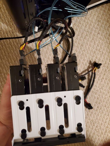

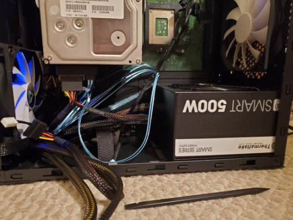

I now have a separate problem. The combined height of the cables I'm using to connect my HDD to my SAS controller and the PSU cables I'm now using to power my HDD make it so that one of my HDD bays won't fit on top of my PSU. Do you have any suggestions for cables I could purchase in order to make this work (I'll attach pics to make it easier to see). It seems I'll also have to pick up at least an extra 3 power cables to power the rest of my drives.
Nevermind... figured it out myself. 90 degree cables and power extensions.
