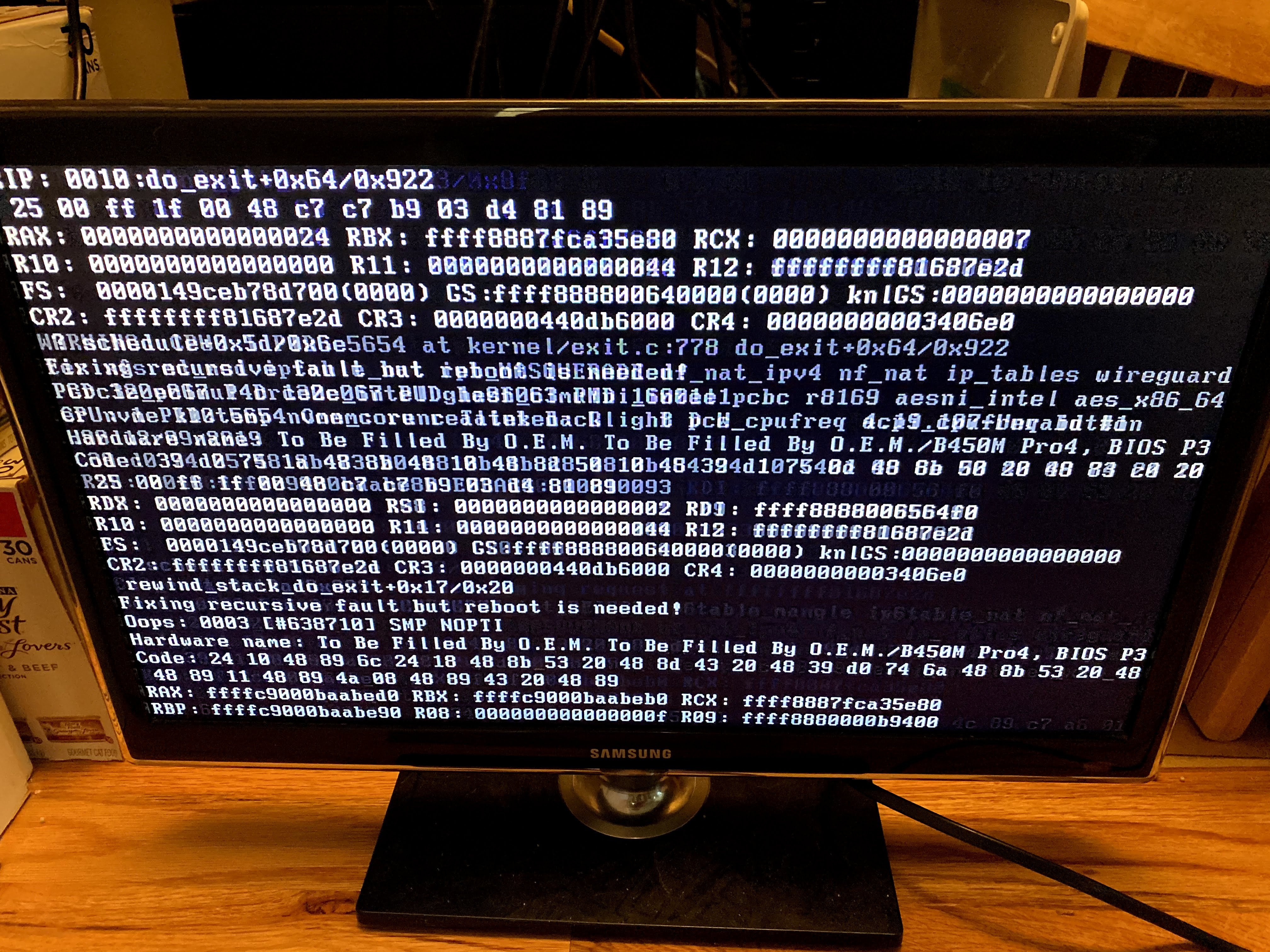

@testdasi Started backing up family photos and am now locked out.  Interesting as I am not getting either of the errors from my title, but  I am locked out of the server and the monitor that is hooked up to the server is going crazy in a command line with text scrolling rapidly across the screen.  With no access to the web gui now, not sure what to do.
Take a picture of the screen?
one thing I noticed in that still is a reference to Wireguard.  I did recently set that up to use as a way for my family to back up remotely to this server.  Anyone know if wireguard causes stability issues?  I do remember something about this not being fully supported or something to that effect

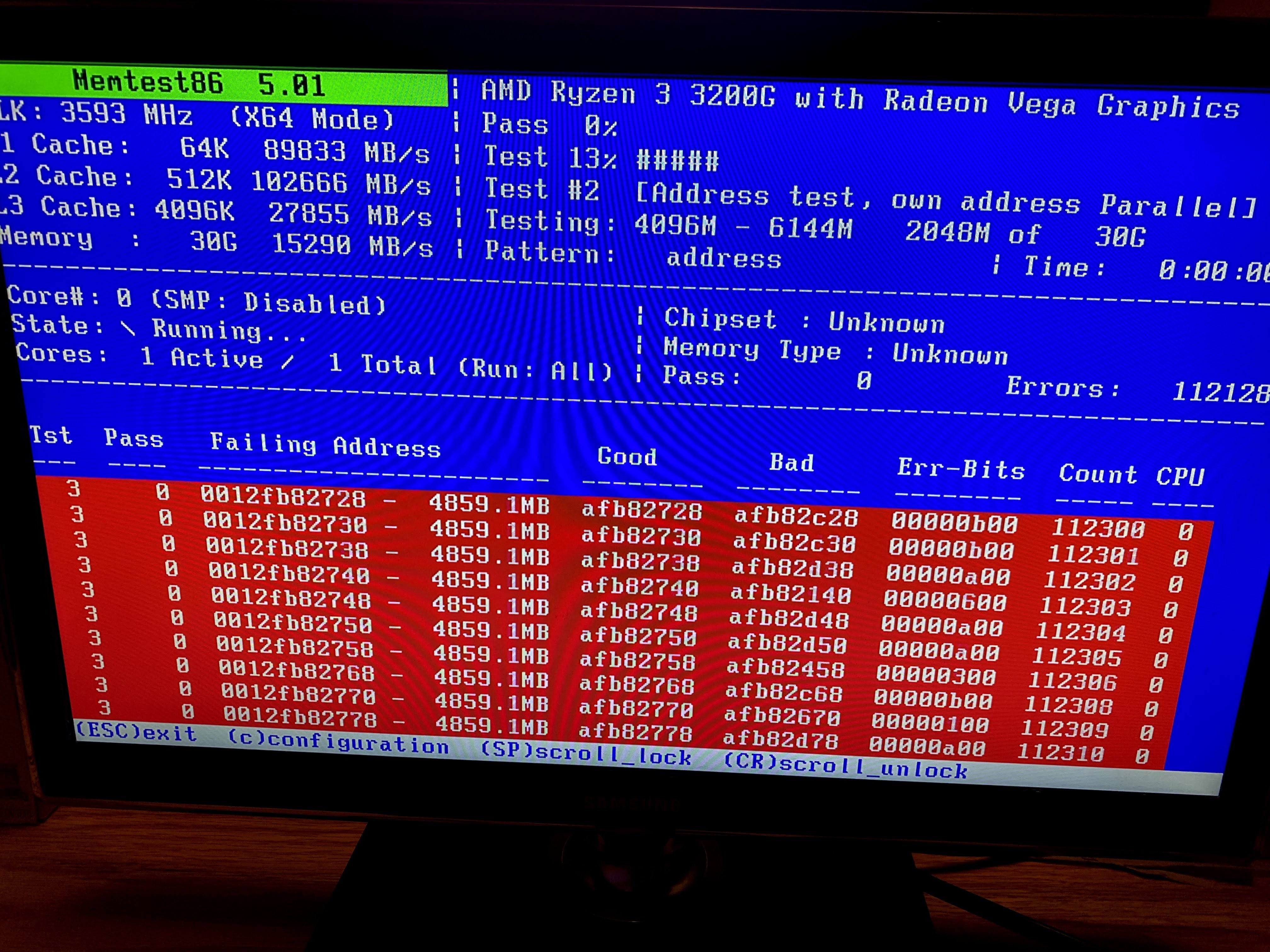

and I am not exactly sure what a successful memtest looks like, but something tells me this doesnt look good.  see attached...

Did you set the memory speed in the BIOS? I'm not sure how to interpret the numbers I'm seeing, does CLK: 3593 MHz mean anything?
And yes, any fail on memtest is severe, and must be eliminated before things will stabilize. Assuming the memory is not running an overclock (XMP) profile, I would try swapping sticks around and running on one stick at a time in memtest until you get zero errors over a period of not less than 12 hours, I wouldn't trust my data to a server that didn't run at least 24 hours with a clean memtest.

Really no point in continuing a test with a failure shown.
