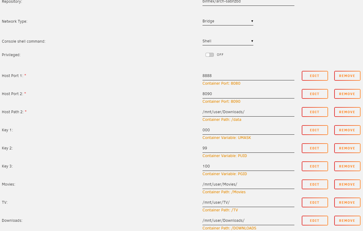

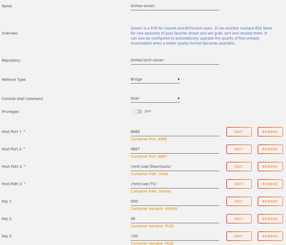

I used the binhex version of Plex, SABnzbd, and Sonaar (Radaar as well).  The settings are like you see below:
Unraid Shares:  Downloads, Movies, TV

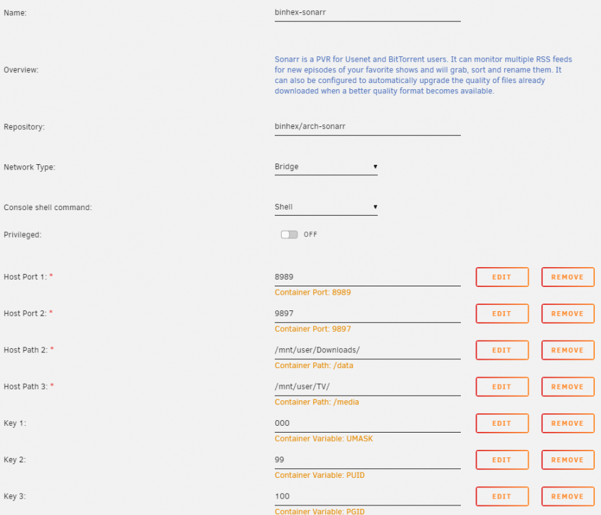

Sonaar Docker Settings:

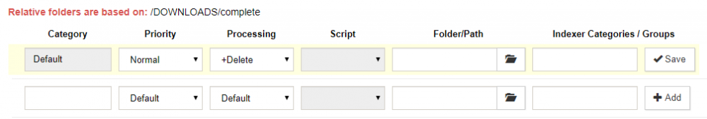

* I had TV as a category and folder/path of  /TV.  But that will just push them to the directory in their individual folders - which is not what I want (I want season folders based upon the Sonaar settings)

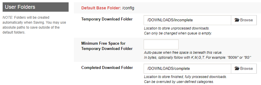

You've CAPITALIZED /DOWNLOADS in Sab's settings.  It should be /Downloads
I selected that folder.  The container path is /DOWNLOADS  (And the files are getting to that location no problem)

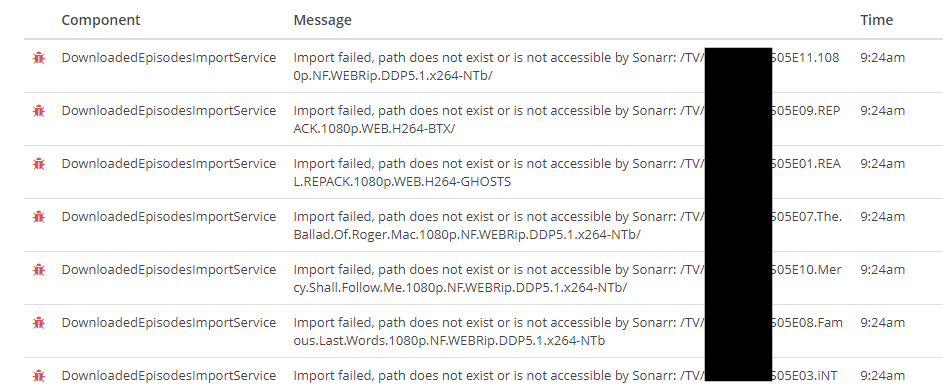

This may have something to do with it:
But why would it be importing from the /TV/ path?  I would think it would import from the /Downloads path

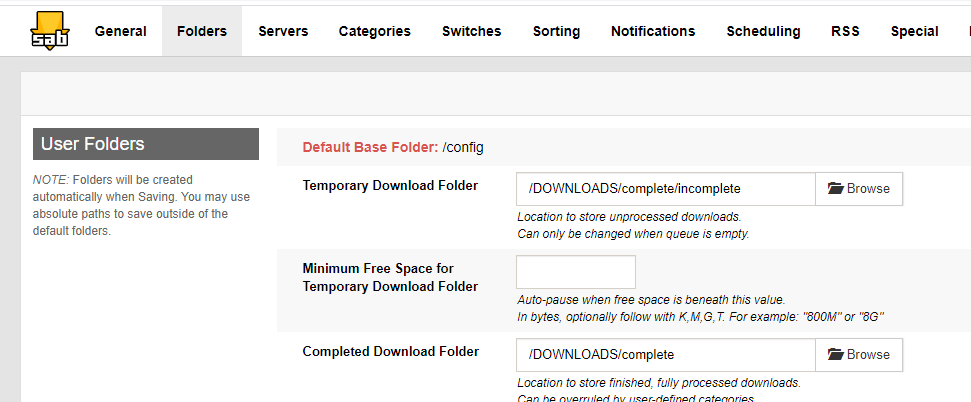

I did update my docker for SABnzbd to put the container path = /Downloads.  Didn't do anything different - but I think the source of the issue is Sonaar trying to import from the /TV location , which is still odd to me and I cannot find a setting for it.
Do the files need to be in a /complete/ folder?  The structure shown above will put the downloads in /Downloads and the incompletes in /incomplete.  But there is not a /complete folder like I have on my Windows-based machine.
