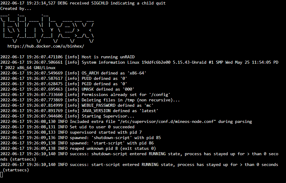

anybody else have an issue where the docker takes almost 20 minutes to finish loading so i can access the webui?
The log will stay at this screen for 17-18 minutes or so before finishing booting, and any time i need to restart the docker it does the same thing.
Eventually it finishes booting and the log looks like this (note the timestamps to see the delay):
Mine loads promptly, as long as I have enough storage. I accidentally ran out of space because I didn't delete old archives, and it took forever to start until I manually deleted some of them. BTW, the drive the files were on still showed free space, and other apps were fine, but the mineos internal logs showed out of space when trying to create snapshots and archives. Didn't troubleshoot further because removing the extra archives fixed it.
You could try moving your active games profile folder to another location temporarily and see if it starts promptly.
Yes, I'm having this issue too now. No problems two days ago, but it takes forever to start up now. I'm seeing it stuck exactly like in your first screenshot. Haven't waited long enough for it to reach "MineOS-node started" yet.

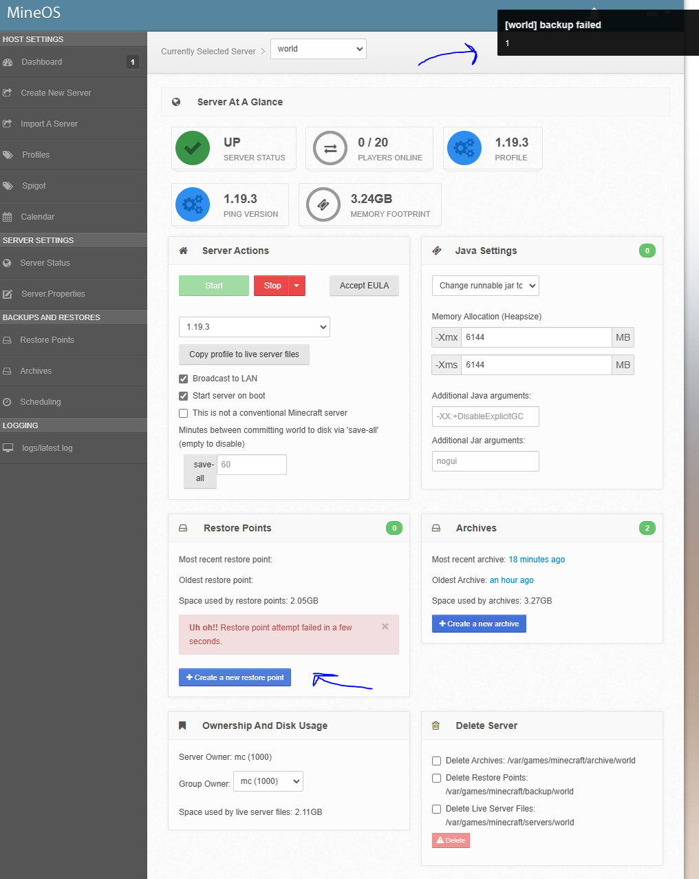

I'm running into an issue where my restore points stopped being created on after 5:00pm on December 3rd.  The manual and automatic restore point creation via the MineOS GUI doesn't work.  In the Restore Points box, it says "Uh oh!! Restore point attempt failed a few seconds ago."  In the top-right corner, the pop-up window says "[world] backup failed 1".
There are no updates for the MineOS docker, the world is still accessible, and creating an Archive backup works fine. It is just the Restore Points. I've tried running the server from 19.1 to 19.3, but that didn't resolve the issue, either.  Stopped/Started the docker, rebooted the unRAID server, and updated the unRAID server, too.  Any ideas on where I could start investigating?
Edited by ZurkeyDurkey
Uploaded screenshot.

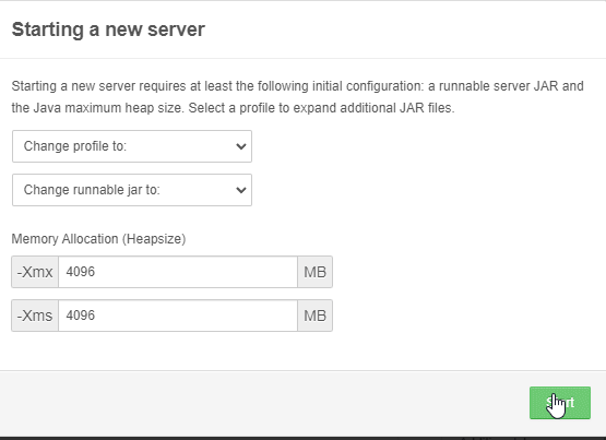

I'm attempting to do the same but am stuck at this point. Have created a folder for fabric but it doesn't show up in the dropdown for server profiles.
How did you start the server?

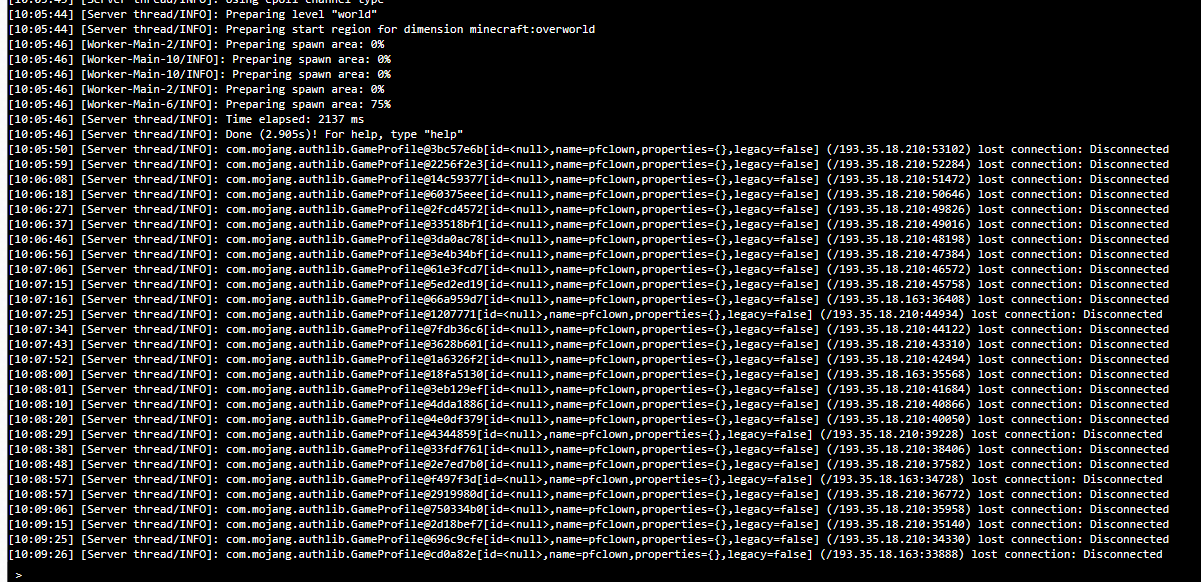

com.mojang.authlib.GameProfile@14c59377[id=<null>,name=pfclown,properties={},legacy=false] (/193.35.18.210:51472) lost connection: Disconnected
I get messages like this with the same IP, but different port. This occurs when MineOS docker is running, but the world doesn't need to be started for these logs to keep appearing. Attaching screenshot.
1 hour ago, ZurkeyDurkey said:
keeps logging an attempted connection every few seconds.
Block that IP range on your firewall. It's an automated hack attempt.
I'm such an idiot, I forgot I turned off Threat Management to do throughput tests and never turned it back on.  But, thanks for confirming that those appear to be malicious attempts.  I got the issue resolved.
Rather than make a separate post, there is one minor issue I have just been dealing with. After deleting my world (just folder "world"), and uninstalling/reinstalling the Docker for MineOS, I restored my server as "world2". But, an old cron job still seems to be running. It is doing hourly archive backups of "world" still. I think it is actual backups of "world2", but I can't confirm. I keep having to delete these backups before the SSD fills up. There is no visible Cron job running for this.  Any thoughts?
