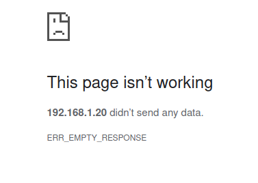

Hey man, first off - thanks for all the work you do with all your docker images!  Much appreciated.
Secondly.... "Ni"!
Finally, to my issue.... i just did a fresh install of this image, changed nothing on the install (not even the pw - and none of the ports are conflicting) and get to the login, login with root / mineos and get a `This site can't be reached` and the web ui seems to have crashed - have to restart it to access the login.
Can't get in no matter what.
Any suggestions (anything else i can provide detail wise to help troubleshoot)?
Thanks in advance!
Edited by juanamingo
Secondly.... "Ni"!
Thanks in advance!
Same thing for me actually. I noticed him mentioning that it needs to be run as root. It seems to be set to out of the box from what I can see in the settings for the docker but it's still a no go.
On 7/11/2020 at 10:55 PM, juanamingo said:
Secondly.... "Ni"!
argghhh!, how dare you say Ni to me! 🙂
can you left click icon, select edit, then toggle on advanced view top right, and click show more settings, then screenshot and post it here.

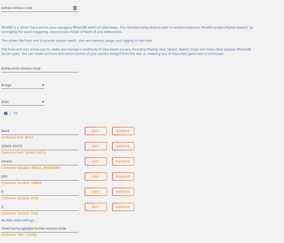

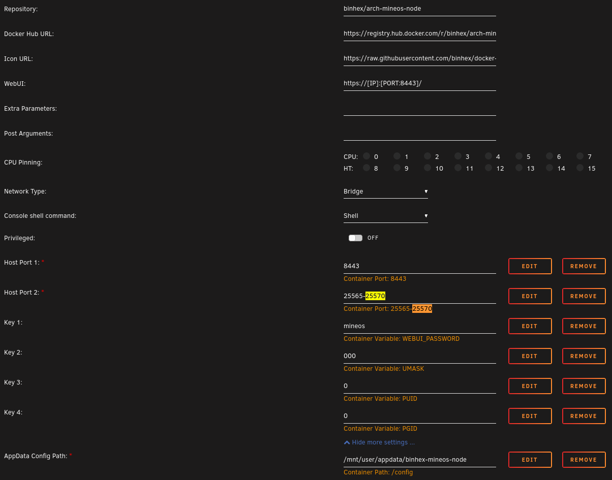

if you have a cache drive, can you try changing the host path for /config to /mnt/cache/appdata/binhex-mineos-node
2 minutes ago, binhex said:
bloody peasants!
Help! Help! I'm being repressed!
/appdata is on the cache drive already, but i did change it to use /mnt/cache/appdata/binhex-mineos-node and started it.
At the login using root / mineos and:
Have to restart the container to get back to the login or  I get:
dont login as root, use username 'nobody' password 'mineos'
Nope... I think I'm the peasant now..... My browser auto-filled the user as `root` because of the last mineos container and i didn't think to change it...  `nobody` worked!
(I figured `Arrrgh` fit well with my reaction when I realized i was dumb)
Thanks again man!

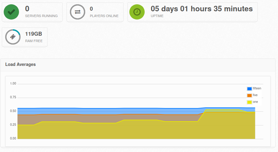

It's been a while since i used the UI - and granted, it was a different docker - but have a couple of questions.
1) The uptime - i thought i remember it being the container uptime, not the server uptime?
2) The load averages - on a fresh install (no servers etc), unless i'm reading them wrong - they seem like they're high?
The UnRaid dashboard, top and htop aren't showing any weird usage.
i cant comment about the other container but this one sees the hosts uptime, not much can be done to change this afaik.
is that high?, high compared to what?, difficult for me to compare to be honest, what does top/htop show?
No worries on that - it just stood out as odd to me is all.  It could be that the other did the same and i had just rebooted, so uptime was low.  I'm getting old, so let's go with bad memory =)

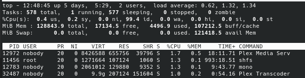

I was reading it as there was about 50% cpu usage, and this is what top is showing now, and the ui
I'm guessing now that the use is host related - not container related - just as the uptime.

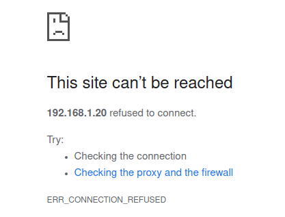

Hey, I used to run this Docker with no issues but have recently re-installed it and am getting the following error "No profiles are available; check internet connectivity and refresh the profile list." I do have a pfsense Box but can't seem to find any information on why it wouldn't work? I have tried updated the WebUI and re installing the Node packages etc. Any help would be appreciated, thank you!
I have been using this but keep getting a "Connection Refused".  I have my server set to autostart so my server is running right now and I can play on it but I am unable to access the webpage at all.  This is happening quite frequently.  My only solution I found was to restart the entire server.  I hsbr 8443 port forwarded correctly i believe (i port forwarded the server).  I will shutdown the container and start it up and I will be able to access the mineos and login and operate as normal.  Then something happens and i refresh the page to look at the console log and I get a connection refused although the server is still up and running.  Tips/advice?
edit: I have found that if i start the docker it will be fine but after the minecraft server starts all the way the container can not be reached anymore.  It seems to lose connection once the server reaches 5+gb of ram usage.

On 5/16/2020 at 2:33 PM, binhex said:
IMPORTANT
Please note this container MUST run as user 'root', group 'root' (PUID=0 PGID=0), otherwise you will be unable to authenticate via the web ui.
Hi binhex.
Where is this set within the xml during install? For my own clarity is that running as root within the container or root under unraid os?
5 hours ago, repomanz said:
Hi binhex.
its defined when you first setup the container via values for keys PUID and PGID, they need to both be a value of 0.
its running as root on the host and impersonating root inside the container as user 'nobody'.

i have the server set to auto-start and am unable to open the webgui for MineOS and it doesn't look like the server starts either
11 hours ago, hraboskyjr said:
Not sure if this is working correctly: I am getting the same issue on a clean install. profiles don't show up and the spigot profile for build tool does nothing.
can you guys confirm what login credentials you are using for the mineos-node web ui?, it should be (taken from the readme.md):-
Login to the web ui is via username 'nobody' with password as specified via env var value for 'WEBUI_PASSWORD'.
