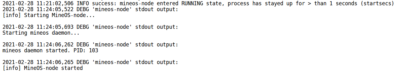

the added delay in starting the docker can be seen in the timestamps in the docker's log, however i don't see any useful information as to why the delay:
The delay is almost exactly 3 minutes in this log (11:21:02 -> 11:24:05)
I wonder if it has something to do with file permissions, but i have run chmod -R 777 on the entire docker's appdata files prior to starting for this run, so if it's a permissions issue, I don't think there is anything I can do about it.
I have the same issue. Can't reach the webUI from time to time.. have to restart the docker. Really annoying :(
due to the fact that this container MUST run as user root i have to chmod any newly created files on startup to permit user 'nobody' access, otherwise i would get a lot of complaints about people not being able to edit/move files around. i could be more selective as to what i chmod, but as it is right now every file and folder in the config folder for this container is chmod 777.
having said all of the above, a chmod should certainly not take minutes, a couple of seconds at most, is the /config folder nested within other folders by any chance?.

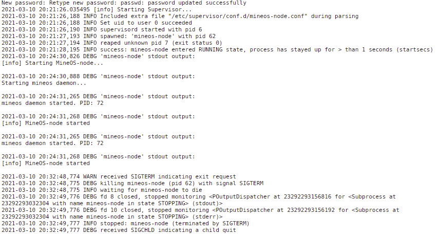

I managed to have the docker log open when the webui stopped responding. the section at the top was starting the docker, middle is running correctly, and bottom it crashed/stops responding.
