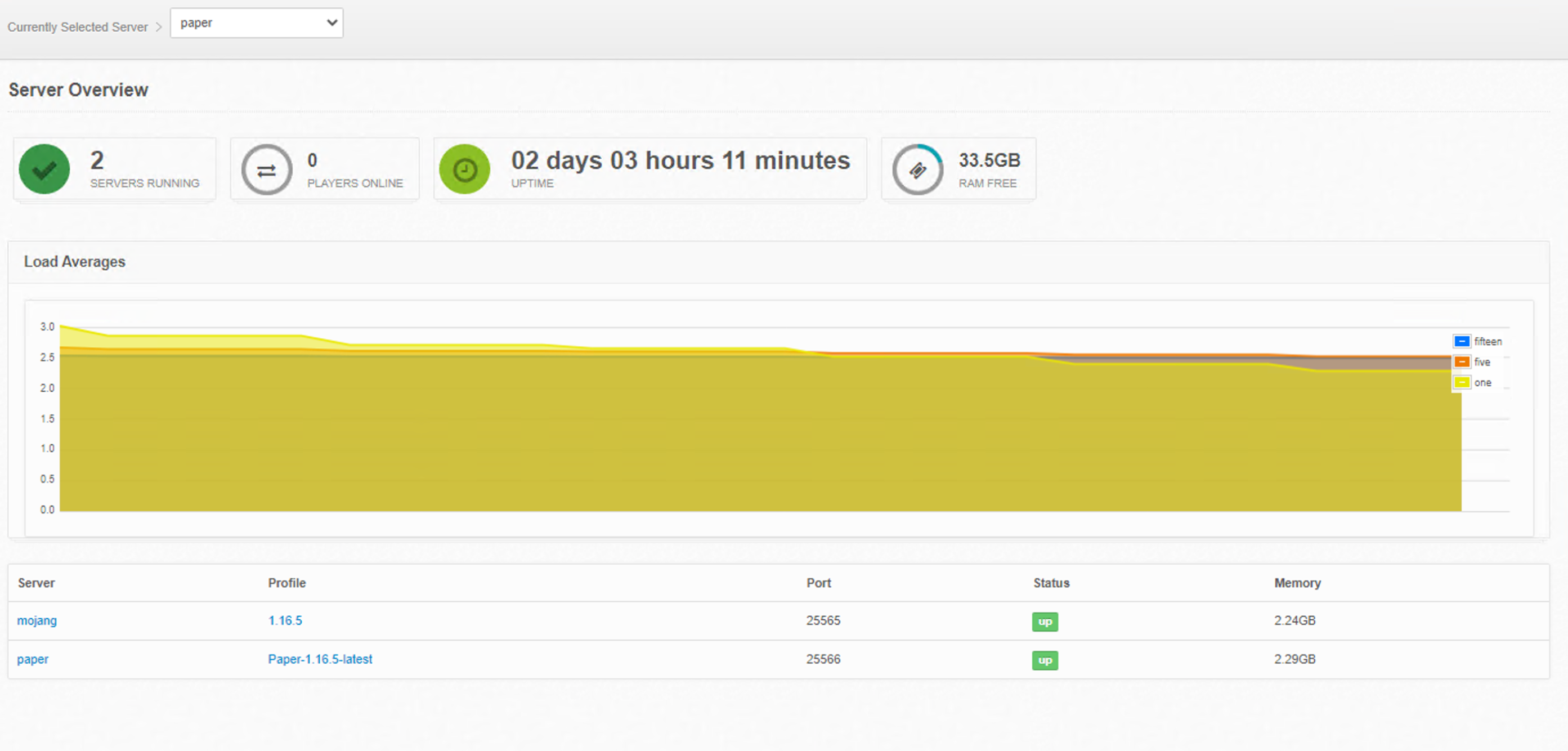

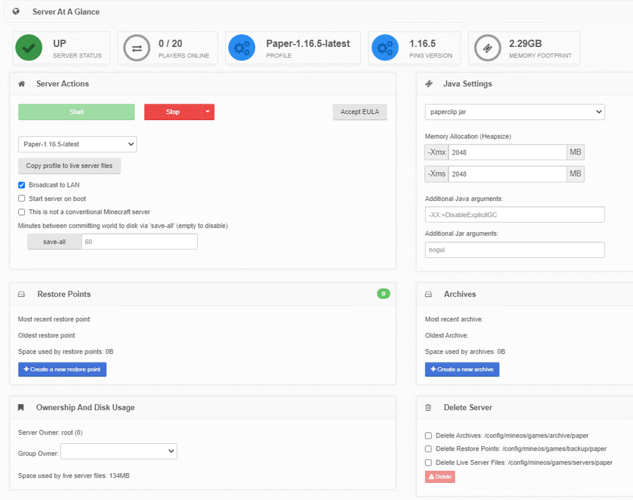

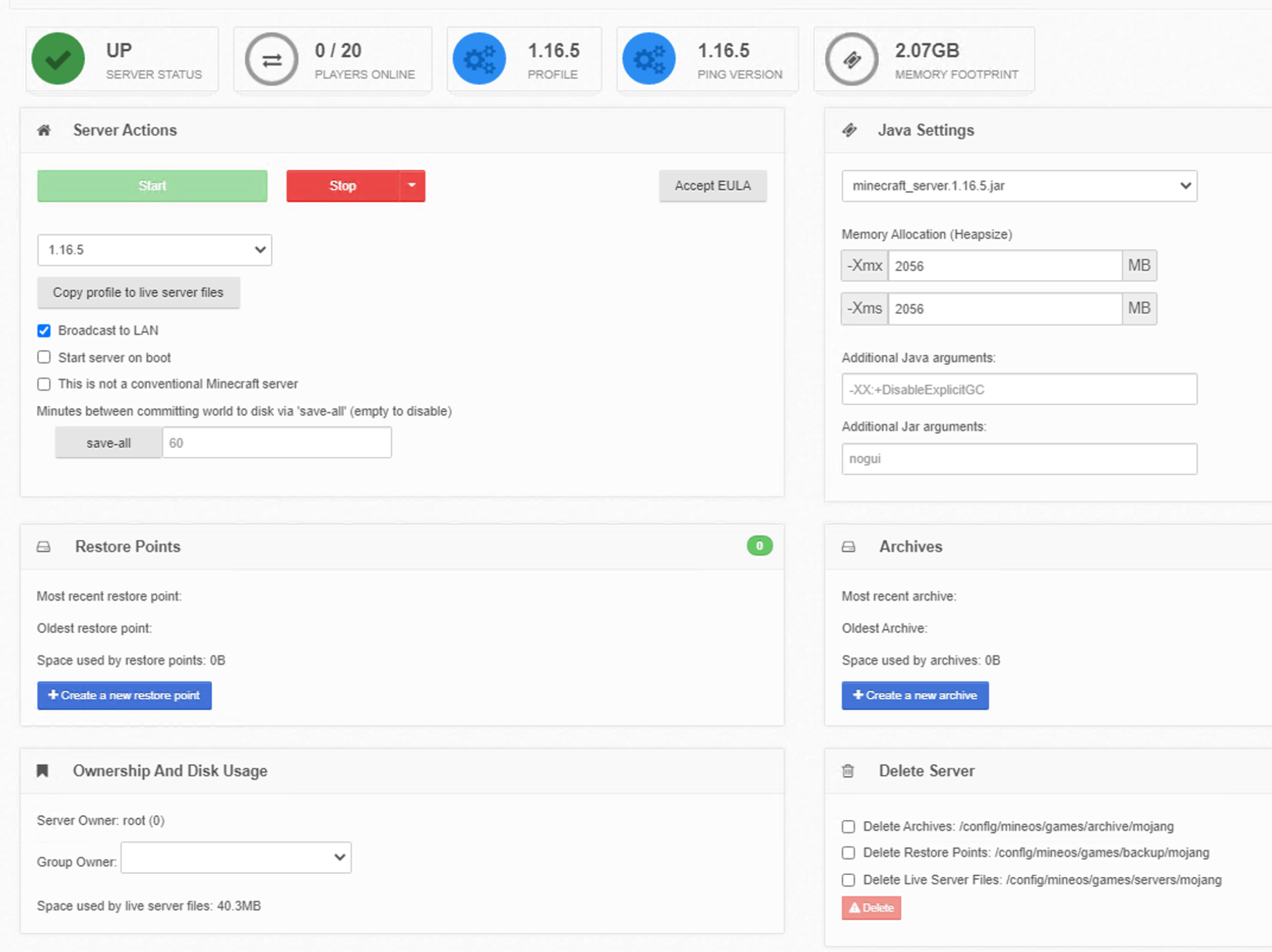

just created a brand new mojang and paper server, and no issues starting both:-
settings for paper:-
settings for mojang:-
