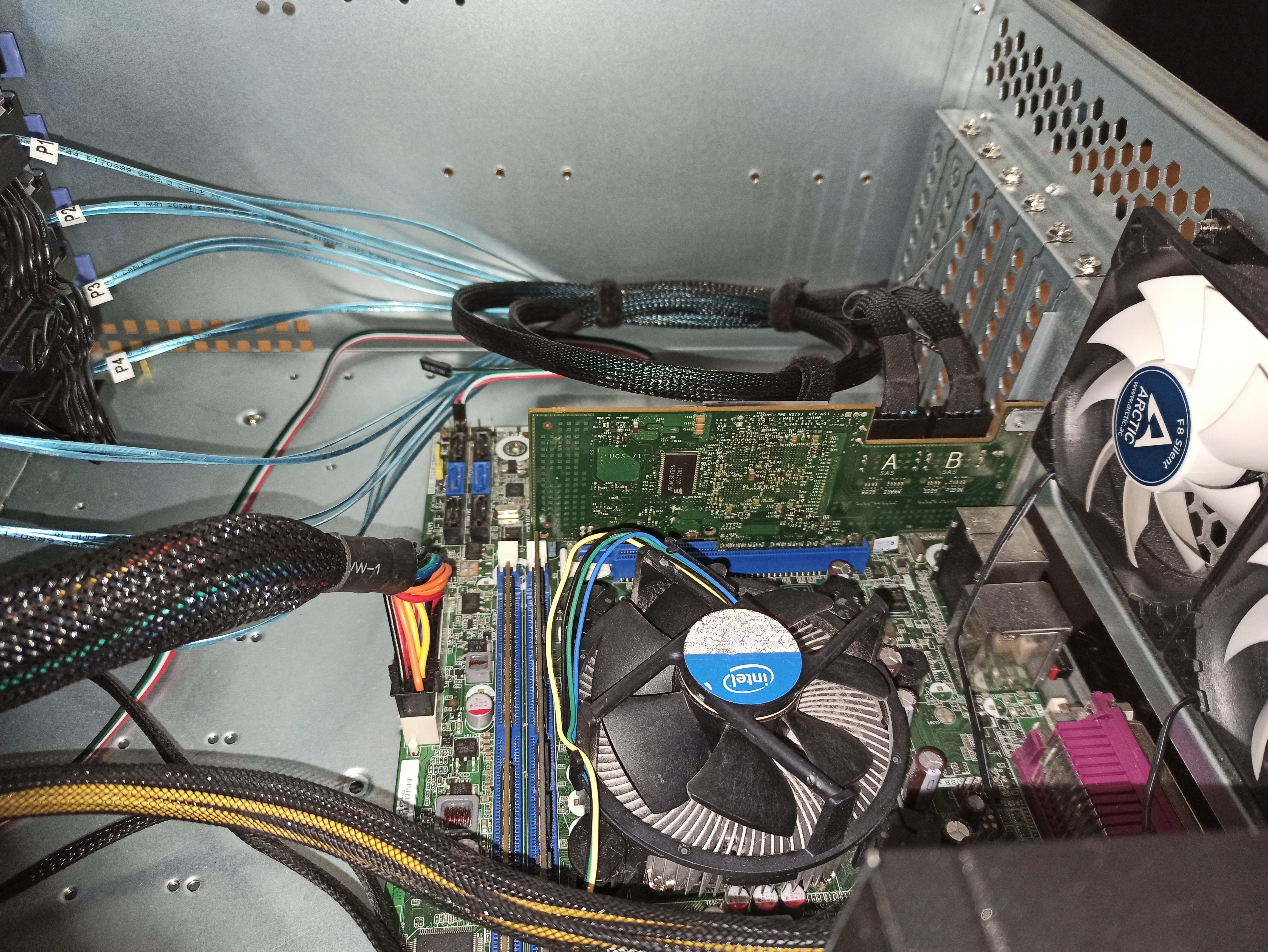

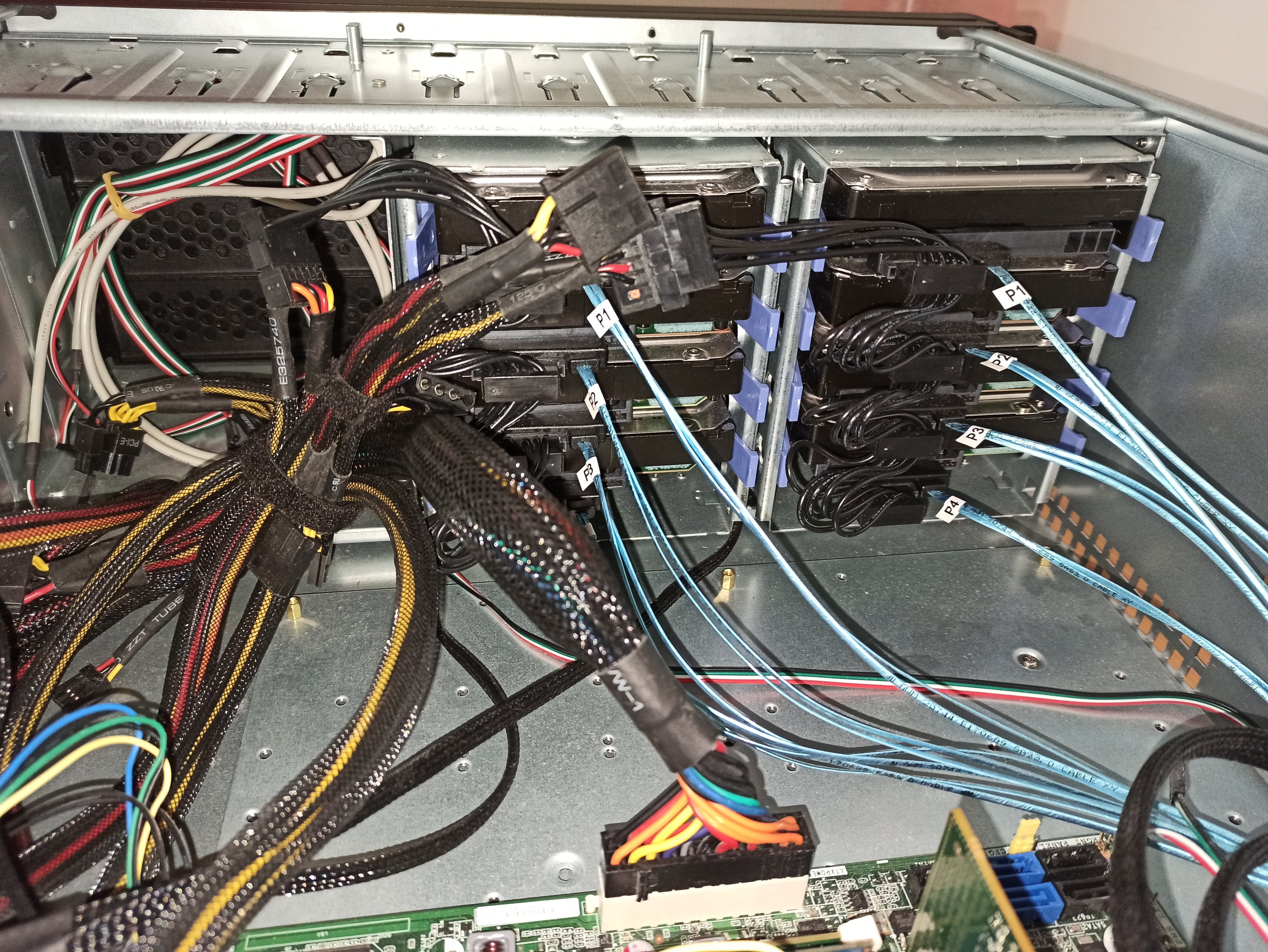

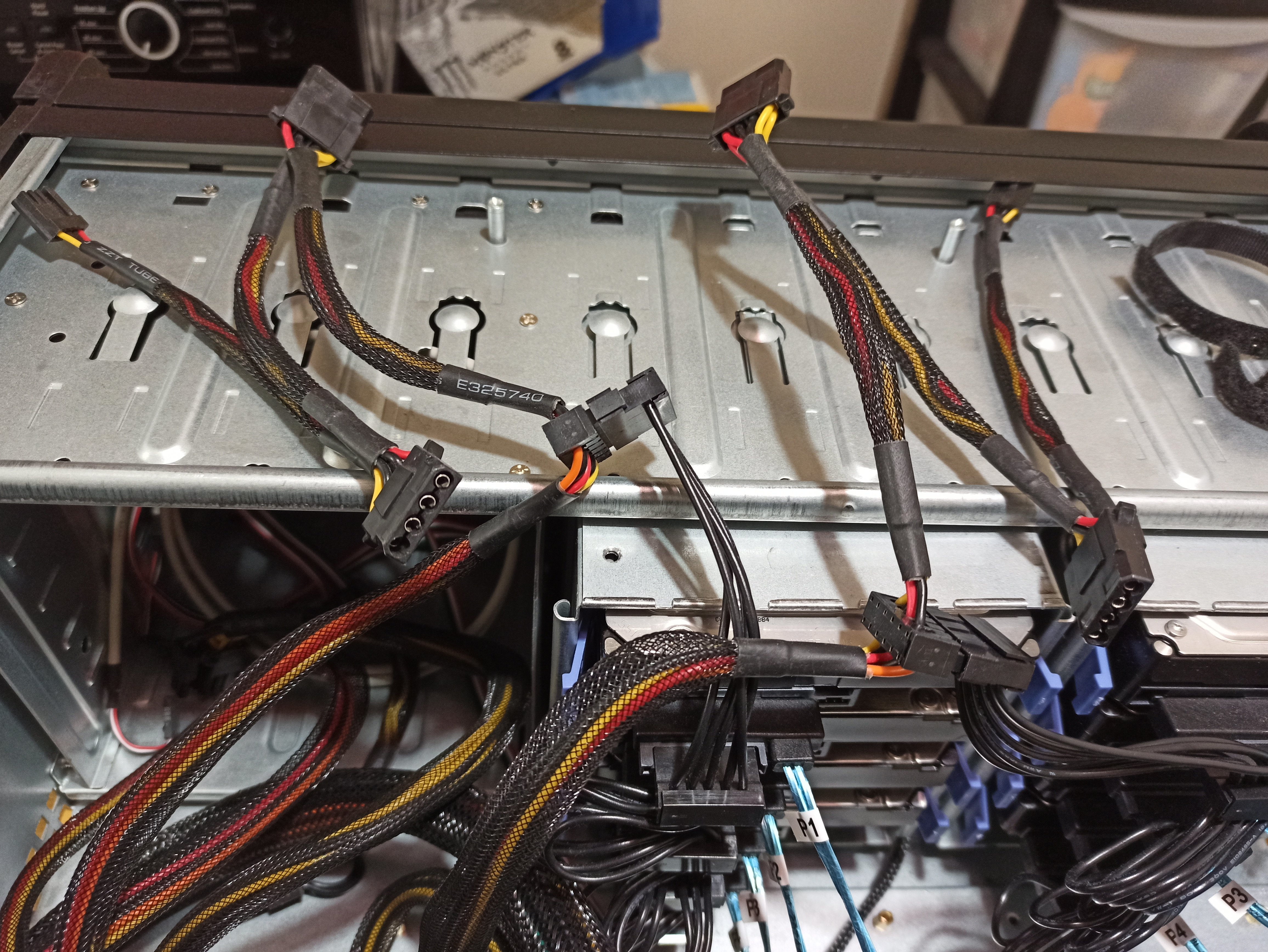

Added pictures of the setup to help
SATA power connectors really aren't rated to supply 4 drives simultaneously, I would source several 4 pin Molex -  SATA adapters instead, and use as many wires as possible from the PSU split across those drives.
How many 4 pin molex and how many SATA power are available on that PSU? I see at least 1 4 pin Molex, and from my experience there are probably 3 more. So, if you get (3) 4 pin Molex to dual SATA adapters you could run your drives from 5 sets of wires instead of 2.
Thanks Jonathanm,
I wasn't aware of this, do you think this is the likely cause?
Currently the PSU has 2 SATA/Molex feeds, each feed with 1xSATA, 2xMolex and 1xMini Molex (see picture)
Do you think this setup will help if I move from the SATAs to the Molex even though they're on the same feeds? Should I look into a new PSU with more individual Molex feeds?
SATA power connectors are rated for a max draw of 4.5 Amps per wire. You are subdividing that across 4 drives, so yes, it could be a possible issue. It's borderline at best.
4 Pin Molex are rated for 13 Amps per wire, so even if you have to split the load across 2 4 pin connectors on the same lead, it's still better.
Even just switching out your current adapters for a pair of 4 pin to 4ea SATA connectors would be an improvement, but the more you can split it up the better.
