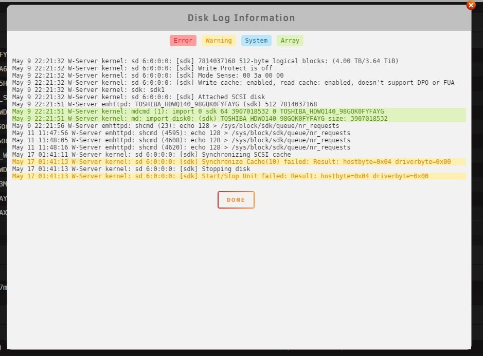

I couldn't find anything wrong with the cables, as far as I could see...  Here is the drive log as it shows me in the GUI - I'm going to reboot and see what happens....
3 hours ago, EternalFootman99 said:
So, I saw that drive was omitted from the SMART reports - So that's a hardware issue, not the fact that it has been disabled?
SMART for all attached disks should be in diagnostics. So it isn't responding.
The connectors should sit square on the connection with no tension in the cable that might disturb that square connection. And don't bundle SATA cables.
