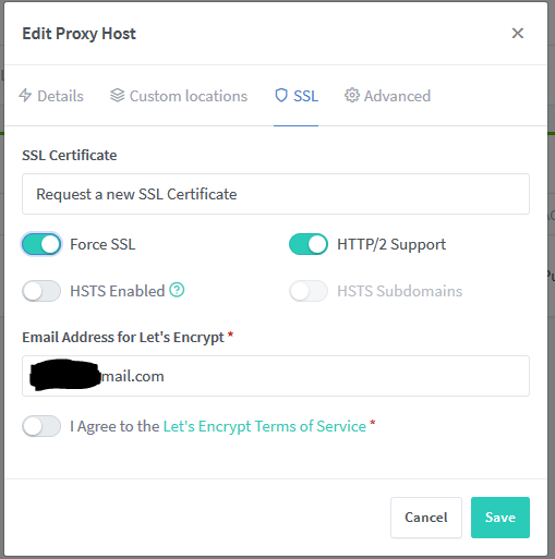

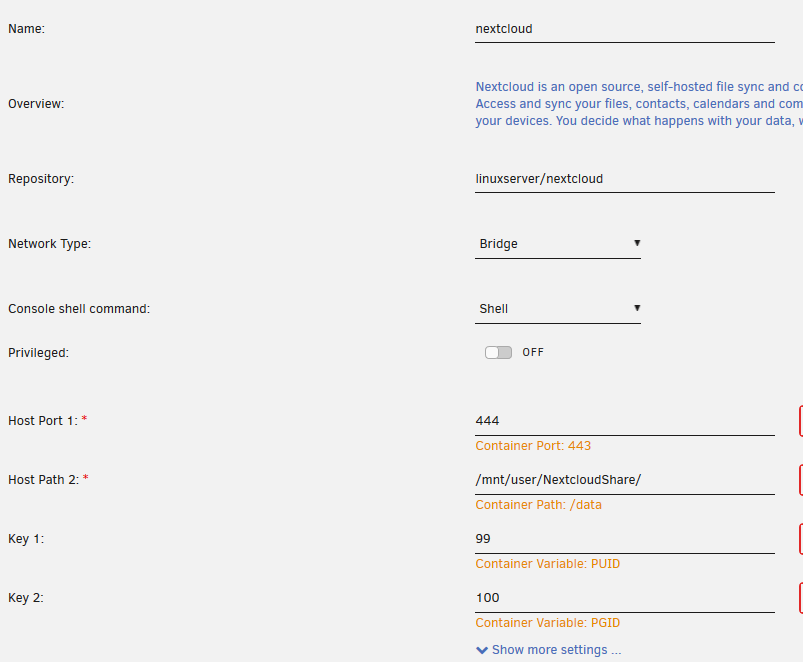

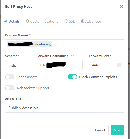

July 23, 20206 yr On 5/19/2020 at 4:42 AM, ljt said: OK so for anyone else having troubles I managed to fix it in a different way: 1) removed everything I did in the spaceinvader tutorial (configs, containers...) execpt the mariadb docker 2) Added the nextcloud docker and config it 3) Verified that nextcloud is working with local ip -> ok 4) add nginxproxymanager docker from jlesage 5) Add host in nginxproxymanager Make sure the ports for 80 and 443 are forwarded ( see spaceinvaderone tutorial) Nginxproxymanager needs that for the certificate. Nginxproxymanager is just click and go. Add correct IP and ports, set SSL to on and off you go. And make sure Nextcloud is not forwarding HTTP to HTTPS, it will give you an error. Nginxproxymanager is in charge of the https thing. In the config.php in Nextcloud I changed this: 'overwrite.cli.url' => 'https://cloud.domain.eu', INTO this: 'overwrite.cli.url' => 'http://cloud.domain.eu', This is what I have but not working... so far. I have port 80 forwarded to 180, and 443 to 1443. Any help please!
