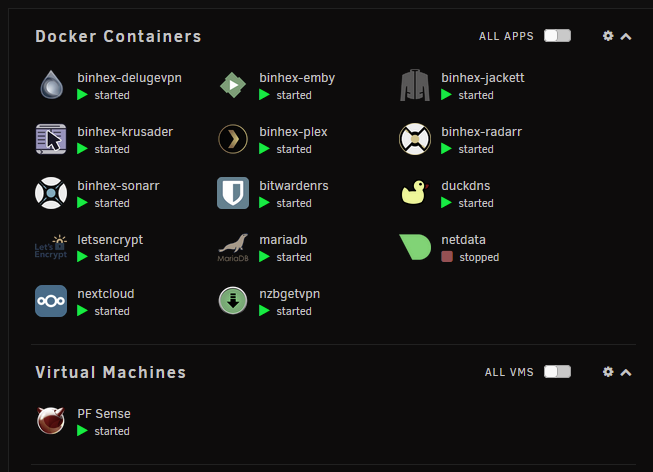

Equipment:
Dell R710 2U rackmount server
Onboard 4 port NIC
23 HT’s and 46G memory
Unraid server with various dockers such as Nextcloud, NZBGet, Sonarr and Bitwarden
Server is stable and functioning as expected.
PF Sense running on a VM using 2 of the 4 internal NIC's
It has been really stable for the past 6 to 8 weeks. No sign of trouble.

Well I have solved the issue - didn't happen last night.
I only changed a couple of things on the server and my network infrastructure - not sure what solved it.
This is what I did before the appointed hour:
1. Updated some backend software on the Unraid Server
2. I stopped my Netdata docker because of how it was running it was highly suspect.
3. I removed an old router from my infrastructure that has caused problems in the past: dropping internet unexpectedly; certain ports messed up access; the reason I moved to PF Sense as speeds were extremely slow over fibre internet (getting 50 mbps when I should be getting at least 500mbps); when used as main router it would glitch out regularly.
I think it is option 3 but not prepared to test it .....
