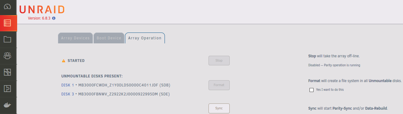

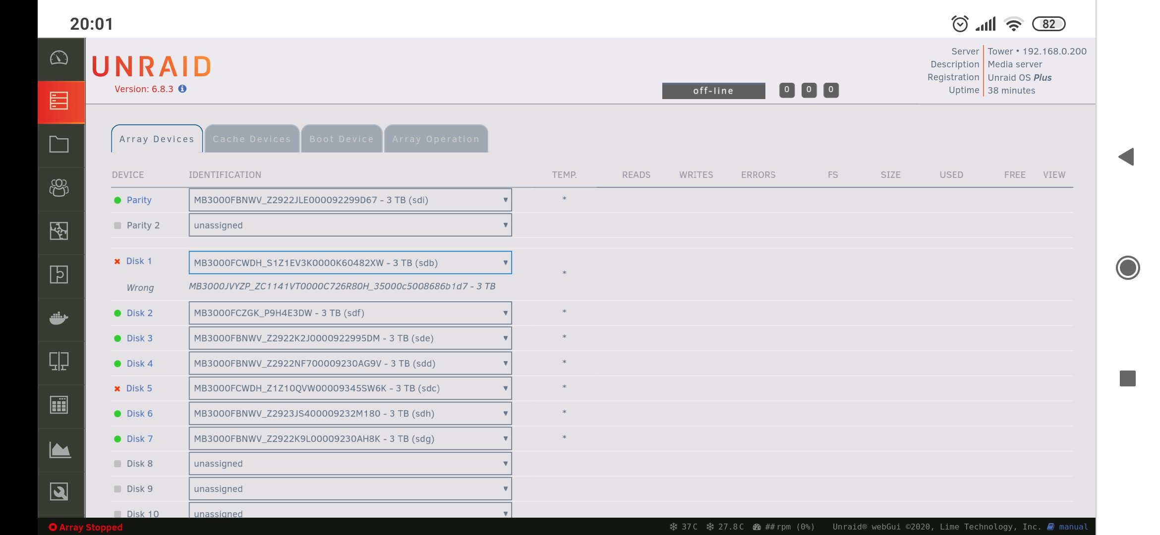

Hi, I've been having some issues with power I think so I decided to change out some SATA to 4 x SATA adapters for Molex to 4 x SATA adapters. Once booted I noticed my disks hadn't spun up as normal and once Unraid loaded there was no disks showing. I thought maybe they just didn't boot correctly through the HBA so shutdown and made sure the connections where all secure on the disks. Booted back up with all my disks and started the array, almost instantly 2 or 3 disks dropped out and caused errors so I stopped the rebuild, shutdown and attempted again after unassigning and reassigning the disks, failures again, done the same and now I have two disks showing as 'New Devices' under my Array Devices tab which I'm unable to assign to any disks under Unraid.
Have I completely messed my array or can this be saved? :(
You can do a new config, but if it was in the middle of a rebuild that disk might have some corruption, depending mainly for how long it continued with read errors on more disks, other option would be to force a rebuild of the that disk, did you save the diags before rebooting when the errors occurred?

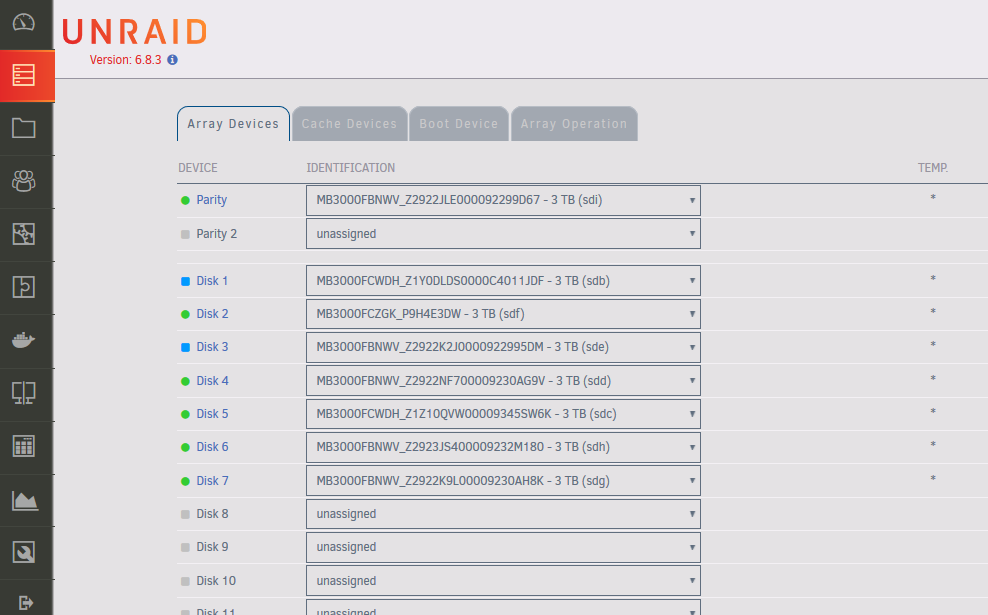

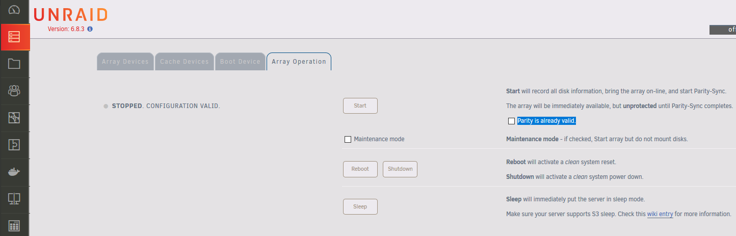

Thank you johnnie.black, I've just ran the New Config option and made sure all drives are assigned to the correct Unraid disks. Should I select the 'Parity is already valid.' option as I know the parity is valid or should I let Unraid do its thing?
Unfortunately I didn't save the diagnostics beforehand as I assumed it was just a possible cable issue and shutdown, checked and booted back up.
If you are reasonably certain that parity is valid you can check that option.   I would still recommend running a parity check to confirm it really is valid.

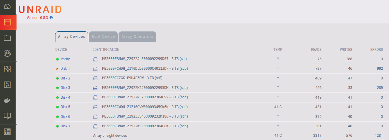

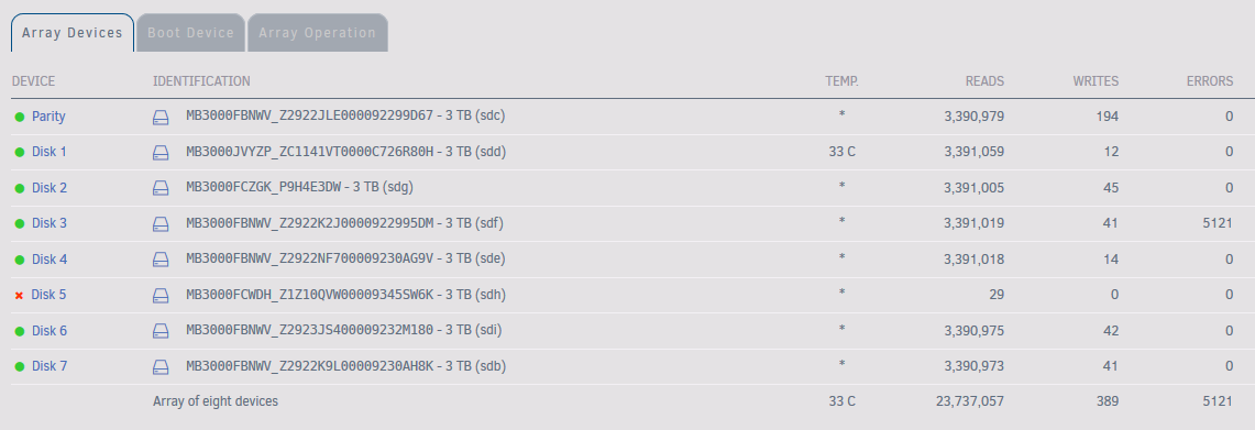

Ok so I just started the array again without checking the 'Parity is valid' option and having errors straight away again. The rebuild speed is also running at 4.6 GB/sec which I assume is majorly wrong?
Waiting on the server to 'collect diagnostic information' which is taking a little while, hopefully it can help thought... should I stop the rebuild or let it run?
Diagnostics attached and screenshot of drives with errors after array started and finished its rebuild in 8 minutes.
tower-diagnostics-20200519-1839.zip
Edited by jsN
Added screenshot
Errors on multiple disks suggest a cable/power problem, recheck all cables and/or use a new PSU if available.

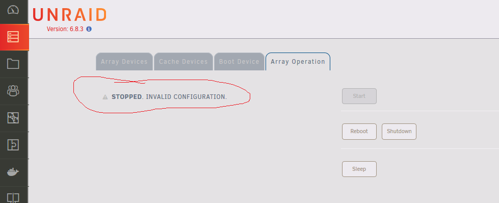

Thanks, just tried unmounting disk1, starting array, stopping, mounting disk1 and starting again and now I'm getting this issue, is this related?
tower-diagnostics-20200519-1913.zip
You first need to fix the problem, then reboot and redo the new config.
Never format anything.

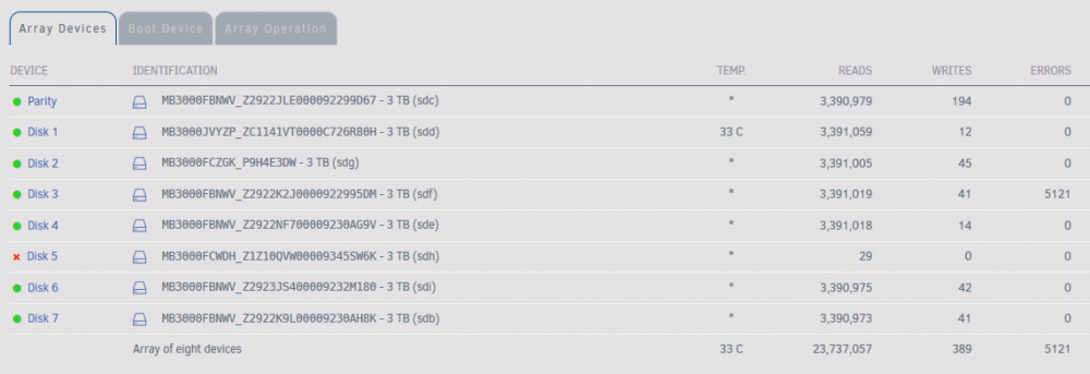

Hi all, so I've replaced my power cables and SAS cables but still having issues.
During a read-check it's still throwing out errors and I've also got disk5 that's unmountable. What should my next steps be for this? Should I replace disk5 with unmountable format with a new disk and rebuild the array or should I replace disk3 that's giving errors with a new disk and rebuild the array?
Should I replace my HBA and/or power supply?
Also I noticed when I start the system up sometimes 2-3 disks don't get detected, could this be a power issue? - this happened with old and new SAS cables and if I remember correctly they're sometimes from different HBA ports.

Don't mess with the disks/filesystem for now, not until the problem is fixed.
That would be my next step, start with the one easier/cheaper to replace/swap, then run another read check.

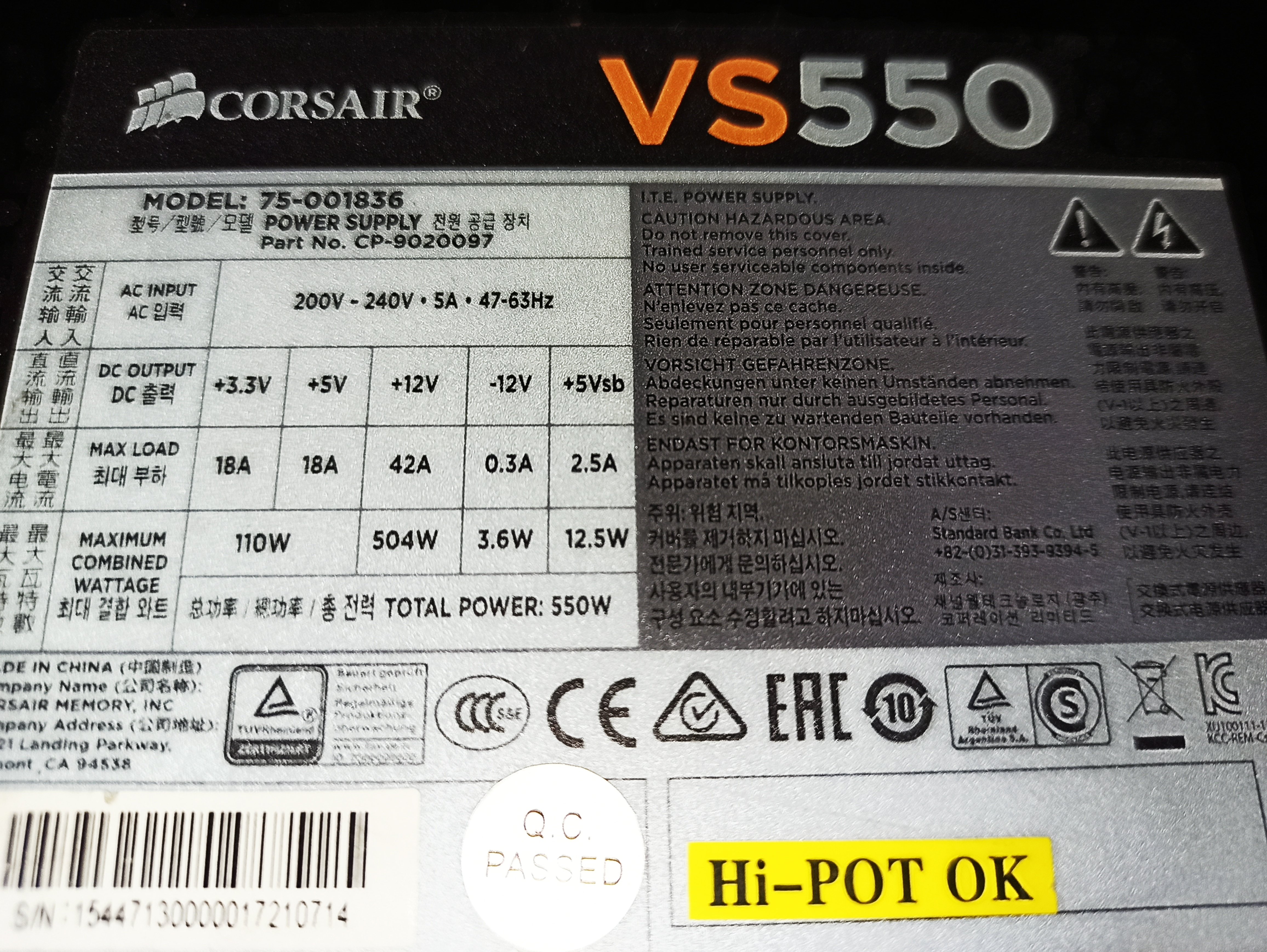

Needing some advice for new power supply just in case my current one doesn't have enough juice when all disks are at full load and causing my errors. My current power supply is Corsair VS550 with specs attached in image.

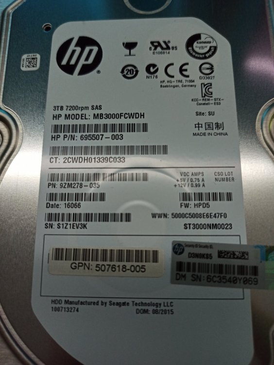

8 x HP MB3000FCWDH (3TB 6G SAS 7.2K 3.5in DP MDL SC HDD) - Future upgrade to 15x

Should the current spec power supply be enough for my needs or should I be looking for something with more amps on the 5/12v?
OK, the max inrush current for HD that I have ever seen quoted is 3A.  So the eight drives you have would require 288W of power on spin-up.  Your PS is rated at 550W TOTAL!  That means you can't exceed that rating for as long as a millisecond or bad things will start to happen.   (Look again at that spec power picture you posted and observe that the sum of the individual max's exceed the total rating.  A classic example of specmanship!)
Don't rule out a power supply problem--- particularly when a lot of unexplained things are going on.  Personally, I would be looking at the PS, the PS +12V cabling and the SATA data cabling.  Loose SATA data cables can be a real headache in many servers.  Using Locking SATA cables can have this problem:
