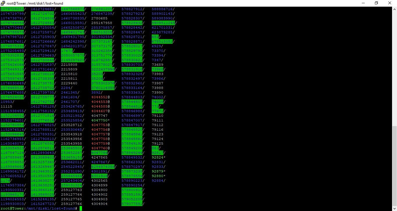

Thank you very much for this! Done the validslot command and rebuilt the array which seems to have sorted my remaining issues. I haven't yet ran the file system check because my unmountable disk is back online, should I do this just in case?
tower-diagnostics-20200530-1016.zip
You need to run a filesystem check on disk1.
Thanks, I've ran the file system check hopefully it looks healthy?

bad hash table for directory inode 1612739777 (no data entry): would rebuild
entry "localhost" in shortform directory 1612739837 references non-existent inode 114160
would junk entry
entry "f" in shortform directory 1612739988 references non-existent inode 114206
would junk entry
entry "a" in shortform directory 1612739988 references non-existent inode 114853
would junk entry
entry "9" in shortform directory 1612739988 references non-existent inode 114878
would junk entry
entry "Contents" in shortform directory 1612739992 references non-existent inode 114821
would junk entry
entry "cdd1021723e187b56f6c423c298b2579d21b949.bundle" in directory inode 1612742795 points to non-existent inode 112988, would junk entry
bad hash table for directory inode 1612742795 (no data entry): would rebuild
entry "com.plexapp.agents.localmedia" in shortform directory 1612753191 references non-existent inode 114865
would junk entry
entry "com.plexapp.agents.localmedia" in shortform directory 1612760215 references non-existent inode 112948
would junk entry
entry "com.plexapp.agents.plexthememusic" in shortform directory 1612768949 references non-existent inode 112969
would junk entry
entry "Thumbnails" in shortform directory 1612768973 references non-existent inode 114827
would junk entry
entry "art" in shortform directory 1612776708 references non-existent inode 112958
would junk entry
entry "Contents" in shortform directory 1612776721 references non-existent inode 112965
would junk entry
entry "art" in shortform directory 1612788811 references non-existent inode 112974
would junk entry
entry "art" in shortform directory 1613703819 references non-existent inode 114145
would junk entry
entry "com.plexapp.agents.opensubtitles" in shortform directory 1615267725 references non-existent inode 112990
would junk entry
entry "com.plexapp.agents.thetvdb" in shortform directory 1701534450 references non-existent inode 112952
would junk entry
entry ".." in directory inode 2080057875 points to non-existent inode 114160, would junk entry
bad hash table for directory inode 2080057875 (no data entry): would rebuild
        - traversal finished ...
        - moving disconnected inodes to lost+found ...
disconnected dir inode 651, would move to lost+found
disconnected dir inode 771, would move to lost+found
disconnected dir inode 861, would move to lost+found
disconnected dir inode 1174, would move to lost+found
disconnected dir inode 2284, would move to lost+found
disconnected dir inode 3892, would move to lost+found
disconnected dir inode 4636, would move to lost+found
disconnected dir inode 6929, would move to lost+found
disconnected dir inode 7347, would move to lost+found
disconnected dir inode 10546, would move to lost+found
disconnected dir inode 10953, would move to lost+found
disconnected inode 11115, would move to lost+found
disconnected dir inode 13800, would move to lost+found
disconnected dir inode 17670, would move to lost+found
disconnected dir inode 35203, would move to lost+found
disconnected dir inode 35206, would move to lost+found
disconnected dir inode 50595, would move to lost+found
disconnected dir inode 73370, would move to lost+found
disconnected dir inode 73394, would move to lost+found
disconnected inode 73689, would move to lost+found
disconnected dir inode 73968, would move to lost+found
disconnected inode 73983, would move to lost+found
disconnected dir inode 73986, would move to lost+found
disconnected inode 73987, would move to lost+found
disconnected inode 73988, would move to lost+found
disconnected inode 73990, would move to lost+found
disconnected dir inode 74002, would move to lost+found
disconnected dir inode 74008, would move to lost+found
disconnected dir inode 77471, would move to lost+found
disconnected inode 79110, would move to lost+found
disconnected inode 79111, would move to lost+found
disconnected inode 79112, would move to lost+found
disconnected inode 79116, would move to lost+found
disconnected inode 79123, would move to lost+found
disconnected inode 79124, would move to lost+found
disconnected inode 79125, would move to lost+found
disconnected dir inode 92817, would move to lost+found
disconnected inode 92824, would move to lost+found
disconnected dir inode 92831, would move to lost+found
disconnected dir inode 92833, would move to lost+found
disconnected inode 92879, would move to lost+found
disconnected inode 92880, would move to lost+found
disconnected dir inode 92884, would move to lost+found
disconnected inode 2215808, would move to lost+found
disconnected inode 2215809, would move to lost+found
disconnected inode 2215810, would move to lost+found
disconnected inode 2215811, would move to lost+found
disconnected inode 2229440, would move to lost+found
disconnected dir inode 2461345, would move to lost+found
disconnected dir inode 2461604, would move to lost+found
disconnected dir inode 2461707, would move to lost+found
disconnected inode 2611915, would move to lost+found
disconnected inode 2616794, would move to lost+found
disconnected inode 2616796, would move to lost+found
disconnected inode 2616797, would move to lost+found
disconnected inode 2616798, would move to lost+found
disconnected inode 2616799, would move to lost+found
disconnected inode 2616800, would move to lost+found
disconnected inode 2616801, would move to lost+found
disconnected dir inode 2648781, would move to lost+found
disconnected dir inode 2655787, would move to lost+found
disconnected inode 2780685, would move to lost+found
disconnected inode 4044552, would move to lost+found
disconnected inode 4044553, would move to lost+found
disconnected inode 4044585, would move to lost+found
disconnected inode 4044607, would move to lost+found
disconnected inode 4047747, would move to lost+found
disconnected inode 4047750, would move to lost+found
disconnected inode 4047753, would move to lost+found
disconnected inode 4047756, would move to lost+found
disconnected inode 4047757, would move to lost+found
disconnected inode 4047758, would move to lost+found
disconnected inode 4047759, would move to lost+found
disconnected inode 4047760, would move to lost+found
disconnected dir inode 4047784, would move to lost+found
disconnected inode 4247865, would move to lost+found
disconnected dir inode 4247867, would move to lost+found
disconnected dir inode 4301891, would move to lost+found
disconnected dir inode 4301916, would move to lost+found
disconnected inode 4302565, would move to lost+found
disconnected inode 4304899, would move to lost+found
disconnected inode 4304900, would move to lost+found
disconnected inode 4304902, would move to lost+found
disconnected inode 4304903, would move to lost+found
disconnected inode 4304904, would move to lost+found
disconnected inode 4307944, would move to lost+found
disconnected dir inode 4307970, would move to lost+found
disconnected inode 4428427, would move to lost+found
disconnected inode 15847651, would move to lost+found
disconnected inode 15847652, would move to lost+found
disconnected inode 16228006, would move to lost+found
disconnected dir inode 253426765, would move to lost+found
disconnected dir inode 253469419, would move to lost+found
disconnected dir inode 253521952, would move to lost+found
disconnected dir inode 253525854, would move to lost+found
disconnected inode 253528712, would move to lost+found
disconnected dir inode 253530645, would move to lost+found
disconnected inode 253543918, would move to lost+found
disconnected inode 253543956, would move to lost+found
disconnected inode 253543958, would move to lost+found
disconnected dir inode 253645802, would move to lost+found
disconnected dir inode 253652267, would move to lost+found
disconnected dir inode 253659153, would move to lost+found
disconnected dir inode 253662011, would move to lost+found
disconnected dir inode 254522845, would move to lost+found
disconnected dir inode 255231090, would move to lost+found
disconnected dir inode 255645466, would move to lost+found
disconnected dir inode 257243404, would move to lost+found
disconnected dir inode 259031324, would move to lost+found
disconnected inode 259127763, would move to lost+found
disconnected inode 259127764, would move to lost+found
disconnected inode 259127765, would move to lost+found
disconnected inode 259127766, would move to lost+found
disconnected inode 259127767, would move to lost+found
disconnected inode 259127768, would move to lost+found
disconnected inode 264401826, would move to lost+found
disconnected inode 264401827, would move to lost+found
disconnected inode 264401828, would move to lost+found
disconnected inode 264401829, would move to lost+found
disconnected inode 264401830, would move to lost+found
disconnected inode 264401872, would move to lost+found
disconnected inode 264401873, would move to lost+found
disconnected inode 264401876, would move to lost+found
disconnected inode 264401877, would move to lost+found
disconnected inode 264401878, would move to lost+found
disconnected inode 264401879, would move to lost+found
disconnected inode 264401880, would move to lost+found
disconnected inode 264401881, would move to lost+found
disconnected inode 264458977, would move to lost+found
disconnected inode 264458978, would move to lost+found
disconnected dir inode 264458979, would move to lost+found
disconnected inode 264458996, would move to lost+found
disconnected dir inode 276589635, would move to lost+found
disconnected dir inode 276592728, would move to lost+found
disconnected dir inode 276841170, would move to lost+found
disconnected dir inode 276841208, would move to lost+found
disconnected dir inode 276847239, would move to lost+found
disconnected inode 285147958, would move to lost+found
disconnected dir inode 285375857, would move to lost+found
disconnected dir inode 296513208, would move to lost+found
disconnected dir inode 301932554, would move to lost+found
disconnected dir inode 307373167, would move to lost+found
disconnected dir inode 307373172, would move to lost+found
disconnected dir inode 310242356, would move to lost+found
disconnected dir inode 313751776, would move to lost+found
disconnected dir inode 316742987, would move to lost+found
disconnected dir inode 318578027, would move to lost+found
disconnected dir inode 578814564, would move to lost+found
disconnected dir inode 578814567, would move to lost+found
disconnected dir inode 578814616, would move to lost+found
disconnected dir inode 578814618, would move to lost+found
disconnected dir inode 578814619, would move to lost+found
disconnected dir inode 578814620, would move to lost+found
disconnected dir inode 578814750, would move to lost+found
disconnected dir inode 578815232, would move to lost+found
disconnected dir inode 578815554, would move to lost+found
disconnected dir inode 578816531, would move to lost+found
disconnected dir inode 578816542, would move to lost+found
disconnected dir inode 578817472, would move to lost+found
disconnected dir inode 578818452, would move to lost+found
disconnected dir inode 578818457, would move to lost+found
disconnected dir inode 578818820, would move to lost+found
disconnected dir inode 578820361, would move to lost+found
disconnected dir inode 578820398, would move to lost+found
disconnected dir inode 578822753, would move to lost+found
disconnected dir inode 578822764, would move to lost+found
disconnected dir inode 578822828, would move to lost+found
disconnected dir inode 578825902, would move to lost+found
disconnected dir inode 578825985, would move to lost+found
disconnected dir inode 578826290, would move to lost+found
disconnected dir inode 578826620, would move to lost+found
disconnected dir inode 578826622, would move to lost+found
disconnected dir inode 578826623, would move to lost+found
disconnected dir inode 578826624, would move to lost+found
disconnected dir inode 578827912, would move to lost+found
disconnected dir inode 578827923, would move to lost+found
disconnected dir inode 578828307, would move to lost+found
disconnected dir inode 578828432, would move to lost+found
disconnected dir inode 578828442, would move to lost+found
disconnected dir inode 578828447, would move to lost+found
disconnected dir inode 578828721, would move to lost+found
disconnected dir inode 578828871, would move to lost+found
disconnected dir inode 578829017, would move to lost+found
disconnected dir inode 578829792, would move to lost+found
disconnected dir inode 578830026, would move to lost+found
disconnected dir inode 578830621, would move to lost+found
disconnected dir inode 578830703, would move to lost+found
disconnected dir inode 578831916, would move to lost+found
disconnected dir inode 578832328, would move to lost+found
disconnected dir inode 578832497, would move to lost+found
disconnected dir inode 578832960, would move to lost+found
disconnected dir inode 578833164, would move to lost+found
disconnected dir inode 578833631, would move to lost+found
disconnected dir inode 578844803, would move to lost+found
Not really, though not always easy to tell by the xfs_repair output, you need to run it again without -n or nothing will be done, after it's done check lost+found folder for any lost files.
Ok so I've ran the filesystem check without parameters (attached output in txt document this time) and checked the lost+found folder which contains lots of things. What should I do next, is the filesystem okay? Do I need to do anything with these lost+found files?unraid07.thumb.png.aa314f21b506e13a4c5c93cfbed99ba1.png
filesystemcheck-disk1.txt
Filesystem should be fine now, those files are the result of fixing the corruption, there might be something important there, there might not, not always easy so see what they are.
Figuring out what any of those are may not be worth the trouble. Do you have backups of anything important and irreplaceable?
If I read what you are trying to determine with these two questions is what is the state of the hard drive and the data stored on it?
@johnnie.black has said that the file system has been repaired and the disk itself will function properly.  This is true.  Everything looks fine.  However, as @trurl, indicated the files themselves may not so.
Think of it like a really big, big stack of file folders sitting on top of your desk.  Suddenly, this pile gets pushed off on the floor!   Folders go everywhere and some of the papers come out of their folder.  You go to carefully pick them up and push the papers back into the proper folder as much as possible.  But when you get done, you have some empty folders and some (to a lot of) papers left over.  Now if you want to put those papers back where they belong, you are going to have to look every carefully at each paper to determine to which folder it belongs.
You have to decide what to do with the file fragments that are in the lost+found folder.  They may be complete files or some portions of a much larger file.  Their current names have nothing to do with the original file name and there are no extensions to give any help.  If you lost something really, really important, you might want to go looking for it but it is not a trivial task.
I, personally, have just trashed them in the past and moved on.
Edited by Frank1940
Luckily anything important is on cold storage also, the majority of things on here are not so important :)
Thank you for the explaination, very clear what they are now. Think I'll just keep them for a few months and if I realise I'm missing something important then go looking, if not delete :)
Thank you everyone who's helped here, I greatly appreciate the help!
