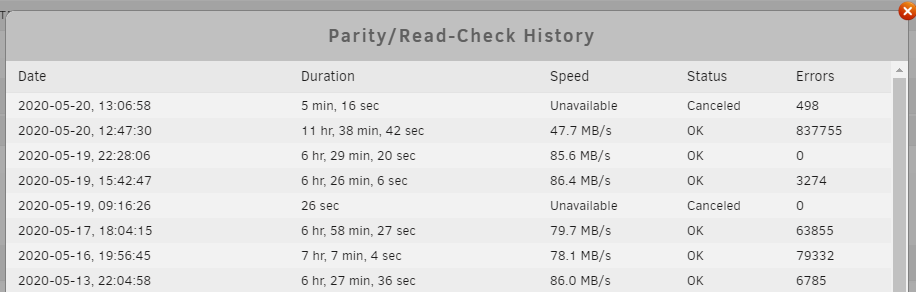

May 19, 20206 yr I've posted about this before and thought I had it solved. Every time I run a parity check, I have parity errors. It seems like the longer I go between checks the more errors I have, but nonetheless I have at least 6K - 90K errors every time. At this point I have checked the cabling, run Memtest86 about 4 different times (both in parallel and serial across all CPU cores), and run SMART tests on the drives. No errors are detected in any of my testing. I feel like I must have a bad drive. When I set up this server 2 months ago, I was a n00b and didn't preclear at all. Should I break apart my config, start over, and preclear all the drives / run extended SMART tests? Are there any other tests I could run at this point? I have my data backed up on other devices so I purge my unraid instance at this point if I need to. I'm running 3x 2TB drives running xfs.

May 20, 20206 yr Author 22 hours ago, johnnie.black said: Post diags after at least two parity checks with errors (without rebooting). Yea I don't think I can get two without errors. There are always errors, that's my point. homeserve-diagnostics-20200520-1308.zip
