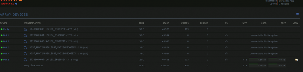

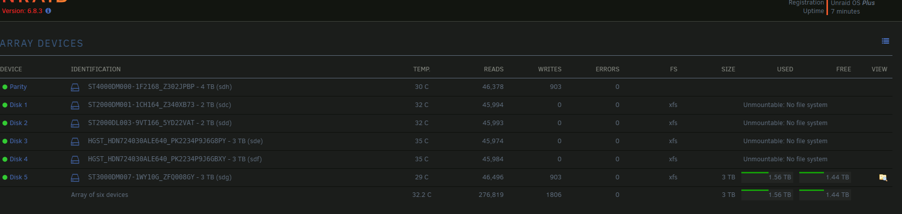

Then after i started NAS (QNAP 459 Pro II Board - QNAP 659 Case ) and the array looks like this - unmountable file system :( . At the moment it´s doing a parity check.
all drives are visible if i click on them and the disks are spinning.
I know one drive got some bad sectors but that many disks not working?

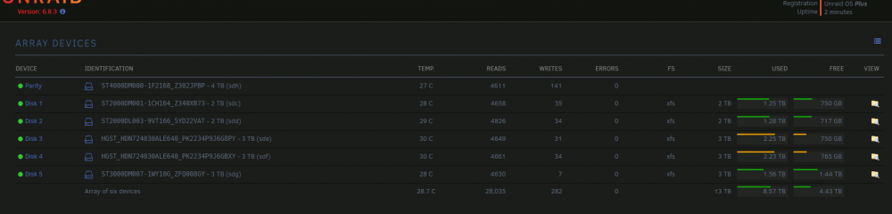

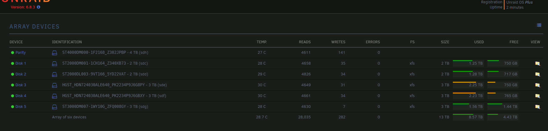

Okay now the Webui and everything is available again, also the capacitys are shown fine. (cant access main and dashboard no more, see below)
and the whole docker things are gone :(

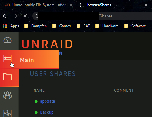

Now the behaviour is odd, i can browse every section on the left, except for Dashboard and Main. The circle on my chrome spins and spins. But the parity check on the bottom line is keep going and going. After 5 mins or so the /Dashboard pops up but only the grey background.
